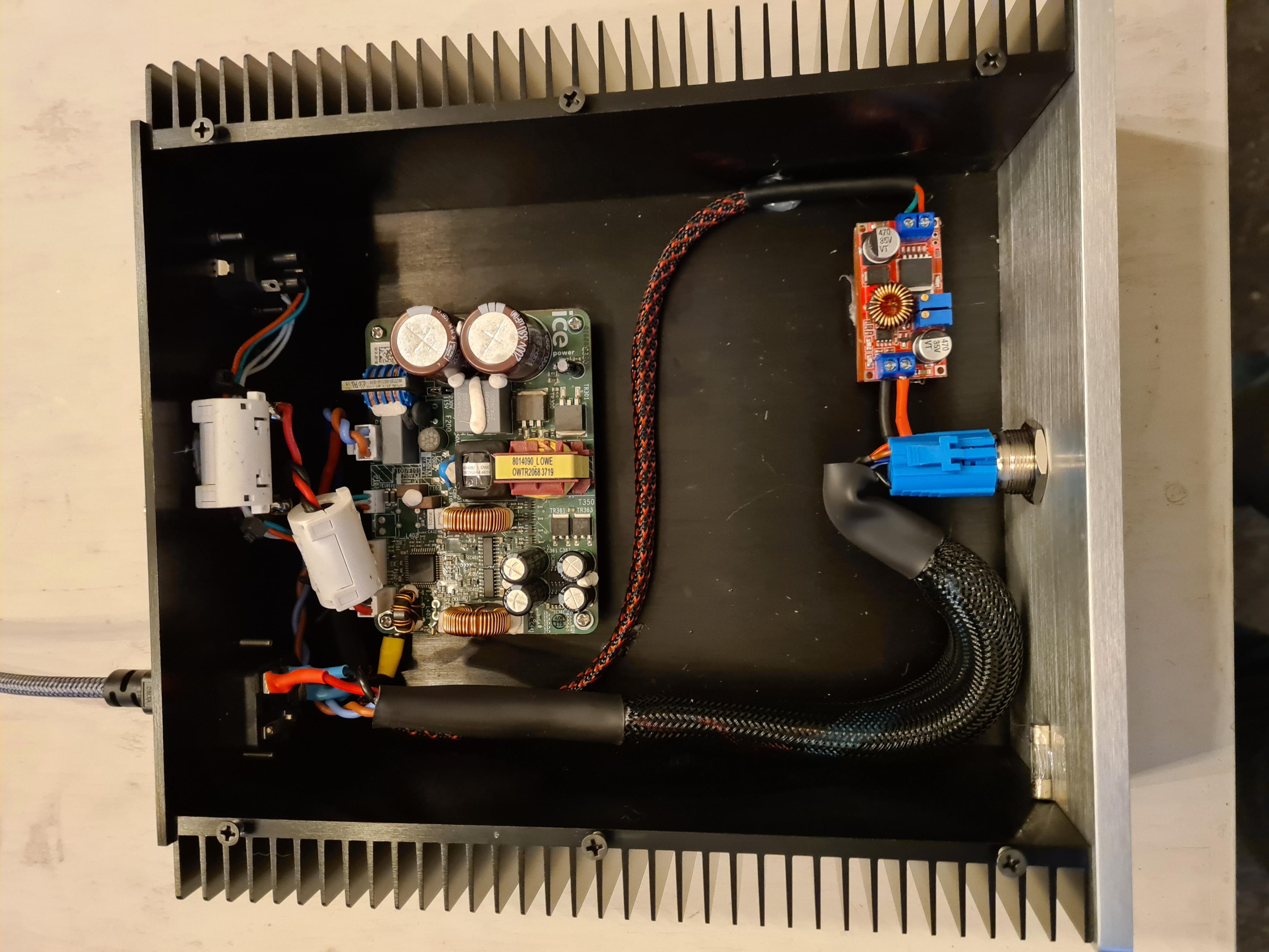

Well I finally got the first amp together and the LED wired up...I purchased a DV power supply and used a Fluke Multimeter to measure the voltage with and without the Buck down board. I brought the voltage down tonthe spec for the LED and ussd a 10k resistor.
Very nice construction! Easy to see why it took some time to complete!
By 'brought the voltage down to the spec for the LED', do you mean the LED's rated forward voltage? If so, the 10k series resistor likely won't provide enough current to make the LED very bright.
Maybe consider setting the voltage 0,2 or 0,3V higher. Then swap out the 10k resistor for one that's 39, 47, or 56 ohms.
But only if the power LED is too dim as it is.😉
Cheers
Cheers
Thanks, the LED brightness is pretty good right now (just a little dimmer and I will be happy.. I will look at the specs from Parts Express on the LEDs again. As I recall it was saying continuous was 3 to 3.5v. The buck down convertor I am using also has a current adjustment, but I do not know how to measure current. I know when I was testing with my DC Power supply...I was able to dim the LED a lot, but when I hooked the LED to the aux out it was brighter. I will hook it up directly to the DC Power supply and dial it down again and then swap it in again.Very nice construction! Easy to see why it took some time to complete!

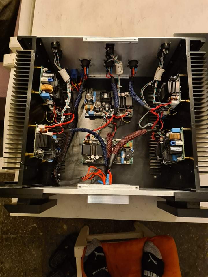

Here is my 125asx 6 channel amp...I made it as clean as I could, but it is not as nice as the the single amp module one.
