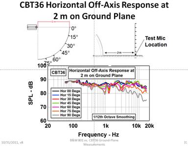

Yes, it was. You cannot read that from the pdf file however. Se comments from Don Keele below. Maybe that clear things up a bit. 🙂"Uneven floor"? The floor shown in the linked PDF is not uneven at all!
The slide shows responses measured with the test mic on the floor. The 90° curve rolls off above 5 kHz because of roughness of the concrete floor in our shop. Measured over a shiny tile floor it’s essentially flat!
We are soon going to be measuring an additional set of CBT36 measurements of the response vs. height (0 to 2.5 m, step 0.5 m) at several off-axis horizontal angles (0 to 90°, step 15°). This will included with the B&W vs CBT36 measurements. We will measure this set over a good floor however!

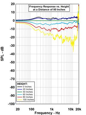

In lieu of these measurements, the attached CBT36 simulations show essentially the same thing but simulated at several distances from the base of the array at 0.5, 1, 2, 3, 10, and 250 m. The simulations of course do not include box diffraction effects. Note that the aspect ratio of all graphs is 25 dB/decade.
Here’s the graph at 2 m from the base of the array and 75° off-axis horizontal:
The red curve is at a height of 2 m which is 0.5 m above the top of the array (array is 1.5 m tall) and is fully 10 dB below the 1 m listening height level! All curves are normalized to the response at 1 m high (green response curve) at that specific angle. Note that the level increases towards the floor (black, blue curves) but dramatically decreases as you go up (blue, red, and yellow curves).

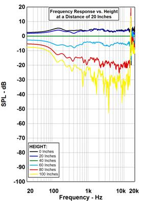

Here’s the corresponding 75° curves, but much closer to the array at 0.5 m. Note that the 1.5 m level at the top of the array (blue) is 6 - 7 dB below the level at the listening height of 1 m. At a point igher at 0.5 m above the top of the array (red), the level is down some 15 to 20 dB but still fairly flat!
So what’s the conclusion? Yes the CBT36 does illuminate the walls, but with essentially a spectrum that is quite flat and that decreases considerably with height at distances particularly close to the array.
The behavior of the CBT36 over the ground is completely unique and is dramatically different and extraordinarily better than any speaker that has come before!! Just repeat the same set of over-the-floor measurements on any other manufacturer’s speaker and you will find out!

pardon me but what a floor type has to do with horizontal dispersion? it's horizontal dispersion of CBT that is so to speak deeply flawed
