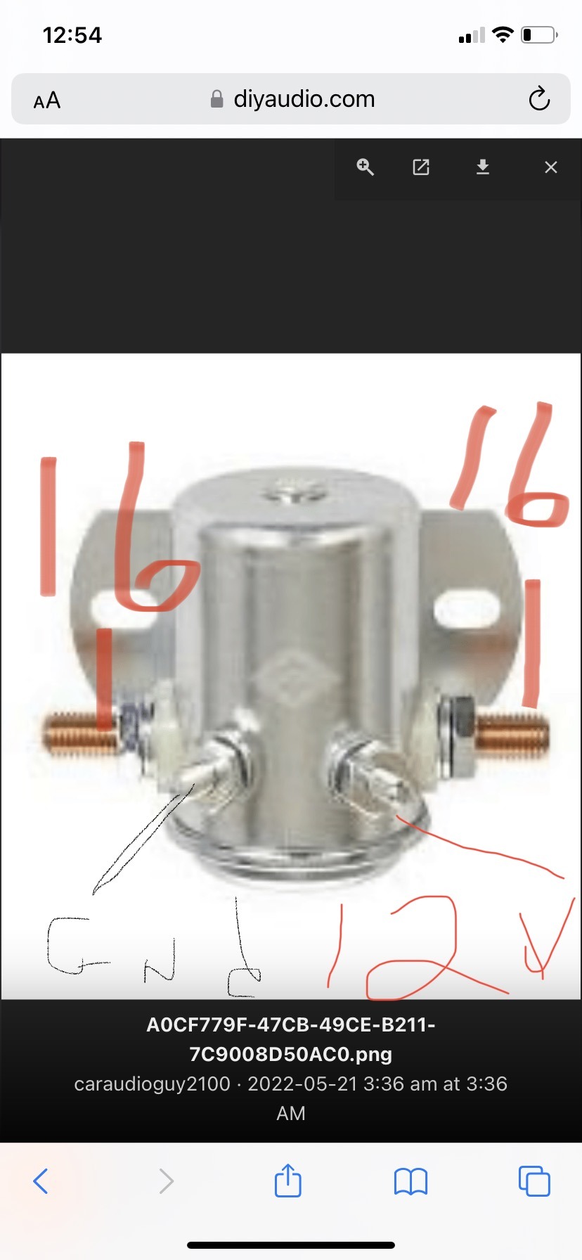

Ok this is how I’m going to wire the solenoid in the charging system .
1 lug has a wire coming from the alternator charging post .
The other lug is going to the external regulator
1 small lug is going to switched ignition wire
Other small lug is going to ground .
Since this is how I’m going to use this solenoid the diodes would still be a good idea correct ?

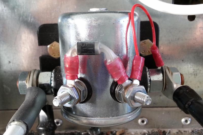

Neither of the small terminals will connect to 16v. One will connect to ground. The other to your switched 12v. The striped end of the diode will go to the 12v terminal.
Until you get this connected and working, I'd suggest inserting a 5 amp fuse in the switched 12v line feeding the relay. It wouldn't hurt to leave it in the circuit in case the diode would short.

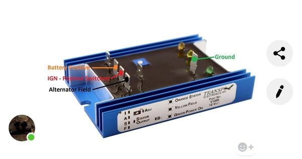

Im adding a 2nd alternator to the vehicle which will only charge the battery that’s located in the rear to run the audio system and be completely isolated from the 12 volt system .
The alternator was built to charge at 15.5 volts with an external regulator. So the cmax battery in the rear of vehicle will be charging at 15.5 volts .
Since this alternator was built for 15.5 volts and is completely isolated from the 12 volt system The external regulator needs to see a switched ignition wire that is 15.5 volts not 12 volts .
So I’m using the solenoid to make a switched 15.5 volt ignition wire . Taking the voltage 15.5 off the alternator stud and connecting it to the solenoid Then the other side of the solenoid goes to the regulator . The 2 small terminals on the regulator 1 of them goes to a switched 12 volt ign wire to turn the solenoid on and off the other Terminal goes to ground .

No.... not sensible at all.
What is the battery voltage in the rear compartment?
12V battery has a max. charging volts about 14.5...So what is the extra voltage charging?
A special voltage battery, not a lead acid regular vehicle battery?
Anyway, the above wiring scheme in post #28 is correct, but the need for a solenoid is not there, there are separate batteries off separate alternators, no point in putting a solenoid.
The alternator regulator will charge the battery just fine, same as in all other cars and so on.

To be clear:
... big terminals for 16 V (load), small terminals (control signal): one is +12V, striped end of diode to that, and the other side of diode to other terminal, which is connected to -12V or ground.
