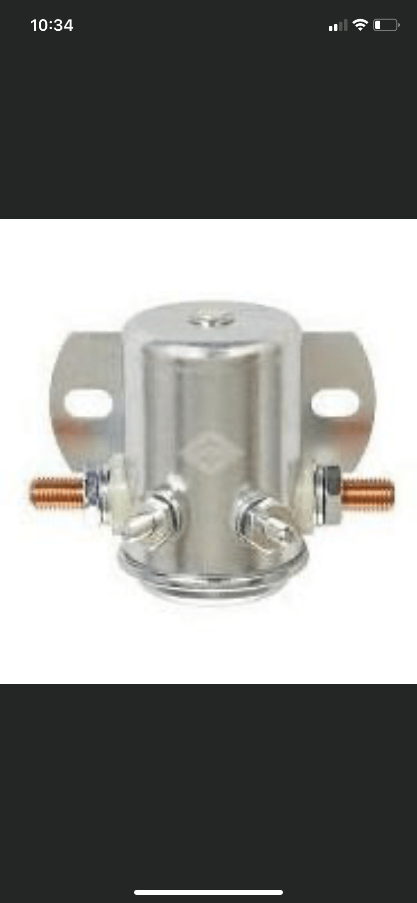

What size wire should I run from the alternator to the solenoid and from solenoid to external regulator? I heard if using to small of wire I could get voltage spikes not sure if that’s true or not
I was told by the manufacturer of the alternators I have to use this solenoid. 1 wire comes from the charging post to the solenoid the other side of the solenoid connects to the switches power terminal of the regulator . Then I have a ground wire and a switched ign wire to turn the solenoid on and off .
He told me to use this in order to isolate the 16 volt system from the factory charging system

Not disconnecting anything . Im using the solenoid for switched power for the external regulator I need the switched wire at 16 volts not 12
Are you simply asking about the 2 small terminals?
Those are for 12v. They can be switched with the ignition on/off.

Yes I need the solenoid to make a switched power circuit since the 16 volt charging system is completely isolated from the 12 volt system .
The Alternators regulators and solenoid are what I bought from the manufacturer. This is what I was told I needed . He’s been in business a long time don’t think he would last long in the business if he was just doing guess work and selling stuff that didn’t work together

I guess I didn’t explain what the solenoid is for properly .
I haven’t hooked the alternators regulators or solenoid up yet . I will be using the switched ign wire (12volts) to turn the solenoid on and off with the key .
The purpose of the solenoid is that the external regulator needs to see a switched ign wire the voltage on that wire needs to be 16 volts not 12 .
This can be done with a solenoid or a relay .
The solenoid will be wired like this . On 1 post of the solenoid I will be connecting it to the charging post of the alt on the other post I will will be wiring it to the switched ign wire on the regulator (16 volts) the turn on post of the solenoid will be wired to the switched ign wire
(12 volts) and the last post will go to ground .
He is thinking of using the solenoid as a single pole heavy duty relay, the control signal is 12 V, the load is at 16 V, that is a completely different isolated circuit.
The switch for control is a key switch.
A diode would be useful to protect the 12 V side from back emf when cutting power.

OK, That means that the high-current terminals of the solenoid are being used to disconnect the control voltage from the regulator. Is that correct?

What I'm questioning is why a 80 amp solenoid is being used to switch a control voltage, especially if the control voltage is passing through a low-current type of terminal.
No, we are talking opposite sides.
He is intending to control a 16 V line from alternator to charging post by connecting the coil of the solenoid through a 12V line with a key switch...I think.
The high current / load side will switch 16V, and the solenoid control coil will see 12V.
