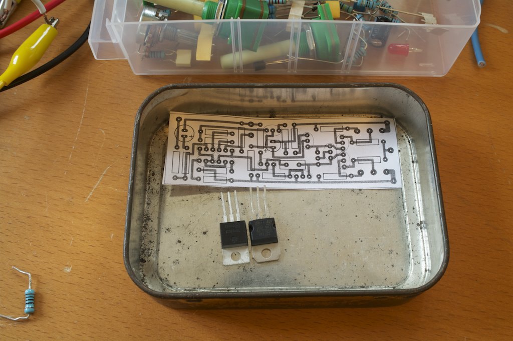

I've got my basic PCB topology down. I don't know if it'll fit in a tin yet. I think it will.

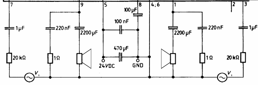

I have a TDA4935 it only uses about 10 components to make a stereo 15 watt per channel amp... Not sure if it would fit in a tin, or how hot it would get, mainly because i have no idea what i'm doing lol, but i might give it a go.
Got no idea how to post image from pc so i cant show schematic!
Well, I think I've finished my PCB design, and I've found an old tobacco tin (not mine, I have never smoked!). Hopefully this doesn't break the rules ;)
Minty fresh breath is not required. :D
Is the alternative tin approximately similar size to the average mint tin?
I have a TDA4935 it only uses about 10 components to make a stereo 15 watt per channel amp... Not sure if it would fit in a tin, or how hot it would get, mainly because i have no idea what i'm doing lol, but i might give it a go. Got no idea how to post image from pc so i cant show schematic!
TDA4935. . . a bus, truck, "18 Wheeler" chip! Yes, it is designed to work within small metal enclosures--a truck radio in a hot dash. That chip is surprisingly fast.
Schematic
