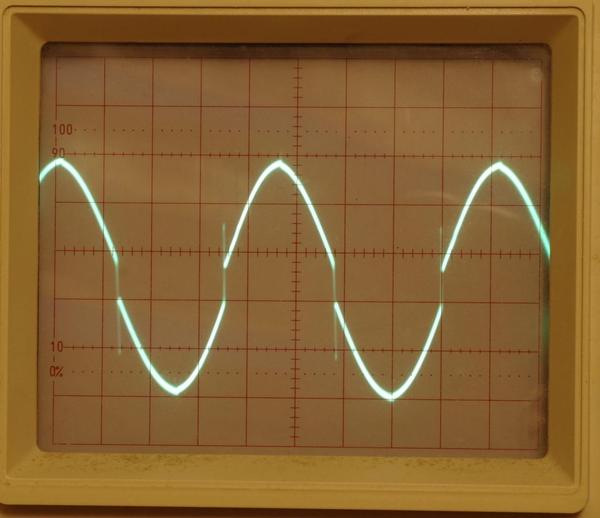

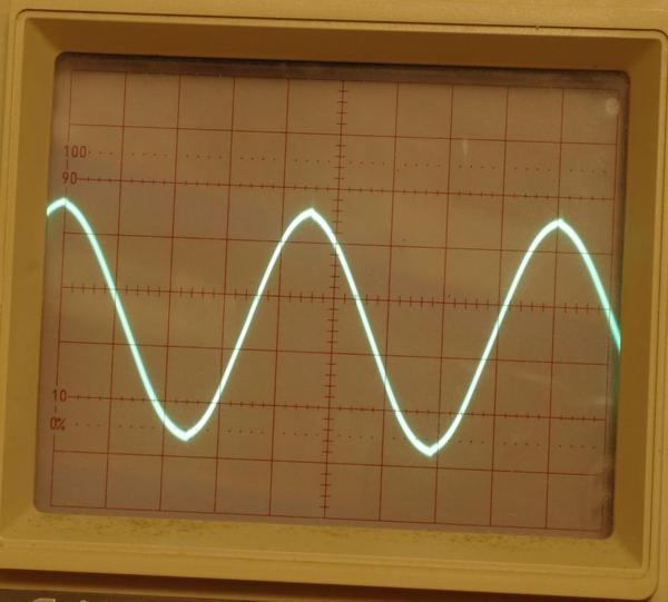

That line looks smooth, but distortion is relevant in the 1/100 and up range, you cannot assess that visually on a scope. Actually I think I can see some Gm doubling there, it straightens out the sine curve near the crossover region so it looks more triangular.
Furthermore, say your VAS input has an impedance of 500k which is normal. Your miller cap is virtually multiplied by the voltage gain of your VAS, so your VAS gain rolloff corner is probably in the tens to hundreds of Hz. So for most of the audio band into RF, your input stage sees not what is in your scope shots, but that through a +6db/octave frequency filter. So the reality is worse. In LTSpice, you can plot this by entering D(R5) and you will probably see the crossover distortion now. Now you can compare it to an EF.

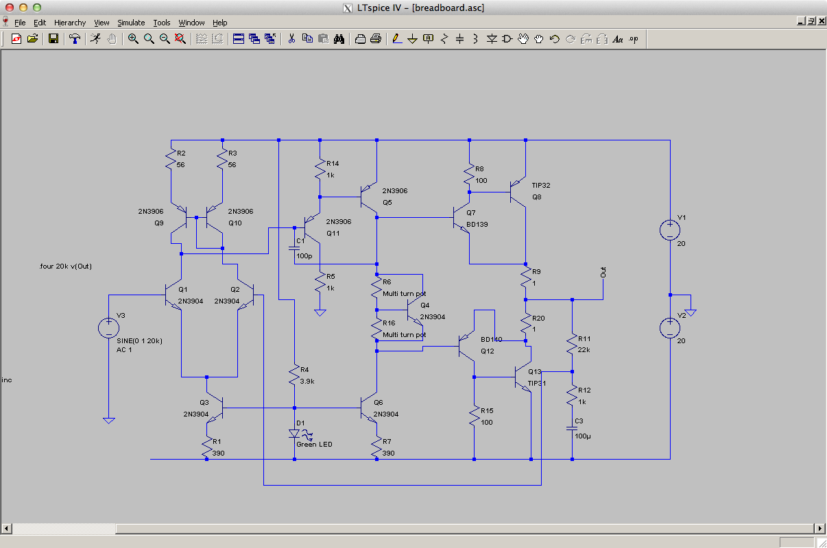

keantoken,
The signal is across that 1k resistor that feeds the VAS buffer, which is after where the miller cap feeds back to the LTP - the voltage at that point would look very lowpassed I'm sure, since it's a current node, but this resistor should reflect to some degree the current being fed into the VAS transistor, I think?

Note that the funny notches on the peaks of the sine wave are from the signal generator.
That's a common effect caused by synthesizing a triangular wave (that function generators produce as a base waveform) into a sine wave.
why is the lower leg of the NFB taken to the -ve rail, rather than to the source return wire?
I used an electrolytic cap here - I just wanted to ensure it was charged to the correct polarity. I've always suspected there is a better way of doing this though!
the -ve rail will inject all the rail rubbish into the -IN pin and it will get amplified to come out of the OUT PIN.
R5 will reflect the VAS current quite well. But this signal is a very tame version of the actual error signal you would see if you probed across the LTP inputs. The issue is that you are not really seeing the distortion that's there, because it is swamped out by the fundamental. 1% THD is 1/100 distortion. It is not easy to see 1% THD on a sine wave, but it's there and it matters. The D() function in LTSpice helps greatly with visually assessing distortion and tracing it to its source.
I'm aware of this - luckily in real life I was using a single rail supply so it was really going to ground. The image shows a split rail design because I quickly converted another circuit into what was on the breadboard and forgot to make it single rail.
Out of interest, if just grounding that point, how do you ensure the capacitor never gets reverse biased by any residual offset? Does it just not matter with the usual values of DC on the output?
Small DC (<100 mV) offset is not a problem. A diode can be placed in parallel to protect it for abnormal high-reverse DC.
