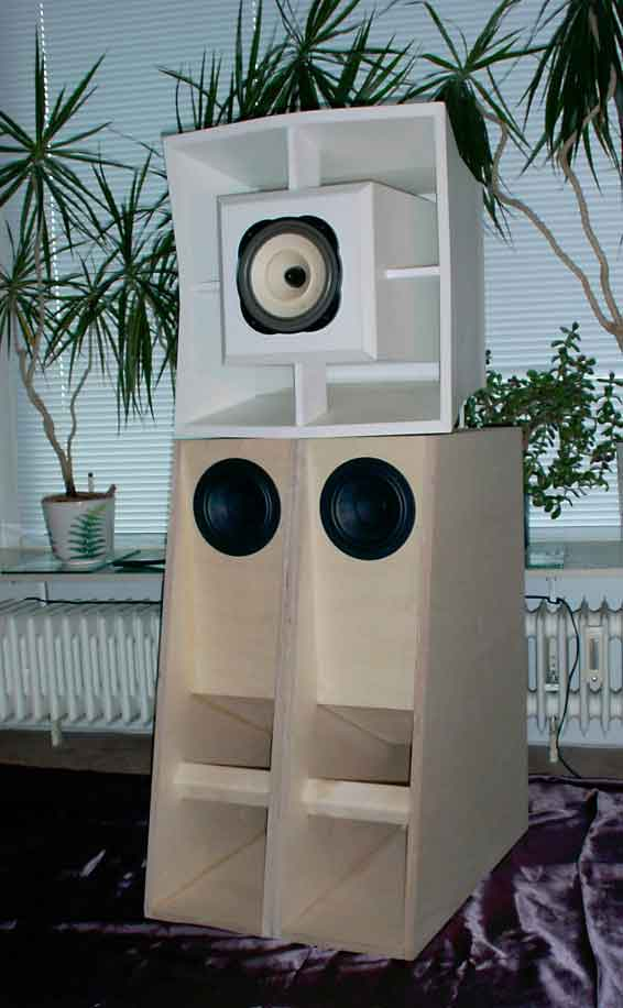

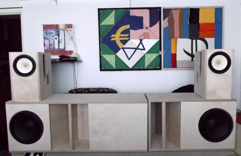

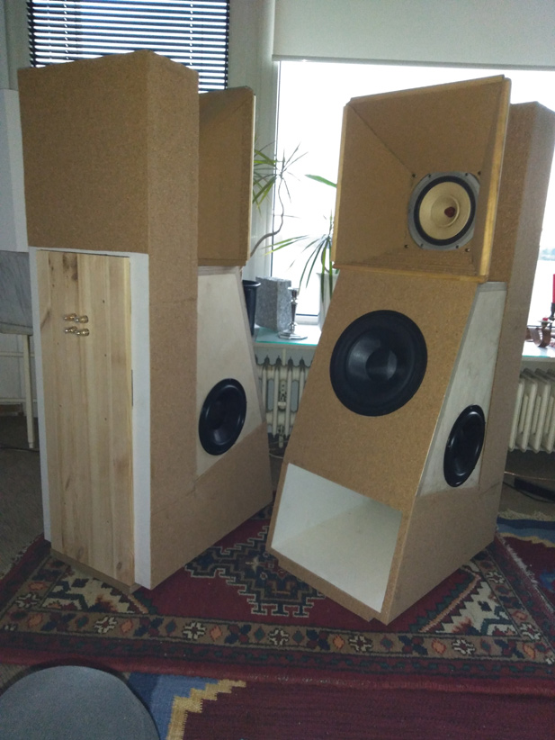

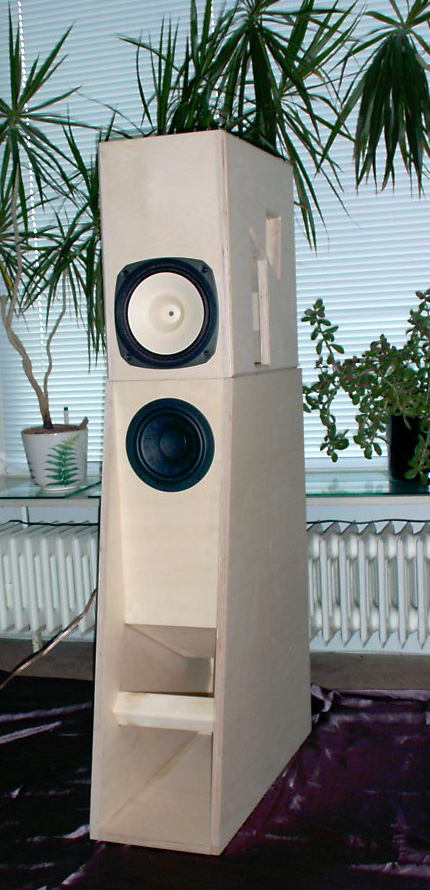

take a double horn, take Sonido driver in front and back, look the feedbacks and measurements
http://www.hm-moreart.de/116.htm , free plan https://de.pinterest.com/horst4304/rdh-20-copyright-free-152024/ ,
