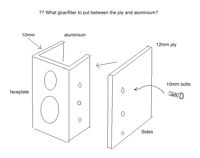

I would like your opinions on what glue/damper to use between aluminium and ply. These will be solidly bolted together with 10mm bolts. I have a very solid aluminium face plate and the rest of the cabinet will be 12mm plywood. Picture shows how the sides will be attached to the U section faceplate. Faceplate is 6" across and 15" high and 3" front to back.
I've seen suggestions for Tightbond Melamine glue and Sikaflex. On ebay here in UK I see Sikaflex 221 and EBT+. I suppose bitumen and butyl sheets are possible but I doubt I want any thickness of filler here - rigidity is the objective. Feel free to suggest any product you think would work here.
