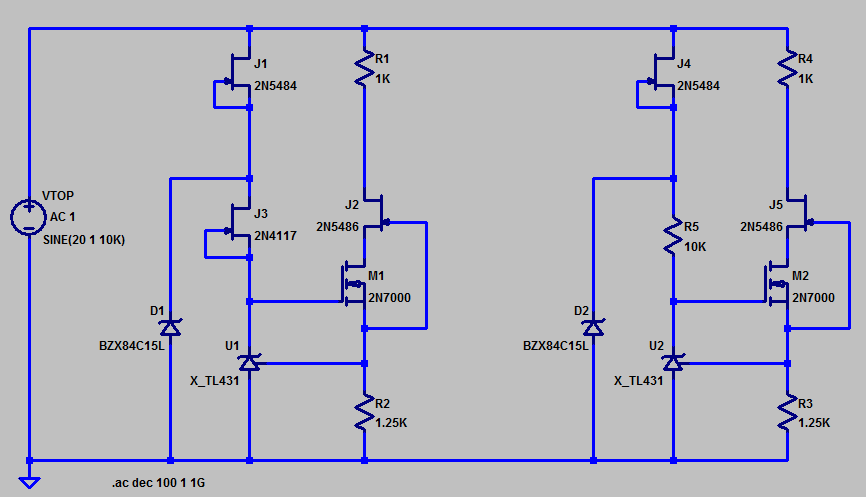

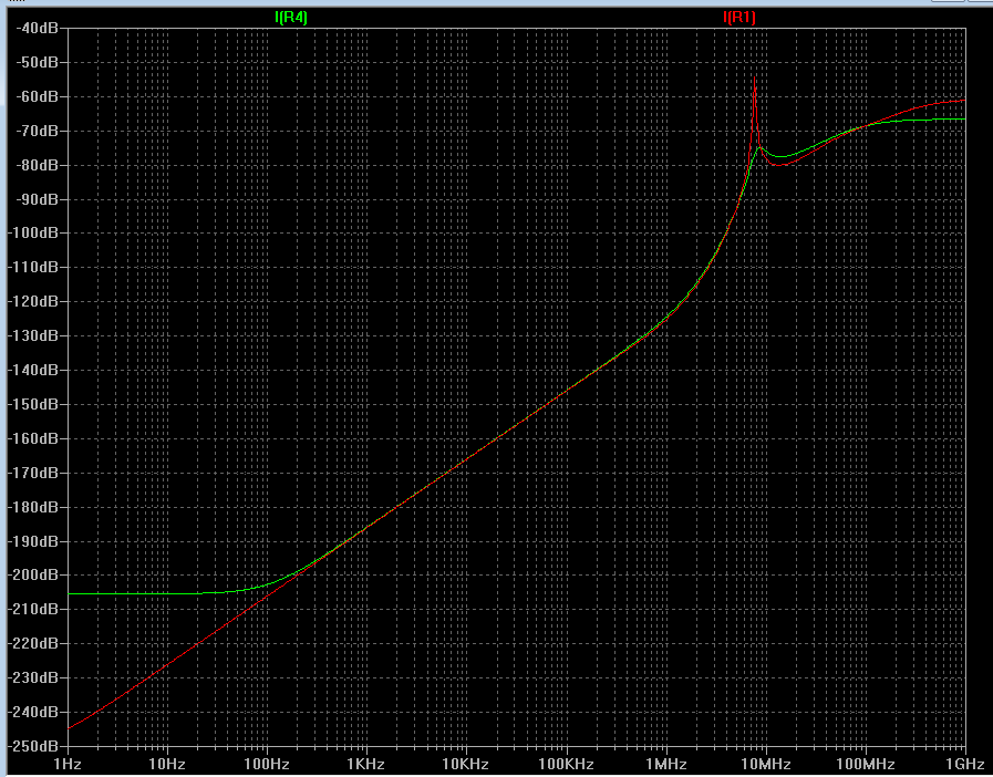

Glad to see you here Pete!
Same parts count, higher impedance @ very low freqs & DC
replace 10K with 2N4117
_

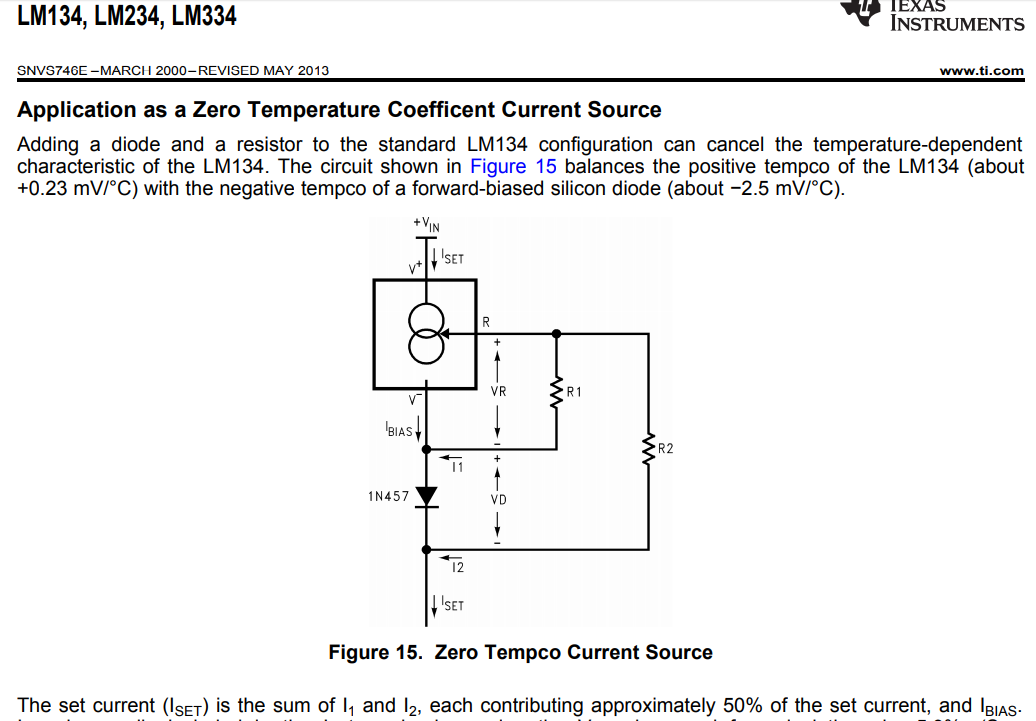

Temperature compensated LM334 requires 4 components, figure attached.
The more traditional Opamp, Precision VREF, MOSFET, and current sensing resistor requires 5 components if you allow ~4V drop across the current source; 7 components if you only allow yourself to drop < 400mV across the current source.
