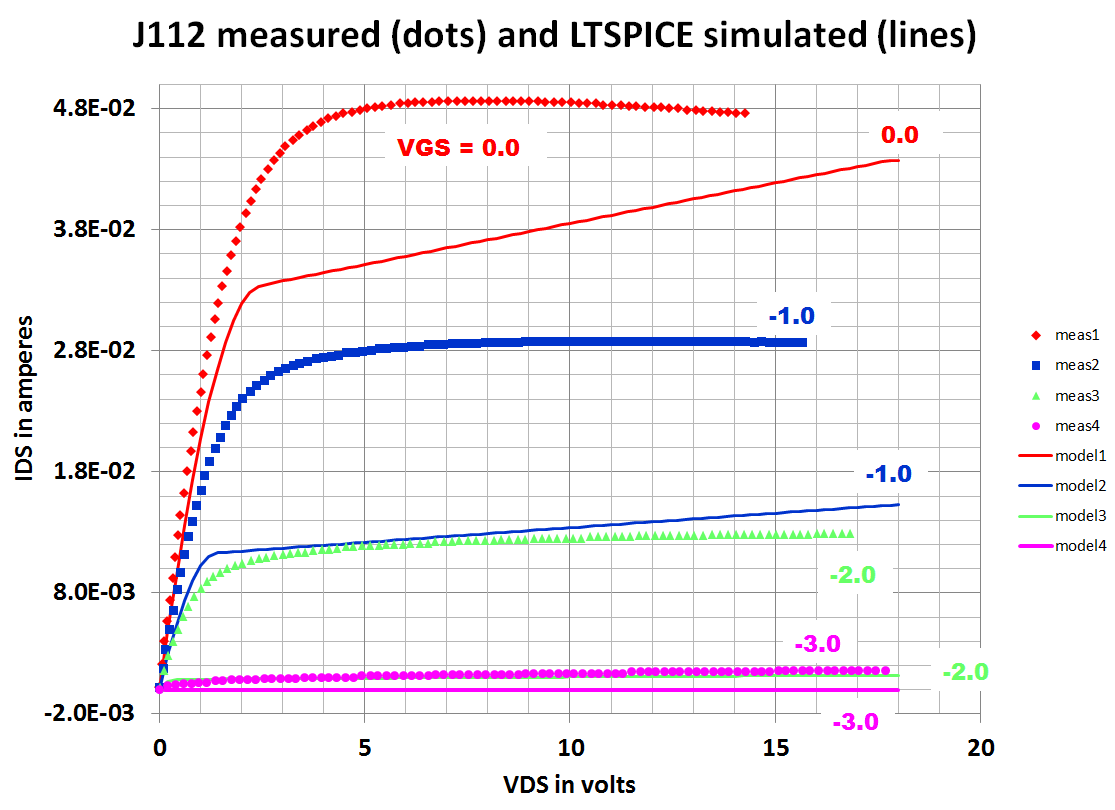

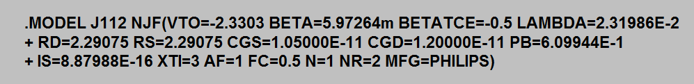

Assuming you mean using the JFET to provide a constant current in place of the resistors, then yes there is benefit. However, the result is not better than the 2 JFET and needs more parts.
I will try finding some of Elvee's examples and see if I can't learn something from the way his simulations are set up.
I started to do some measurements but quit early; went out to the pool for some sun and a T&T about half way thru. This is as far as I got. JFETs are notorious for their wide spread of parameters and maybe this might be a small piece of confirming evidence.
Fairchild makes a low tempco version of the TL-431 called the KA-431. I use it in a CCS where the KA-431 sets the gate voltage of a power MOSFET. This is used as the cathode current sink in the output stage of a KT-120 PPP differential amp. At 300mA the bias current stays within +- 0.25mA cold to hot.
Although you won't see any improvement in sims with perfect dc rails, in a real world circuit with noise this can have a major improvement in psrr.
I use this CCS in my VSSA 🙂

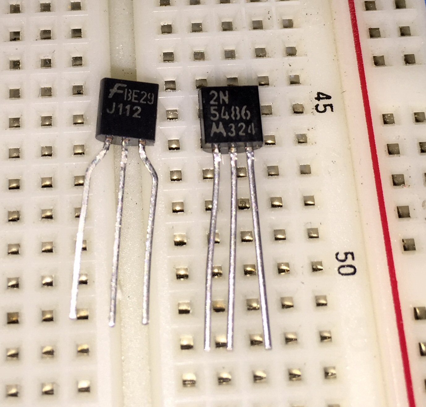

Looks like those J112's need a minimum 5 volts drain to source plus the voltage across the source resistor to be effective. Not very practical in many applications. Like everything in this hobby, it's always choosing the what,where, and how that makes things interesting.

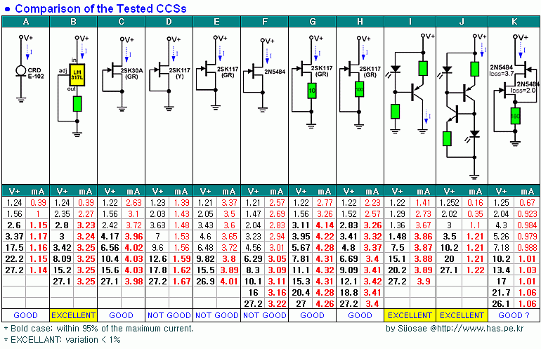

Totally agree with Calvin.
One of the best low-noise CCS you can make, with low voltage headroom and high impedance is a heavily degenerated 2SK246.
Best to use Idss > 5mA (GR grade), and degenerate to < 2mA with a 1k to 1.5k resistor.
The high resistor value helps to stabilise against drift.
The current is almost independent on Vds as long as it is > 2V or so (= high dynamic impedance).
If you need more current then just put multiple in parallel.
Cascoding will improve dynamic impedance even further.
2SK170 and 2SK117 (=2SK209) do not appear to have as good a rejection for Vds variations.
The modern day equivalent for 2SK246 is 2SK208, available at Mouser.

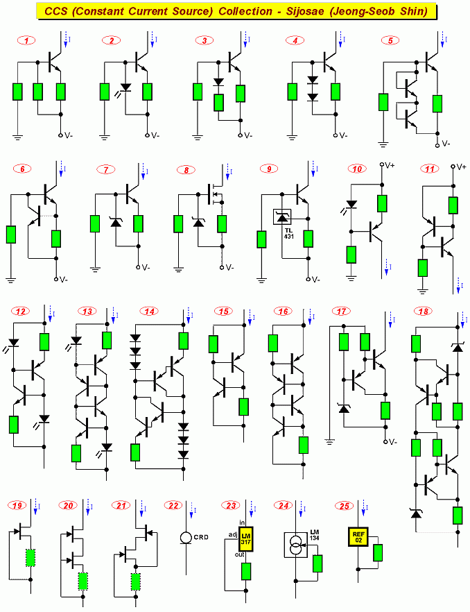

bjt "ring of two" works to very low V
possibly useful fet info:
forum search titles in Solid State "ccs" gets earlier threads
looks good:
http://www.diyaudio.com/forums/solid-state/86626-searching-best-ccs.html
Siliconix jfet app notes from Archive.org JFETs Application notes
its useful to know the "triode/pentode" Vds operating regions
more on long/short channel fet and cascoding for ccs

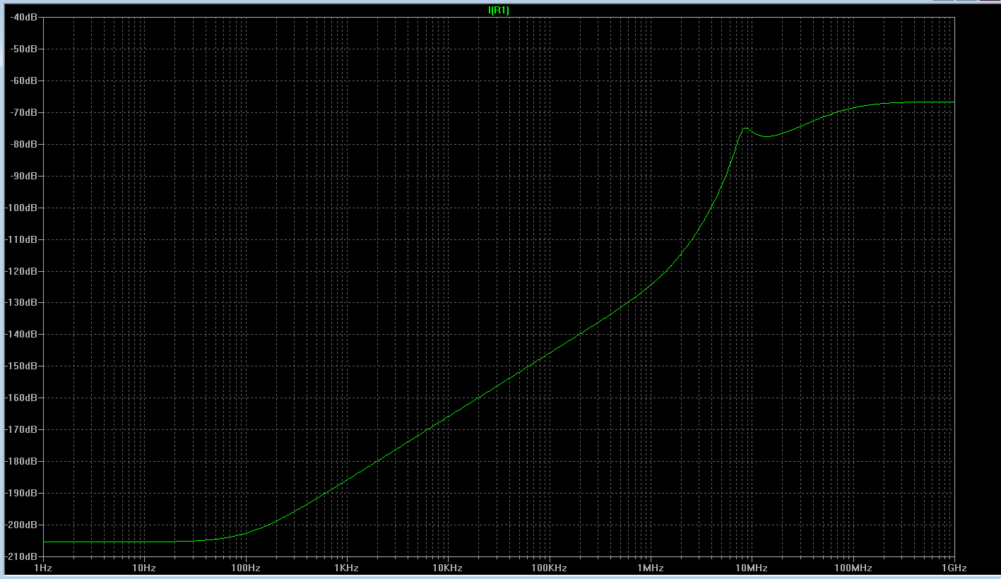

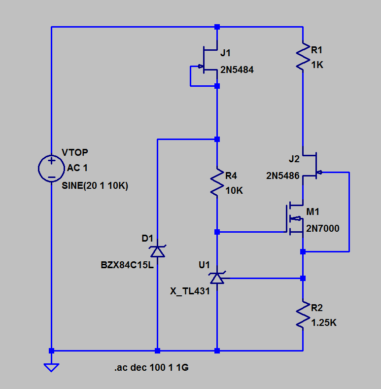

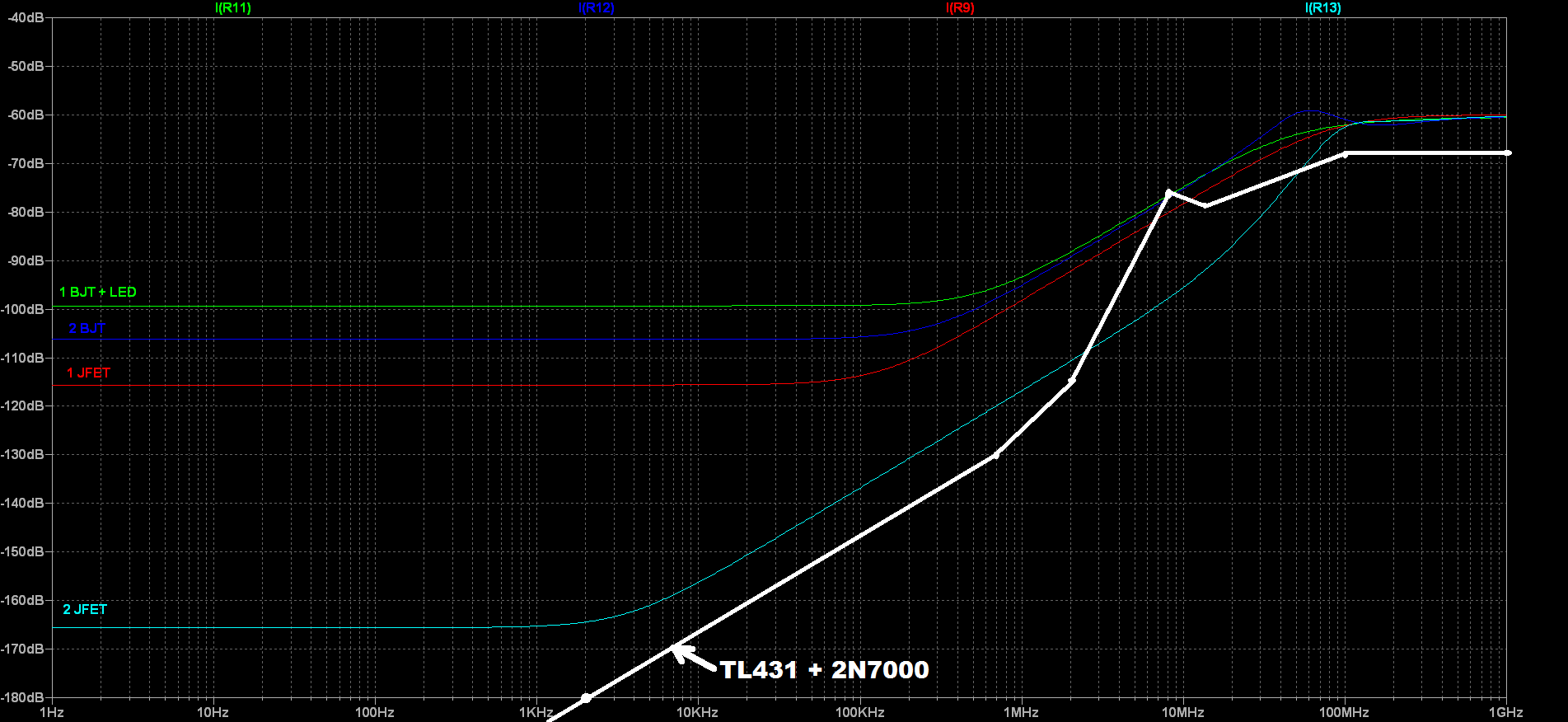

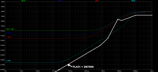

I used the subcircuit model of the TL431 in post#23, to build the current source shown below. I deliberately included the "flaw" of connecting the bias circuitry to the aggressor (noise source). Schematic and ac analysis in Figures 1 and 2 below. Figure 3 is my none too artistic attempt to overlay its frequency response, upon the chart found in post#1.

Thanks for presenting the quantitative gain of using various schemes such as LED+BJT, 2BJT, JFET, and TL431. The TL431 indeed looks very promising - can it provide that level of performance by itself or only when used in conjuction with ancilliary components as shown in the schematic with two JFETs and an n-channel MOSFET (a rather high parts count)?
Experiment with these and see which design (or which design variation) you prefer. You might enjoy the current regulator diodes sold by Mouser.com; their parts count (1) is literally impossible to beat. Here is a link:

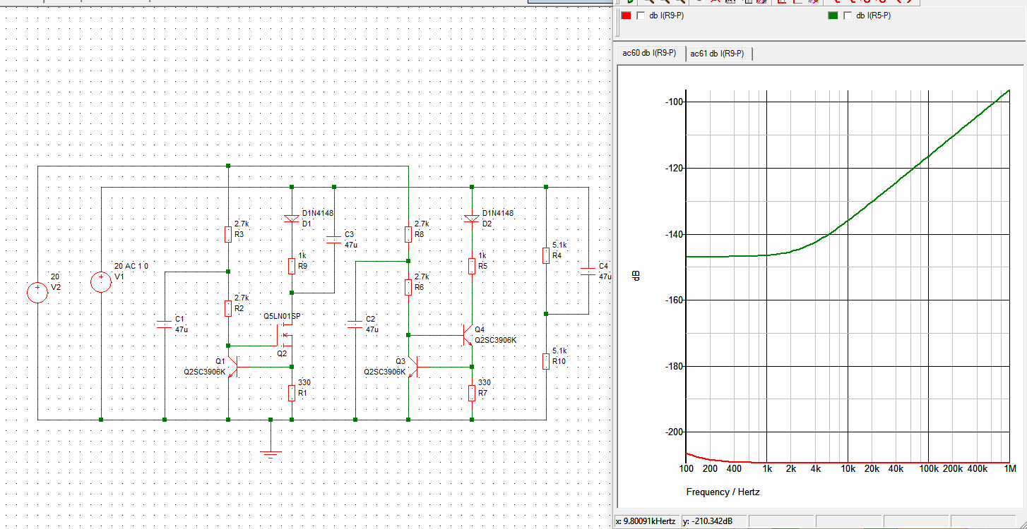

I have used this many times as biasing current source for LDRs.
It is however not the lowest noise device you can come up with.
The advantage is of course current stability.
But you can also make much more precise CCS with quite low noise if you are prepared to go 3 terminal.
The attached Spice schematics is a circuit we used to match LDRs.
The requirement is stability over hours, and repeatability over months, rather than simplicity and low noise.
As an equipment current source it is hard to beat.
But it is unlikely I would use it in an audio circuit.
