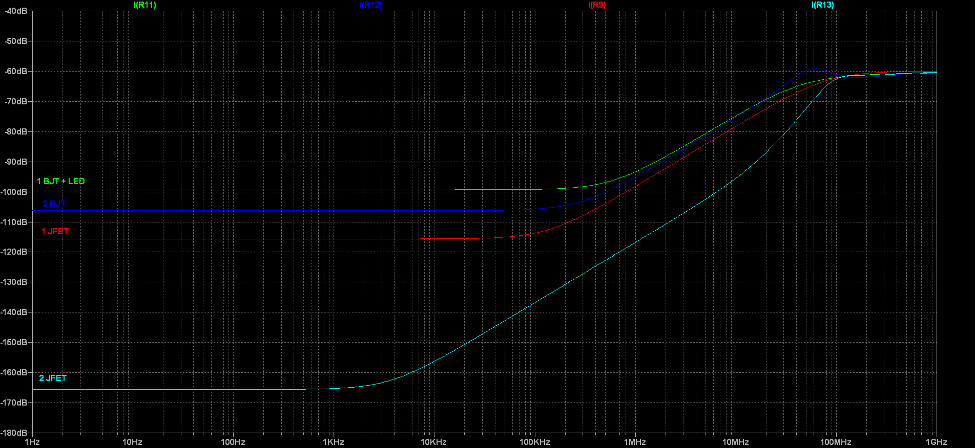

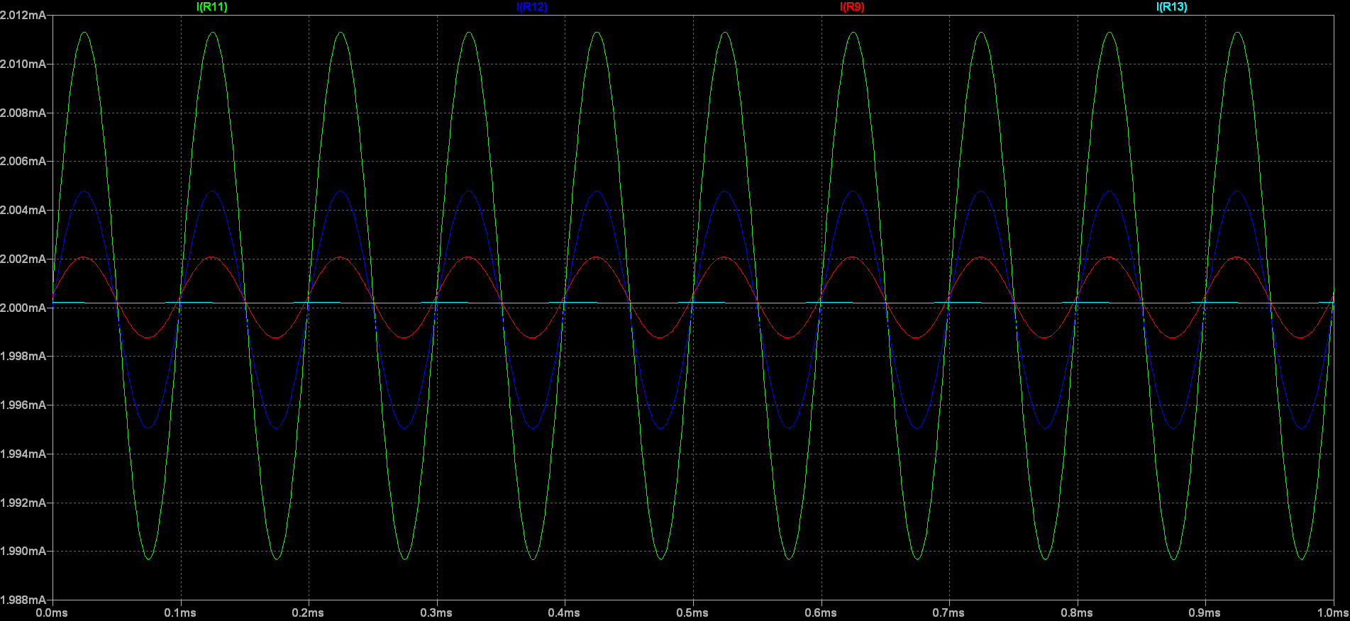

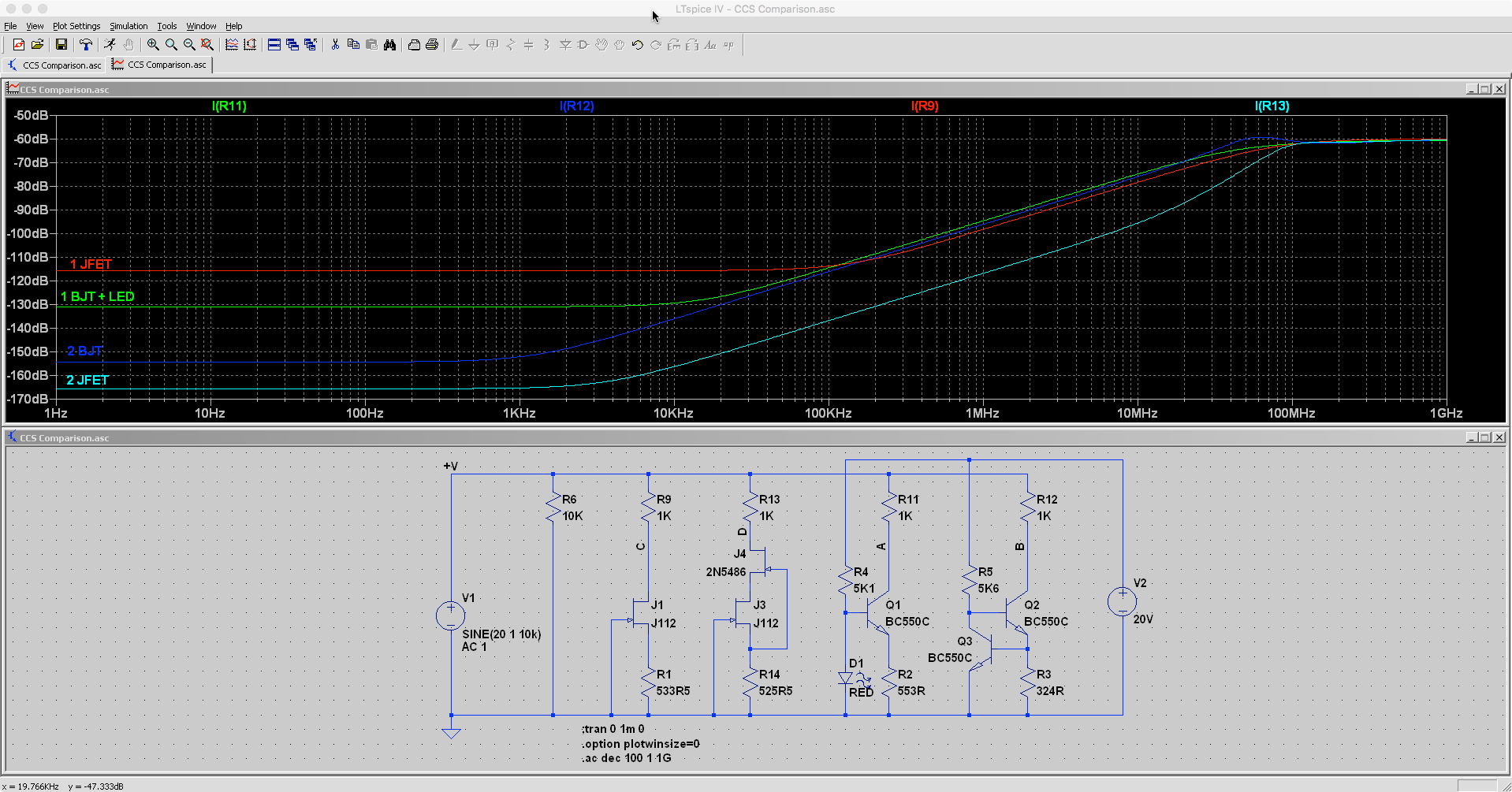

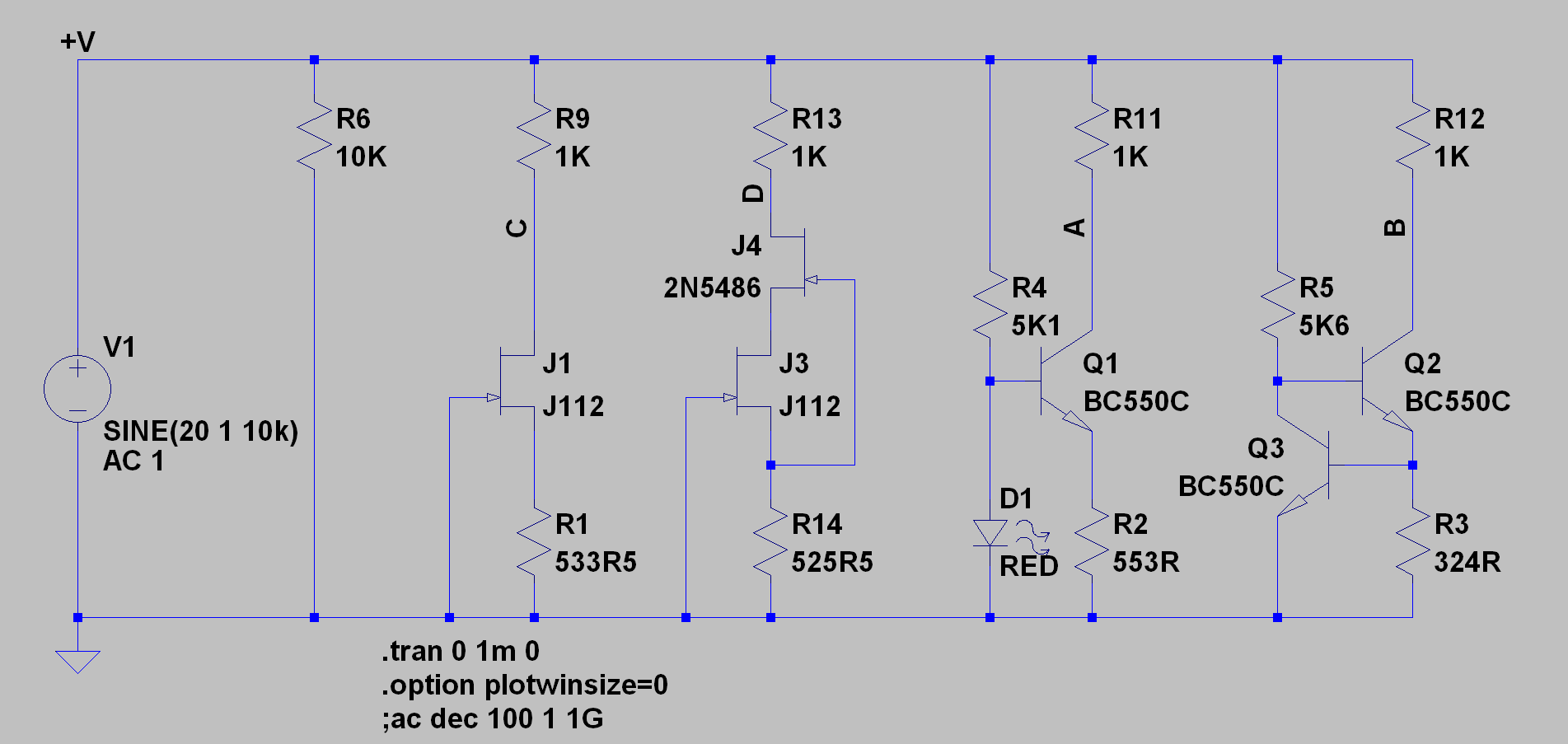

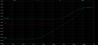

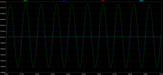

And attached are a few basic CCS circuits and a little of their performances. Please do point out any fundamental errors or ways to improve the simulations. Comments, ideas and suggestions?

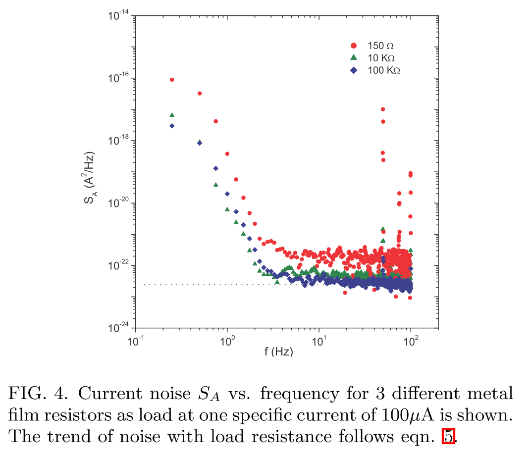

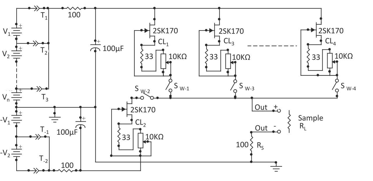

Just found a paper:
Low noise constant current source for bias dependent noise measurements
D. Talukdar et al.
A low noise constant current source used for measuring the 1/f noise in disordered systems in ohmic as well as non-ohmic regime is described. The source can supply low noise constant current starting from as low as 1 μA to a few tens of mA with a high voltage compliance limit of around 20 Volts. The constant current source has several stages which can work in a standalone manner or together to supply the desired value of load current. The noise contributed by the current source is very low in the entire current range. The fabrication of a low noise voltage preamplifier modified for bias dependent noise measurements and based on the existing design available in the MAT04 data sheet is also described.

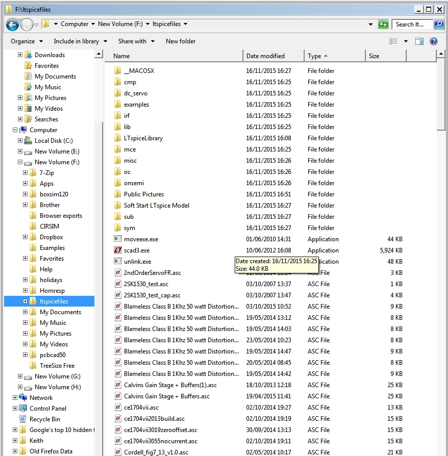

Nice find! I love 2sk170's and was hoping there would be a way to use them for a high performance CCS.
I copied and moved the two models.text files to my LTspicefiles folder.
I opened the .asc
"run" but it can't find the models.
Where do I put the .txt files so that the .asc can find them?

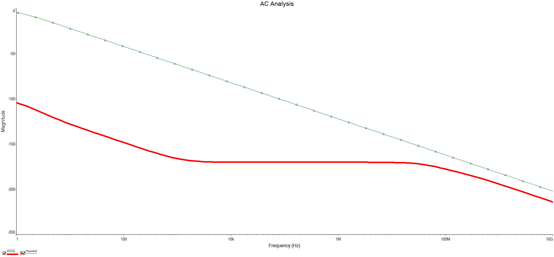

Here's my results with the schematic on the paper.
Y-axis: decibel

The op's sim is flawed since R4/5 are fed ac as well. They should be connected to a dc source with no ac signal.
Noted. I will set up a sim with a stable bias source and see how they look.
Edit: Changes the results quite a bit. Things actually look closer to how I would expect. Thanks for pointing out my error.

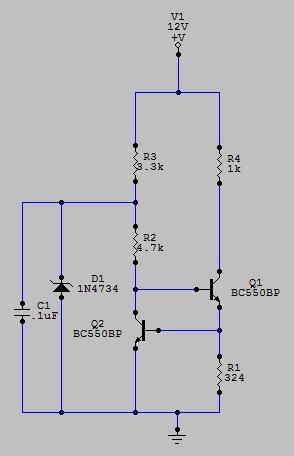

An under-appreciated attribute of current source (Q2/Q3/nodeB) from post #1 is: extremely high output impedance thanks to negative feedback. Much higher than the 1T circuit Bob Cordell recommends (6.3V zener drops 5.6V across emitter resistor) to people who seek high output impedance. Careful / clever choice of R5, or R5 replacement, gives excellent PSRR too.
Can you offer any insight into optimizing the 2 BJT biasing arrangement?
