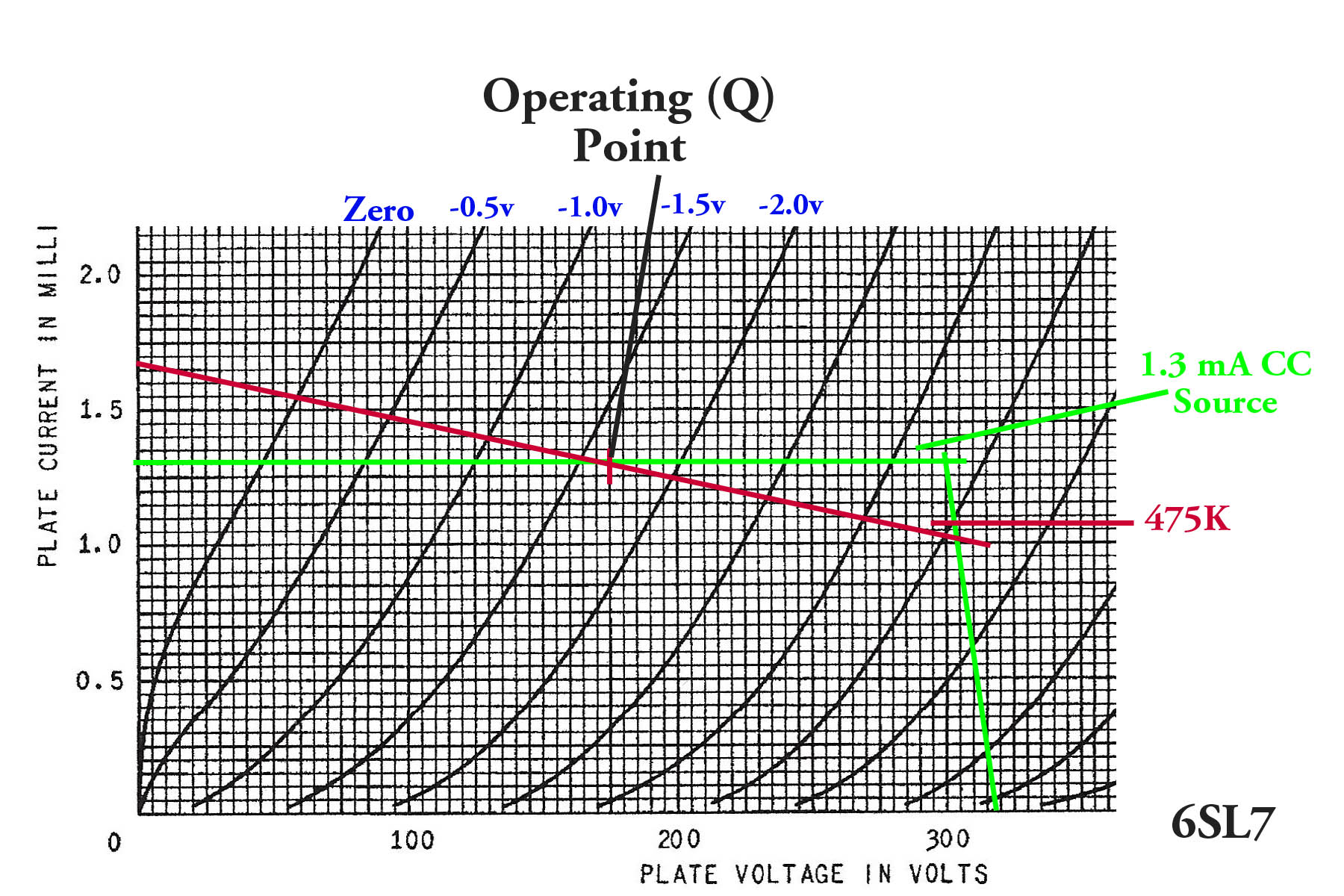

Common triodes, whether voltage or power exhibit lower distortion while driving higher load impedance's.
The D% vs output of a 6A3 is a generic curve & applies to most of these common triodes.
A CCS as a plate load for a voltage amplifier triode does that, the load impedance becomes the following grid resistor
in parallel with whatever internal impedance the CCS achieves.
A mu follower gets us there.
Whether it sounds better depends on each persons ears, how much beer they have consumed & the phase of the Moon,(y)

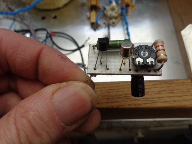

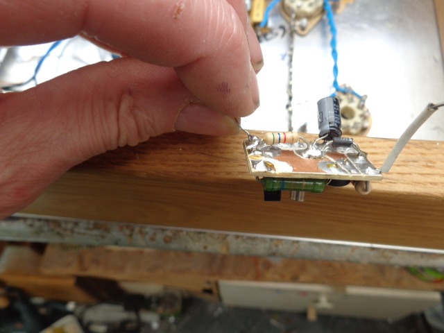

I've tried this a few times with 6SN7's and went back to using a 47k as the anode load, having tried in the past 62k & 100k too but have found a 47k with a HT of 250-300v to be optimum. I found there was no OP gain improvement with a CCS, didn't measure the THD though. I used if I remember right a 2N2907A & MPSA92, the CCS is adjustable like the OP's CCS - see pic.
Andy.
