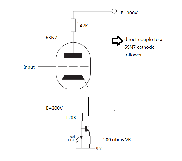

I tried CCS for 6SN7 bias but it doesn't work !
The CCS is as the following drawing and the 150K was replaced by 120K, the BJT is BC550.
Also the fixed resistor 200 ohms was replaced by a 500 ohms VR to trim the bias to 3.5ma for 6SN7.
When I hook up with the power amp., it only gave a very very little sound even the volumn was turned to the end.
I can trim the CCS using the VR to reach at the bias I want, and the plate voltage also varied when the VR changed, everything seems to be OK, but I don't know why it doesn't work 😕
Would any body help me that anything I should pay attention or missing ?

With a high impedance in the cathode, your gain will be zero and your output impedance will be sky-high. You will also have some compliance voltage limits.
Strongly recommend that you look over "Valve Amplifiers" 3rd edition to see the right uses and implementations for CCS.

A CCS can be applied to a SE circuit, but you have it in the wrong place. use a PNP transistor rather than the NPN, swap the positions of the LED and bias resistor, stick it in the plate circuit, and use a suitable value of cathode resistor to bias the tube. Alternatively you can use the CCS you have and feed a current mirror in the plate circuit, with the aforementioned suitable bias resistor in the cathode circuit. If you use a CM you can keep it simple or make it fancy with base current compensation or a Wilson mirror. In the case of a SE stage I see no real advantage of the CM over the CCS in the plate circuit. The CM does isolate the CCS from variations caused by swings in plate voltage, but the simple CM is going to be susceptible to variations as well. The Wilson mirror (with or without base current comp) will give a higher plate load impedance.
Or you can stick with a simple resistor like all the classics used 😀
