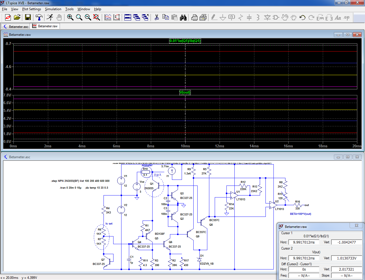

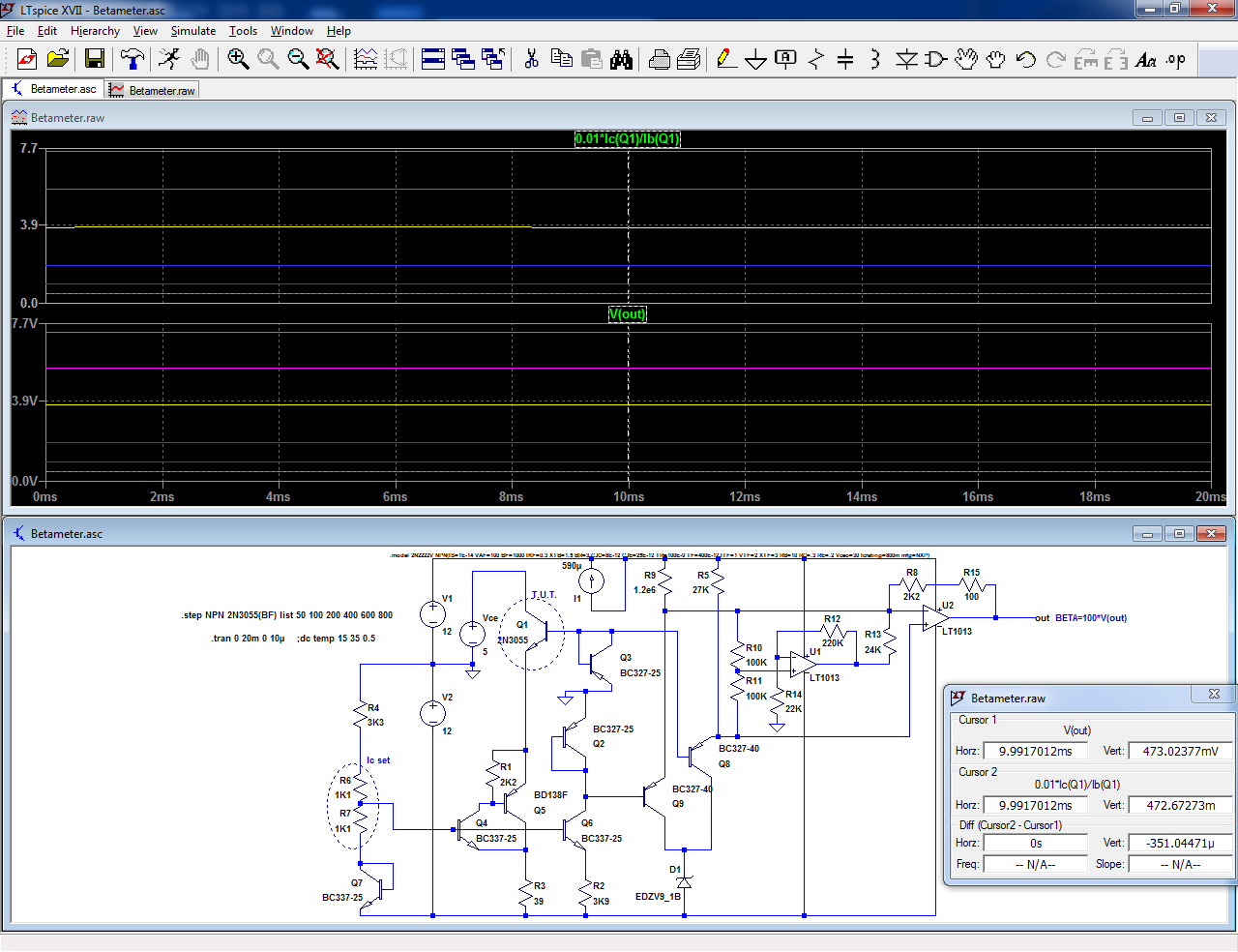

Here is a first, basic draft for a constant-current, direct-reading β-meter:
attachment.php
Of course, it is somewhat simplified and does not include higher order corrections, but that is a start, and if it works as intended it would be perfectly usable, especially for comparisons.
With the values indicated, this example covers an Ic of ~0 to 100mA (with a 2K2 potentiometer), and the β value is a voltage = to 1V for β=100.
A multimeter or panel-meter could be connected to the output.
The Vce source is shown as independent, but it could be the main 12V too.
Other values or range-switching would be possible too.
The sim shows a 2N3055 tested, with its β value stepped between 50 and 800.
The graph does not show the exact spice value, because the actual value depends on a number of correction factors.
The actual β value is displayed in the other pane, and shows a very good agreement.
I will refine the circuit and make some breadboard tests.

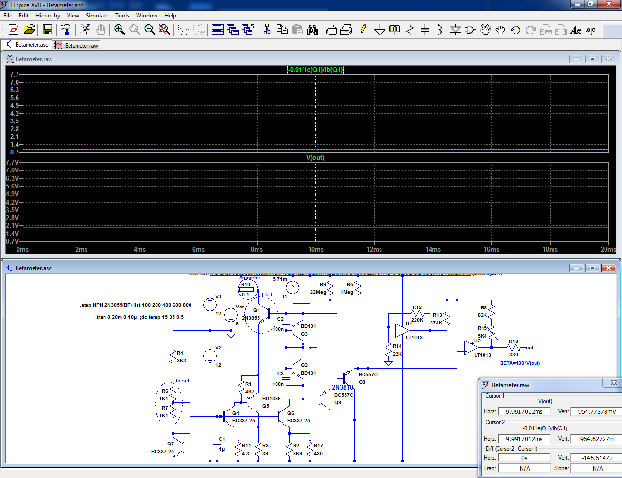

To change this sim into a real tester, two problems need to be addressed: one is the polarity switching, and the other is the Ic range.
In its current form, NPN only with a single 0-100mA range, it is a good starting point for a general -purpose tester, but it is somewhat limited.
Changing the collector current range looks relatively easy: one just has to adapt the CCS's defining the collector and reference currents.
However, the design is heavily simplified, and built around the 100mA range. If this current is significantly modified, the simplified CCS's, informal log and antilog converters will lose some of their accuracy.
Of course, it is always possible to use massive feedback, with opamps everywhere but the spirit of the project is based on simplicity and minimalism.
The only opamps used so far are the final stage of the antilog converter and an (optional) logarithmic CM canceller, and ideally it should stay that way.
Fortunately, the circuit tolerates one decade above and below 100mA, with a reasonable loss of accuracy:

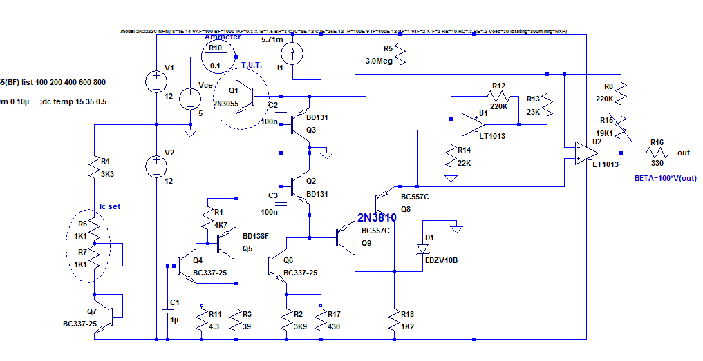

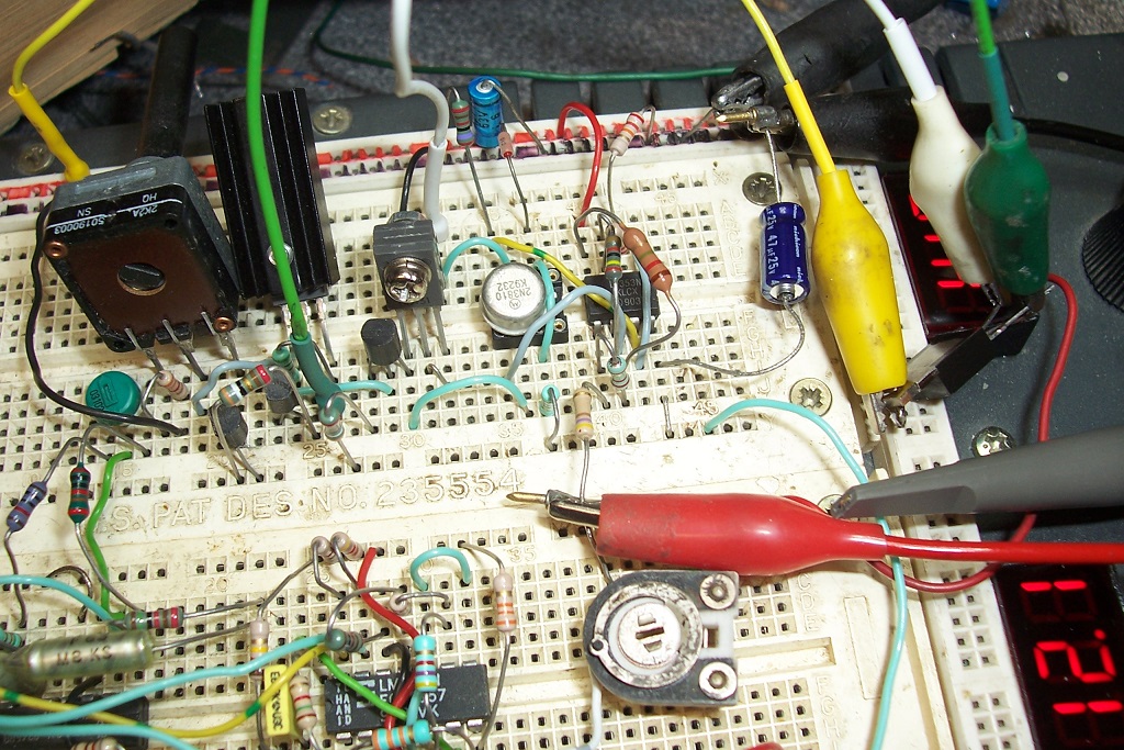

I have made a reality check:
attachment.php
The circuit worked broadly as expected, but to arrive at a reasonable accuracy, I had to refine some aspects, related mainly to matching/thermal tracking.
attachment.php
I had expected it, but I wanted to have a real physical feel of it to make mods.
Q2/Q3 and Q8/Q9 need to be closely matched, and they have to track thermally, which is not obvious because they are subjected to differences in dissipation.
In the sim, there is no such problem of course: transistors are ideally matched, and kept at exactly the same temperature.
In reality, I have selected two BD131 for Q2/Q3, and bolted them together with their mounting base in contact to ensure a very good thermal contact.
The two TO126 cases are substantial, to cope with the wide variation of dissipation depending on the range and the beta of the DUT.
For Q8/Q9, I could use the easy option: a dual transistor, but I had to reduce their Vce with a different diode arrangement.
The 9.1V zener left ~3V of Vce, which was too much, and not very accurate because of the subtraction.
Now, the Vce is approximately 1Vbe. The reference diode is a zener too, because it is not gold-doped unlike common signal diodes and thus allows a slightly larger voltage. The likes of OA200 aren't easily available anymore.
U2 needs to have a low offset, preferably <0.2mV

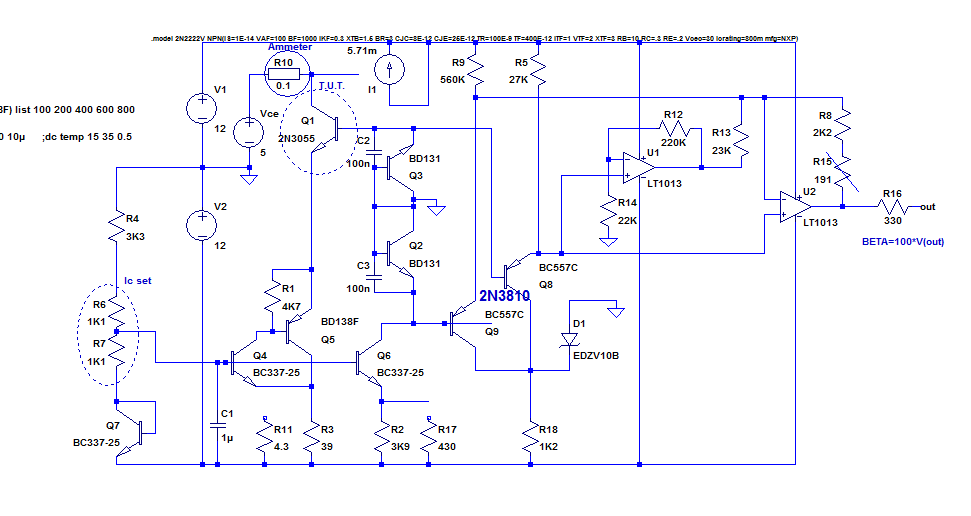

Further rationalization:
For the low-current range (0 ~ 10mA), the base current from Q8/Q9 began to become non-negligible compared to the current provided by Q1/Q6, causing additional errors.
This did not compromise the usability, but it degraded the absolute accuracy.
An obvious solution is to reduce the operating current of Q8/Q9, but I was reluctant to do it, because I prefered to operate all the transistors involved in the analog computing at broadly comparable currents, to reduce higher order effects.
As there was a compelling reason, I did try it in the end: I first increased the impedance level tenfold, and noticed no adverse effect.
As a result, I also tried a 100x fold increase... and it also worked without any problem.
Increasing the impedance has the advantage of reducing parasitic currents, but it also eliminates self-heating issues.
Thus, my initial fears were unfounded, at least for this range of currents.
This is the circuit I tested (in reality, on the breadboard prototype):
attachment.php
For the final version, I am probably not going to be that extreme: a 30x increase is probably more than sufficient, and will be less sensitive to stray fields.

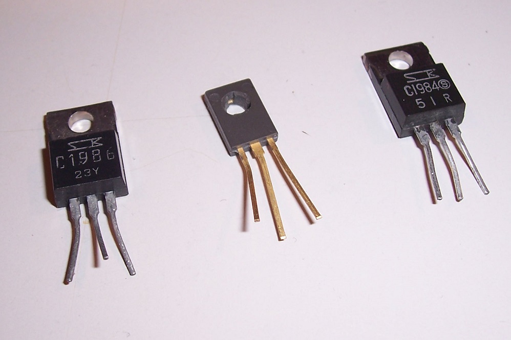

I tested the new version with "extreme" transistors: superbeta transistors from Sanken having up to 1K of β, and a BD131 reject having <50 β:
attachment.php
The test succeeded perfectly, meaning the current reduction can be safely implemented

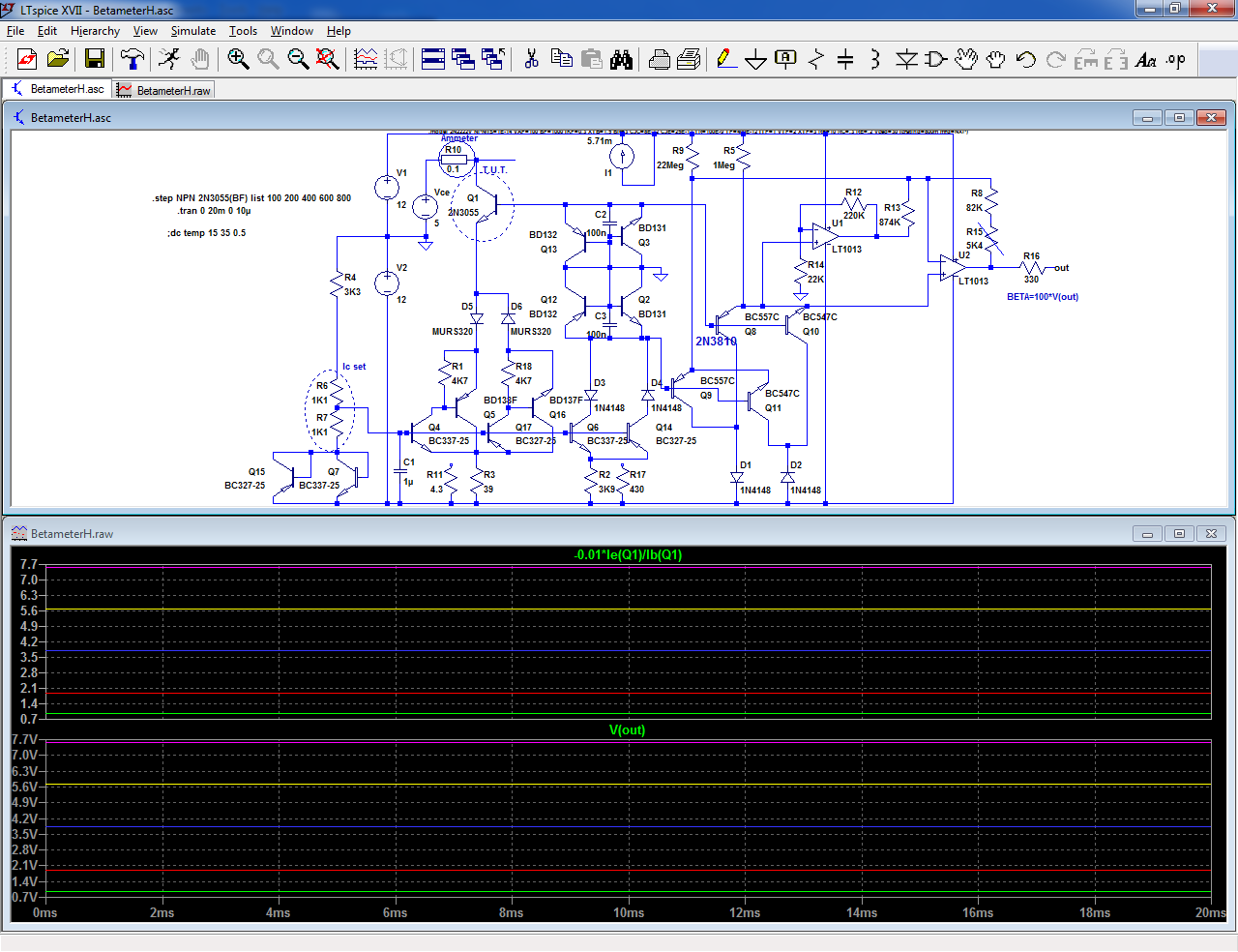

This is the adapted circuit and its sim, showing that the operation for the unisex variant remains exactly the same. There are blocking diodes, of course:
attachment.php
This circuit could therefore serve as a flagship for the LGBT cause!
In practice, the β-acquisition would have a polarity inverter, but the subsequent opamp circuits would remain the same.
The polarity on the indicator would be reversed, but this is in line with the presentation of semiconductor data, so it should be alright
