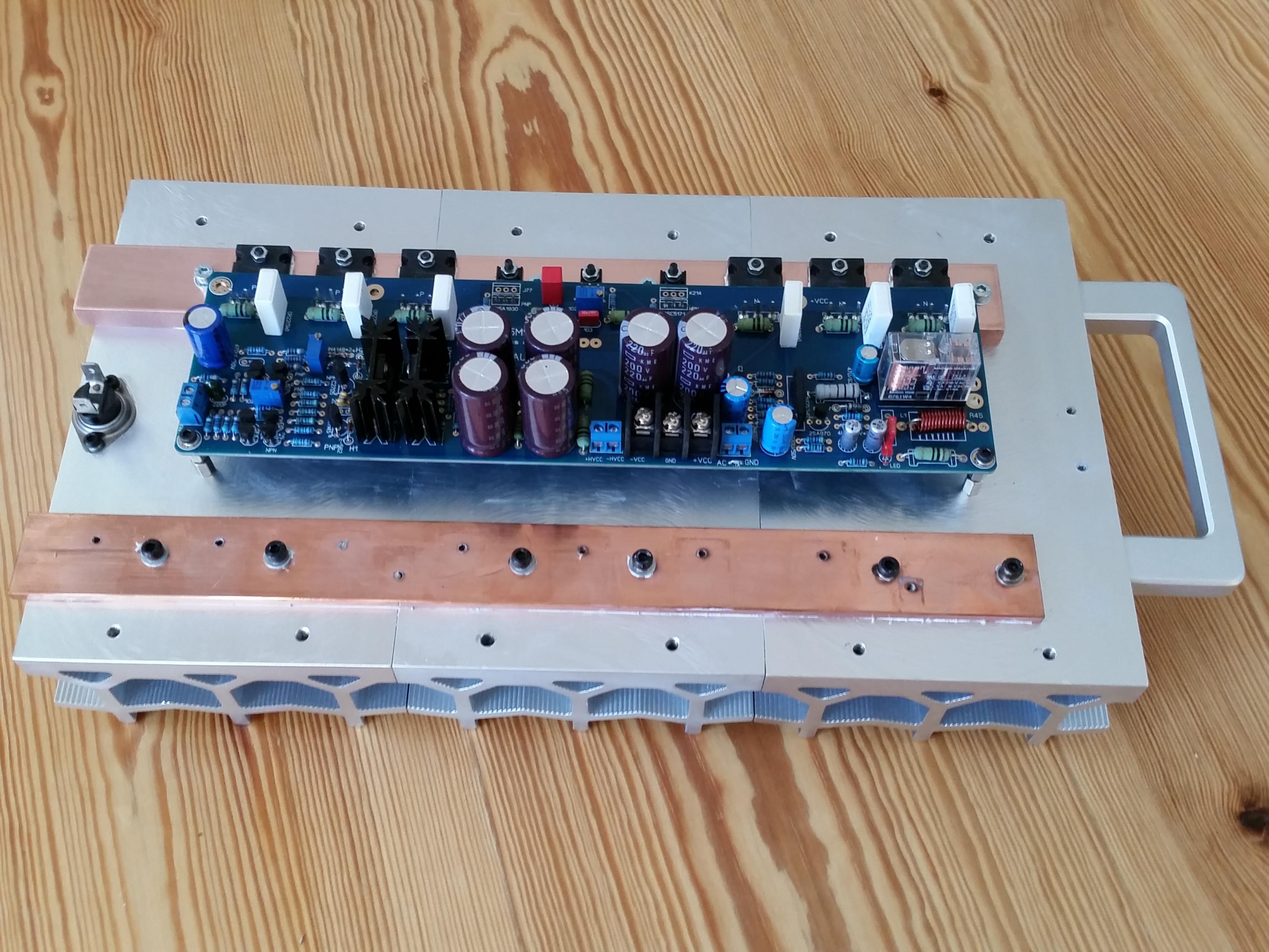

One I got so tired of that I built Krell KSA-100 boards in it.
I think this was an improvement from the Calaf circuit.

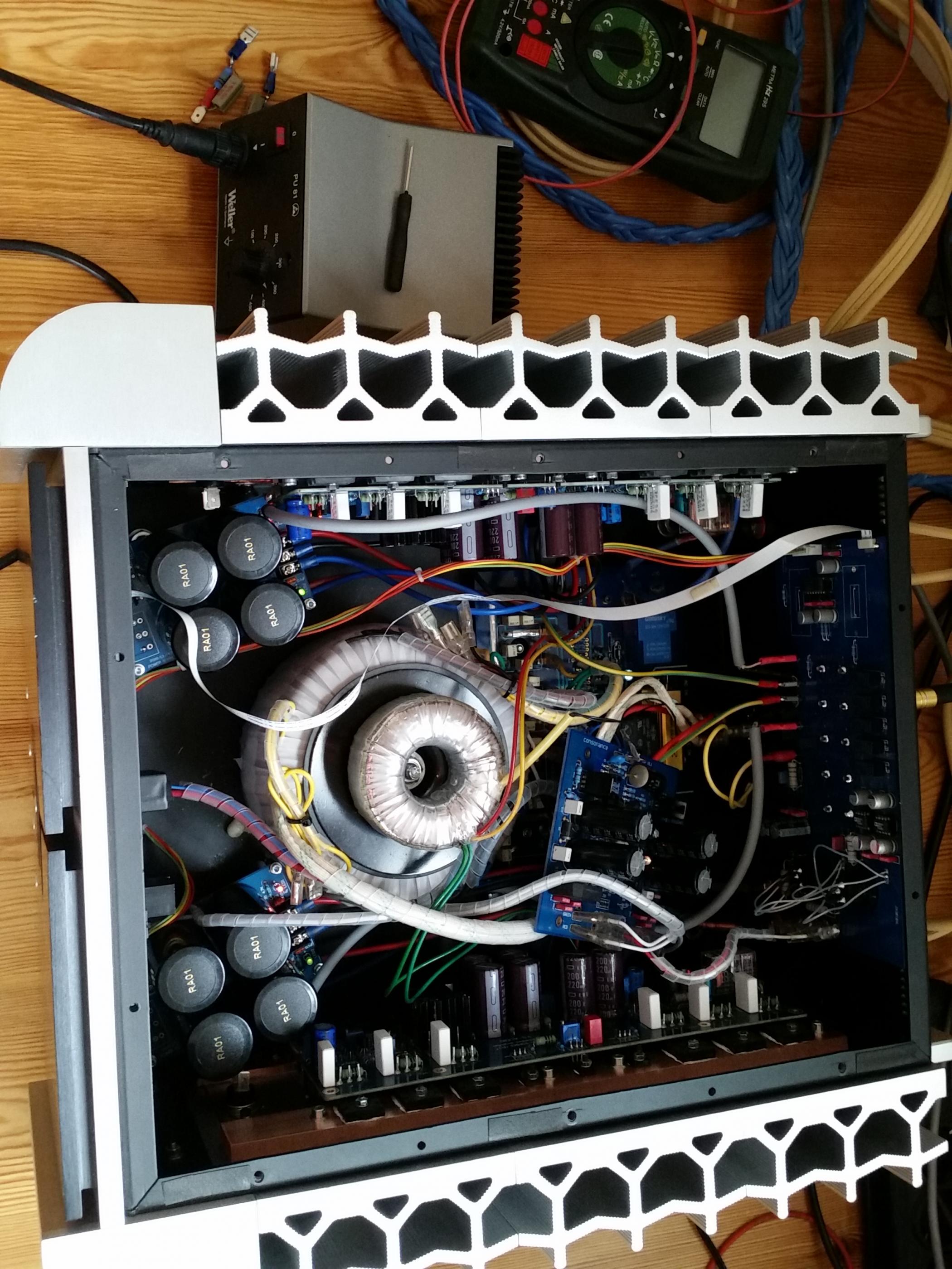

I'll try to post some photos of my creations too.
Krelaf Photos
Since the Calaf originally has the big caps on the current gain boards; other caps are hard to retrofit.
Thus what you see is a Krelaf which is a mess. I will think about moving stuff around and maybe removing the original DC protection, which is not needed anymore.
Problem is that the protection board also has rectifiers and soft starter on it.
One thing, that is really asking for trouble, is that originally the thermal switches will only cut speaker output an not power in case of over heating!
In case of an internal fault (and not overload) nothing is there to save the amp!
I have not yet modified this on my amps, but I would also never leave the room with them on 😉
