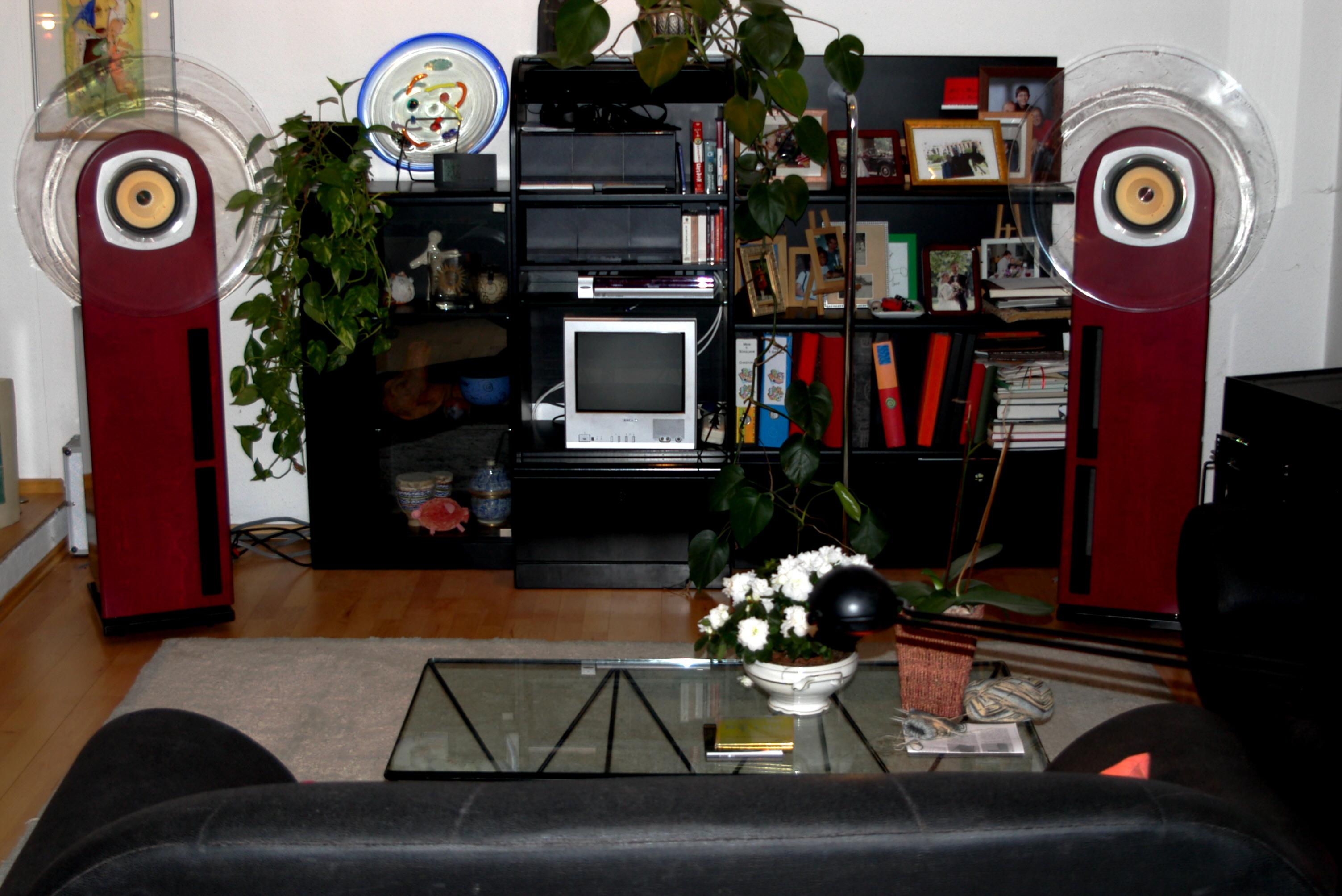

I have not build any Ripol subs myself, but cannot believe that reputable individuals and companies have just made all the data about the Ripols up.
One big difference may be the usage in relatively small european living rooms v. large american style living rooms. There seems to be a buble in front of the Ripol in which this sub is most effective.
There are quite a few reputable individuals who have used the Ripol concept successfully. Here is the Jazzman's example:

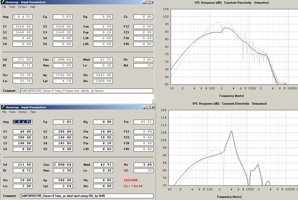

From my purely theoretical understanding the passive filter that reduces the 1st major peak after the passband is part of the basic design, and should not just be replaced w/ an active solution; but, Rudolf Finke has shown some measurements for what he calls the M-Dipol that show passive and active solutions, so that may be possible. The filter is important, and an integral part of the design.
Another problem may be the same cancellation that reduces the output of attempts at building all forms of small dipole sub(?)woofers. The ripol trades output level in the passband for low frequency extension. It is not a PA subwoofer of any kind. If the posted measurements are correct it is a true, but very low efficiency, subwoofer. Even lower efficiency than a standard H/W/M baffle dipole. It will, according to the literature, lower the in-box resonance frequency of the driver from it's free air Fs. This requires a driver with a slightly higher Fs, 27.59Hz should be OK. The driver will also need a high Xmax, or, at least a high Xmech.
Ultimately, you'll have to build and measure (or at least listen to) to get an answer.

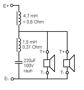

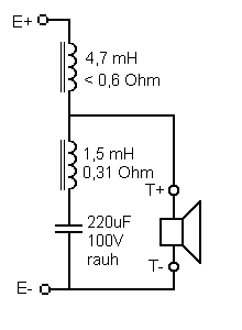

I'll attach a drawing (sketch really) of mine that was never build or tested. It has a few notes, and may be a starting point should you decide to give this a try.
I have heard, that the originator of this design, Axel Ridtahler, will answer questions (for free), and (for a fee) design system.

No doubt, his results seem to confirm bjorno's Hornresp simulation (as well as generally know data about open baffles). I have no problems with your or zobsky's expertise either, and the idea to make the basic plenum the same as the one in a PPSL is great.

The chamber resonance will occur at ~215Hz and can be notched and LPed with a passive filter.
Lser: 3.9-4.7mH, 0.25-0.3Ohm
LCR parallel: 1.0mH, 540µF, 0.25-0.3Ohm
With filter the base resonance frequency drops further down to 15.8Hz.
bandwidth limits (@1m,-3dB) 17Hz, 130-115Hz.
The impedance minimum at ~90Hz is 3,4Ohms wo filter and 2Ohms with filter.

Hi linaudio,
You can simulate open baffle speakers in Hornresp, see the attachment in Post #6. Hornresp has an Export AkAbak Script feature which will give you a basic AkAbak script to which you can add acoustic details and electronic filters (passive and active).
Well worth learning, even if it has a steep learning curve (I'm still trying).
Like zobsky, I'd would also appreciate any information you can share about your experiment.
