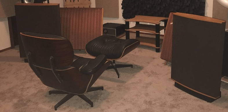

That is a very nice looking setup, but really impossible in my present situation. So yes, the 2-way cone approach currently seems most likely.Are you sure you dont have space for the Quad 57's? They would offer you a very high end listening opportunity with a mid-range that is remarkable, within the confines of not disturbing your neighbour with bass. Being thin they could be stored against a wall or in a closet and with castors on the base easily wheeled out for a sublime near field experience. Like this nearfield set up pinched from the net:
Back to a two way cone desktop solution then. A big issue with that is bass output. Bass from a little 4" is going to be anaemic no matter what the design, but if you use a sealed bass 40-250Hz the neighbours might complain and seem to hear more bass then you.

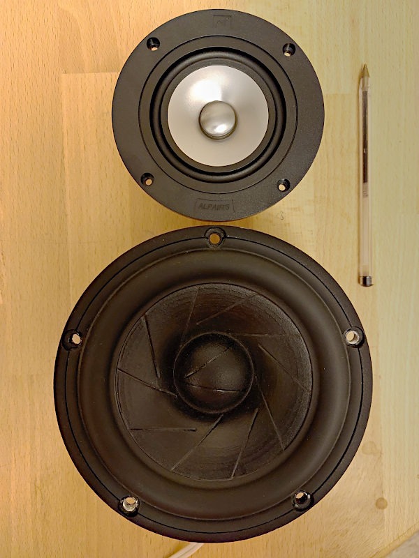

Anyway, the little alpair 5.3 drivers arrived, I thought that they might make the 15W/8530k01 drivers look undersized as woofers, but actually the 15Ws are still considerably chunkier, heavier and bigger so the pairing doesn't seem too bad for a compact speaker.
Though (in a relative sense) the two together are still reasonably large for being 'very' close up to the head. Having now seen them together in reality I suspect they'll feel better at a slightly larger distance - such as might suit a desktop arrangement for instance.
I shall also be keen to hear the little alpairs by themselves. I'm not imagining that they will be big enough (for my taste) to cross-over to subwoofers alone, but i don't really know; either way it will be interesting to see how far they do go. If I like what i hear then it might encourage me to try some bigger full-ranges instead of the small+15w combo.
Very much looking forward to this now; I realise it might be old-hat for many on here but I've always been a conventional multi-way person until now, so it is a voyage of discovery for me. Though sadly it may be a bit slow because i don't have a great deal of time outside work currently.
