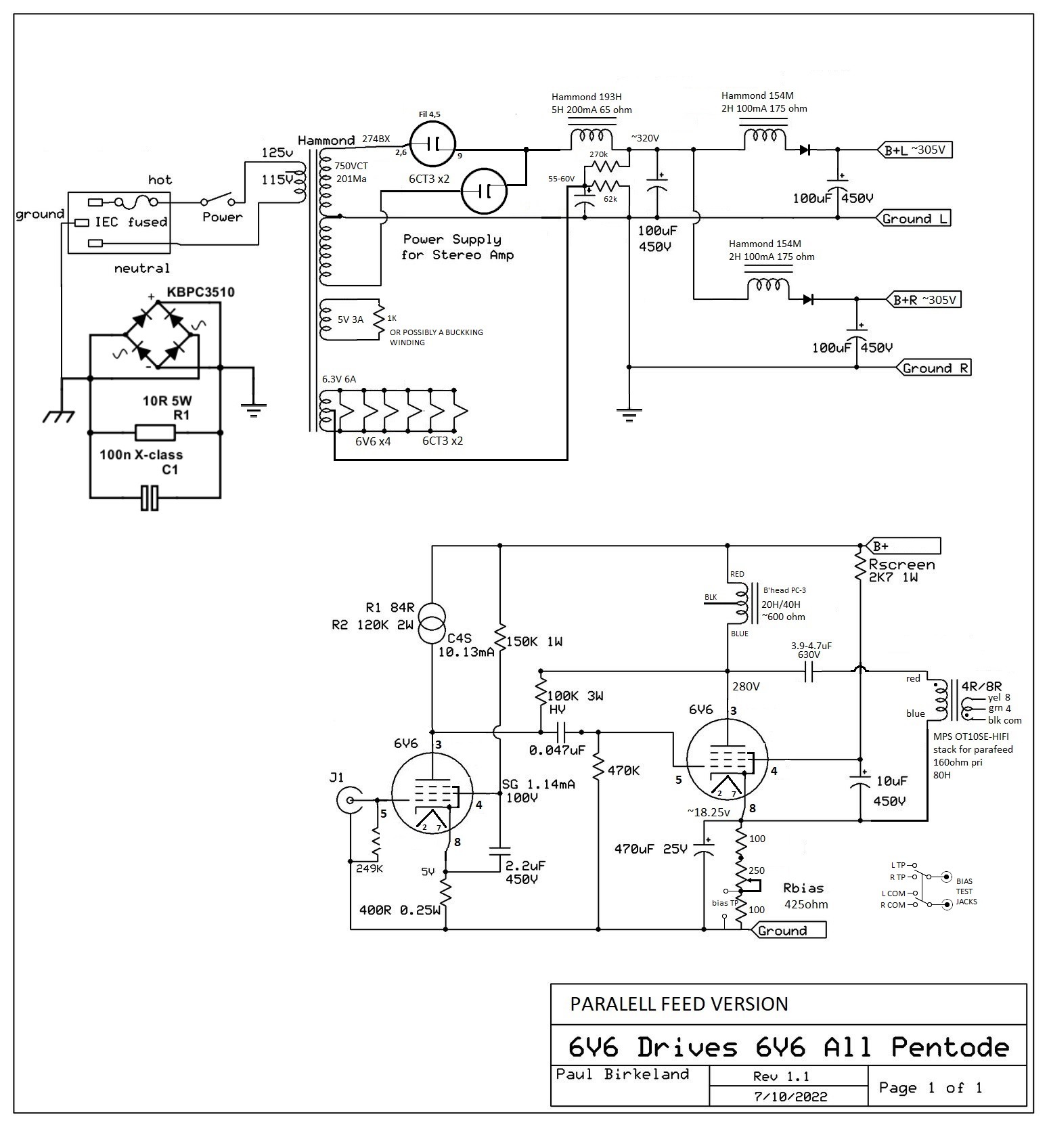

I can't answer all of your questions as I have no idea that reason for some of the issues. When I was planning this project it was suggested to me to consider parafeed. Matt was amenable and stacked the SE transformer as he would for a PP, i.e., alternating I's and E's without an air gap. I used a pair of 50H Bottlehead plate chokes. The project is on HiFiHaven and the plan belongs to others rather than me.
https://hifihaven.org/index.php?threads/sakuma-schade-6v6-amp.8961/
My project in the discussion begins around posts 189 and 192. This is the schematic for my amp. Paul B. was the instigator for the project.

The schematic in Post # 44 is very interesting:
1. Uses Schade Negative Feedback, with the signal coming from the junction of the output tube's plate choke and the output tube's plate.
I had never seen this method used with a Parafeed output (Parafeed Plus Schade in the same amplifier).
2. Using a 6V6 as the input tube, quite unusual. It is wired in Pentode mode.
3. The 6V6 Output tube is also wired in Pentode mode.
4. Something to try if you want to:
Disconnect the output tube screen, pin 4, from the resistor and capacitor is is connected to in the schematic.
Then connect a 100 Ohm resistor from the output tube screen, pin 4, to the output tube plate, pin 3.
That will allow you to listen to Triode Wired Beam Power tube Mode.
Less Power, and Less Gain.
So why try that . . . to get Less distortion, and Higher Damping Factor.
That might not work real well because of the Schade negative feedback, so you can remove the 100k Schade negative feedback resistor, and try
Triode wired mode without Schade negative feedback.
5. An amplifier output stage that is -3dB @ 20Hz due to the inductance of the choke in parallel with the output transformer's inductance, will be -1dB @ 40Hz. Many electric Bass Guitars only go down to 41Hz.
My loudspeakers do not really work at 20Hz.
Have Fun!

I appreciate all the suggestions. The amp sounds so good to me that I'm leaving it alone. It has lower measured distortion than a series feed version, the bass is really good for an SE amp (I'm not generally a SE fan) and the treble is airy and detailed without any harshness. The pentodes with the local feedback are a feature not a detriment and have a composite behavior like a triode but with pentode power. The amp is only 3+ watts so I'm not much interested in triode mode for this amp and losing more power. Sorry.

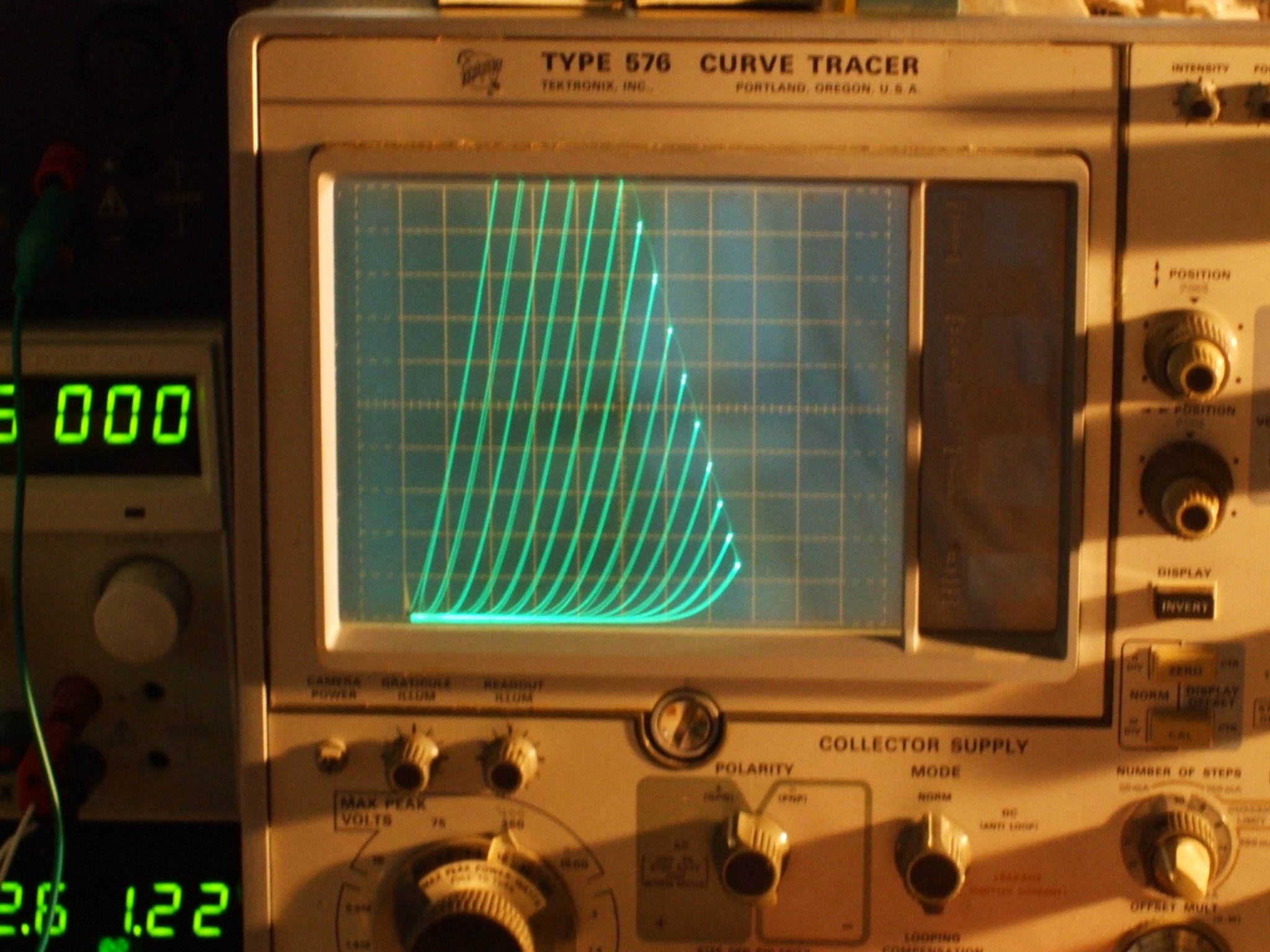

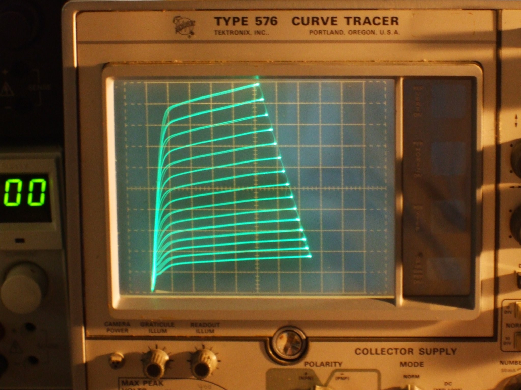

The 12HL7 pentode grid1 curves look as good as the grid2 curves. An amazing tube. Even -exceptional- in triode mode. Only 10 Watts though. Have to try some in parallel (with a diode to protect the high gm frame grid from +Vg1) Now that's a real sleeper for SE.
12HL7 in triode mode 1st pic: And 38HE7 in triode mode 2nd pic:
Sylvania designed the 12HL7. Some RCA versions have something else in them, a smaller assembly with poor curves.
I think Sylvania kept more space between grid1 and the cathode compared to similar tubes like 12GN7 and 12HG7 with their higher gm. The 12HL7 has "lower" gm than those two (still 21000 ! ). But was probably higher "yield" than the others (fewer g1 to k shorts).
I would check any such frame grid tubes on a curve tracer, since the smallest shipping "bump" could push the g1 off center from the cathode enough to mess up the curves.
I also wonder about the 10 Watt plate rating for 12HL7. The 12HL7 plate looks about the same as the 12BY7 6.25 Watt plate.
If one decides to derate the 12HL7 10 Watts to maybe a safer 7.5 Watts, then the 6197 7.5 Watt tube becomes competitive and it has a huge plate for a 9 pin tube.

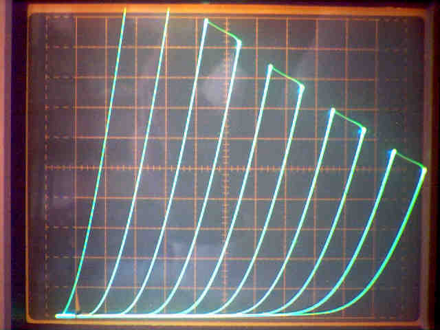

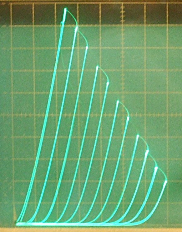

6197 is a computer tube (similar to, but not the same as 6CL6), but sure looks good on the curve tracer:
