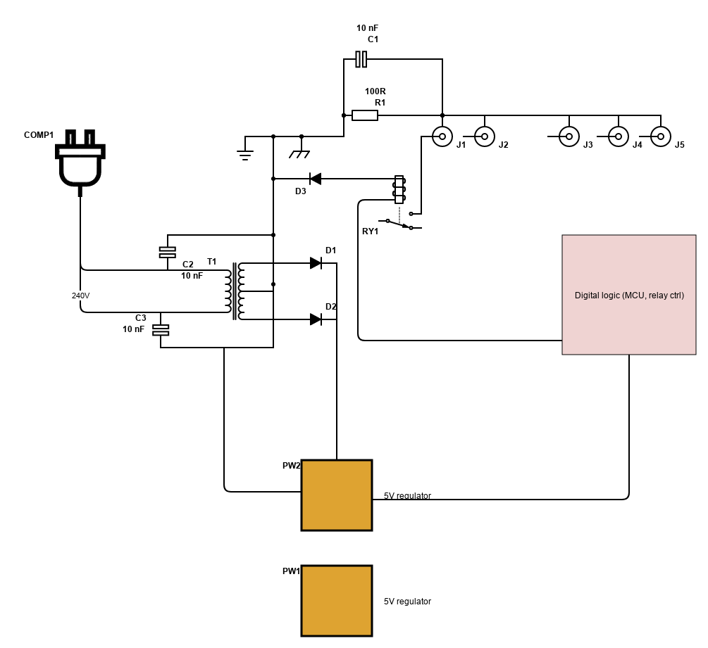

Would disconnecting the transformer secondary center tap from earth ground cause instabilities in any way? Would be interesting to try.. or should I try a choke or some fancy ferrites? I assume disconnecting ground would be pretty non-compliant..

I should note, though - chassis ground and return is only for the digital part, i.e. MCU and relay control. The amplifier itself has its own transformer that is not connected to chassis ground.
If I disconnected the digital section return from chassis ground, what would I risk? And why would they connect it together?

It is clear that the device has grounding issues. It is not class II. So PE should always be connected to chassis and that one should stay like that. Let's keep this a constant factor as safety is non debatable. That leaves Audio GND and Audio GND to PE connections of sorts as the variables.
I would like to advise on finding out every Audio GND connection and where they lead to. You already described a few peculiar matters. It would really help if you could draw a block diagram with all blocks and their specific Audio GND connections to be able to solve the apparent design errors. The pictures in post #35 show a GND strip connecting Audio GND directly to chassis, I put a question mark at that practice just as the secondary middle point of a certain transformer being directly coupled to PE at the same time! As popular it may be, connecting everything directly to PE with "safety" as the first commandment is not always good practice, on the contrary. It creates issues like you experience right now.
This device needs a proper grounding scheme. We can not catch design/grounding errors with just words, that is really not possible. For a true solution a drawing is needed, otherwise the thread will likely develop in a safety/PE opinion contest and possibly a "manufacturer knows best" (in this case clearly NOT) blah blah affair. Any external solution is not a solution but a band aid. It is a pity you are probably far away as matters like these are a nice challenge to solve 🙂 My fingers itch.

jean-paul: Very interesting, and thank you for your insight! Yes, a block diagram is a good idea. Much less initial effort, and I can increase the detail as I go :yes:

Hello again, I'm back.
Did a quick drawing of how it is wired up. There are omissions (reservoir caps, for instance), but the grounding scheme should be correct (I think) - although I am scratching my head quite a bit. I had to find some software to draw this, so it is a bit crude. I will improve!
Now, there are, as said, pieces missing. For example, there are two 5V regulators each getting 12V. But one of them seems to get power from the other monoblock, and another delivers power to the other monoblock - so there is some kind of interconnection here. It might be that the regulator feeding the MCU gets power from the other monoblock, but they are wired the same, with same transformers, so for all intents and purposes, it should be the same (?).
Hope this helps.
