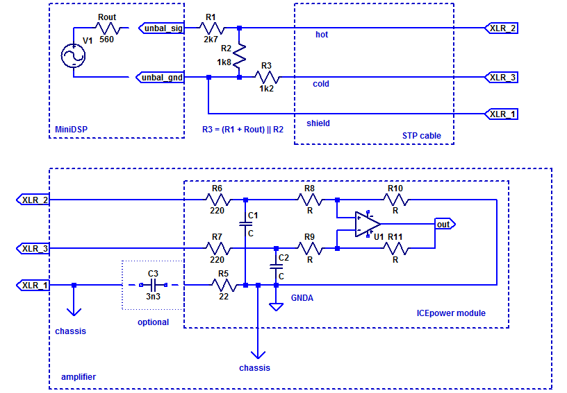

I know you have already put more work into this than i could ask for sgross, but you would do me a great favor if you could update the resistor values with your best guesses to take the input impedances of the 100AS2 and 200AS2 respectivly into account.

It would be great to see if this could be solved without adding more complexity and cost.

Will the current resistor-values in your sketch be wrong then because of this input impedance mismatch?
Yeah, kinda. You can basically use balanced connections but different impedances on both legs, but then output impedance has to be different as well. Also, performance would degrade at higher frequencies because parasitic capacitance of hot and cold are (roughly if not 100%) the same.
What is the effect of bad impedance-matching?
Bad common-mode rejection and as such higher sensitivity to ground loop issues.
Could these problems be solved with an input buffer?
Yes! Much improved, at least. Input impedance is a bit on the low side otherwise anyway.
The 200AS2 datasheet shows how this is normally intended to be used, with the lower-impedance "cold" input serving as a ground sense for an unbalanced input stage. They're not saying how to interface a legit balanced input. I guess you could connect a balanced receiver just the same (always an opportunity to get the gain down, too!). Seems a bit silly to go balanced > unbalanced > balanced, but hey, it should work.

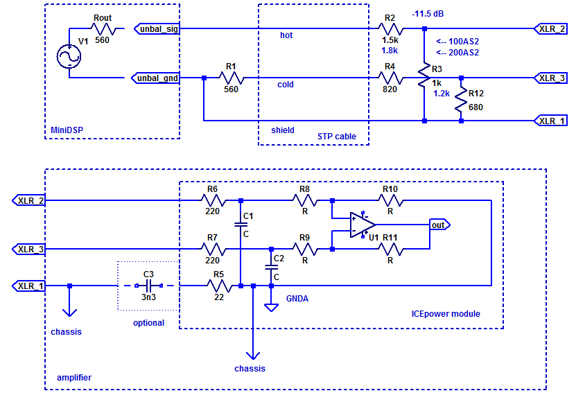

Here you go:

I have soldered it up and tested it now, and it works great. The noise is reduced by more than the 10db attenuation. It's all thanks to you sgrossklass, I truly appreciate it!

If i understand correctly, ideally the hot and cold input should see a similar impedance to optimize noise rejection. Primarily (or only?) noise picked up by the cable. However in this case the cold side should see a slightly lower impedance because the amplifier input is actually lower impedance on the cold side.
These amplifiers are now being used for the speaker it was intended for, so i no longer need the attentuation. I just need to connect the miniDSP to the 100AS2 and 200AS2 without inducing unnecessary noise or distortion. The cable length between source and amplifier is around 15cm. Do i need resistors at all in this case?
