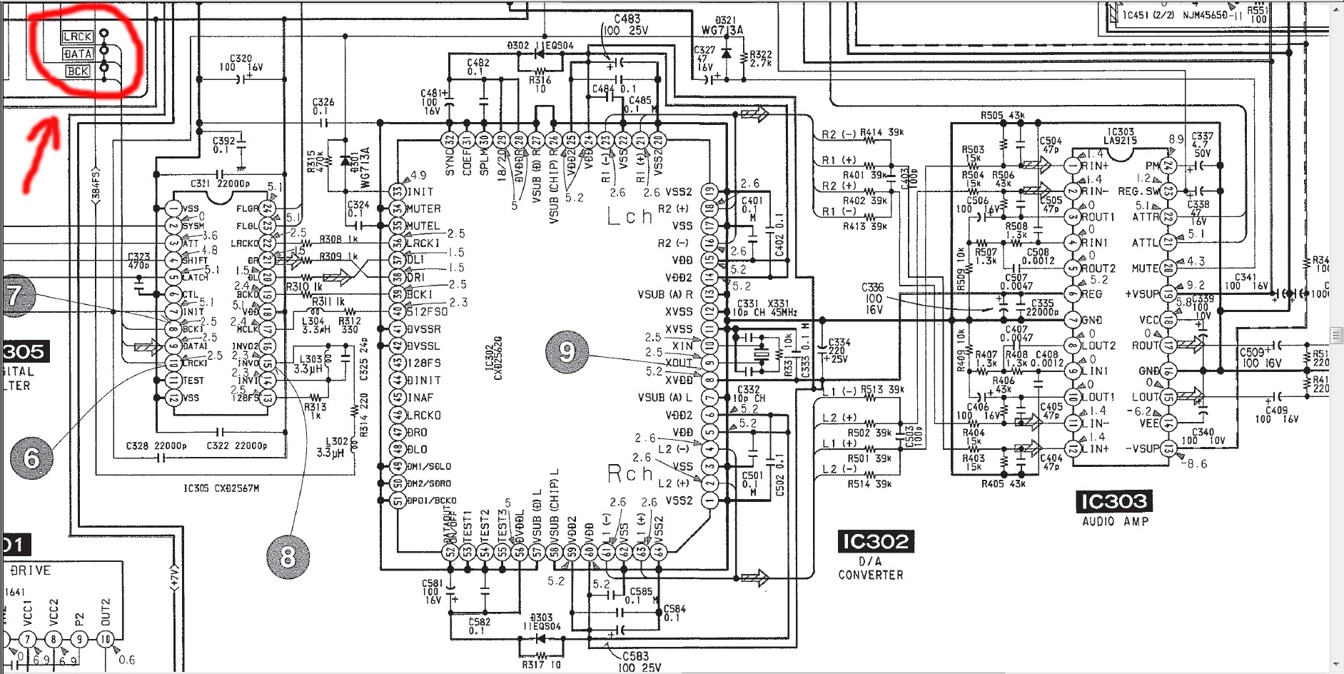

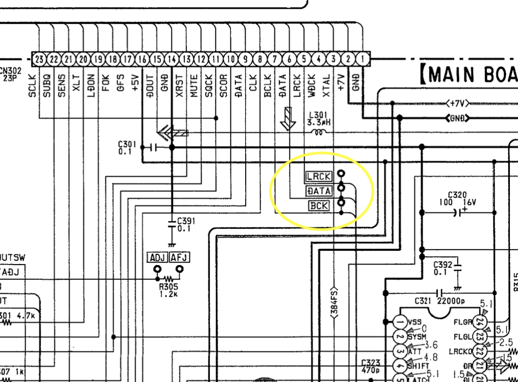

Hey guys! There is a board from Sony CDP-515. I want to connect it via the I2s bus to the media player and use it as an external DAC. Who can tell you where to hook the MCLK wire? Maybe someone has already experimented?

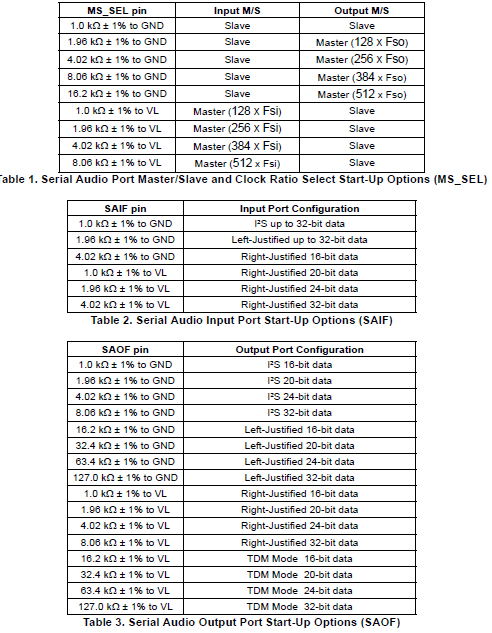

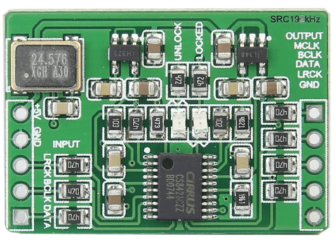

If nothing else helps, you could use a ASRC board with CS8422. Very convenient and cheap little boards where you could set-up all 3-wire input and output formats with only one (two) resistors as you need.
Even without studying all the datasheet, it takes you only the correct input/output wiring, a handfull of 1k 0805 resistors (even better if you have 2k and 4k also by hand - you just combine them as needed) according to the table attached.
Well, maybe you should read the CS8421 datasheet too 😉
Edit: output sample rate (=MCLK) depends on the crystal oscillator used. Get an 11,286MHz XO for 44,1kHz to fit almost everthing. Some boards had 24,576Mhz installed while others I received with 27MHz (~217kHz).

something i wrote for my CDP-X303ES USB DAC conversion in 2019, that configures the cxd2567m+cxd2562q:

I2SoverUSB v.III also connects in place of old 45Mhz XTAL.
i still use this modded CDP to this day
