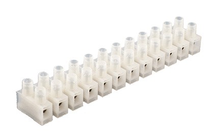

Koja has offered you an alternative solution. I was avoiding suggesting it, since it is not optimal and can alter the response of the loudspeakers.
However, I have used this method to protect a hi-fi amplifier when working with low impedance car speakers.
The solution involves wiring a 2 ohm resistor in series with the each of your 6 ohm speakers as shown in the above diagram.
This effectively makes your 6 ohm speakers look like 8 ohm speakers as far as your amplifier is concerned.
For your 25W amplifier, you must use a ceramic resistor with a power rating of at least 10 watt, like the one shown in this link:
10 Watt 2 Ohm Cement Power Resistor
The 2 ohm 10 watt resistor will get warm in use, so make sure that air can circulate around it.
You can plug one end of the resistor into the red terminal of your amp and connect the positive speaker wire to the free end of the resistor using a section of terminal strip - if you are not into soldering (see attachment).
Do this to both speakers and you will have two, effectively, 8 ohm speakers for full stereo use.
