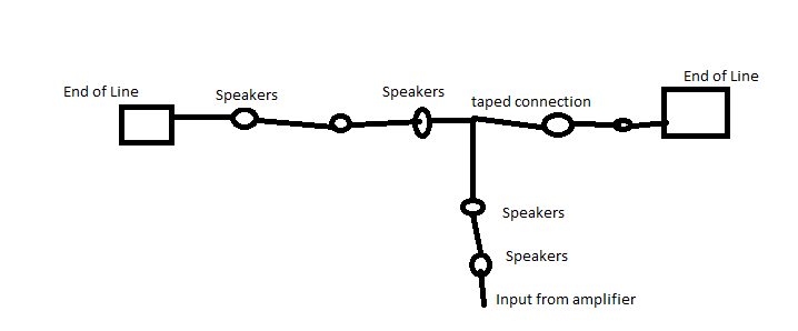

I have layout with 2 end of lines connected on single 100v channel or line as per attached image with multiple speakers. My question is is it work? and if this works then How?

All the speakers are 100v line transformer type, then all would be connected in parallel, that is positive wire to all positive and all negative to negative. This is at the transformer located on the speakers.

The end of line thingies to not work if you put two in parallel. They present a certain load at 20 kHz which the amplifier can measure, if I understand the description correctly. If one line is broken, the other line still presents the load to the amplifier and the amplifier thinks everything is working. Put it on the branch you want to be sure is working, the other one will be unprotected.
What do you mean with 'taped connection'?
taped connection means I'm taking wires out from single line by connecting in parallell
