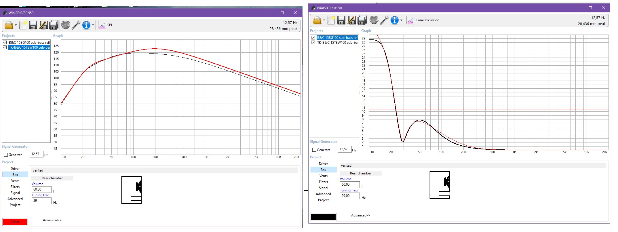

I've attached screenshots of some simulations with Win ISD with my 60L cabinets
I used the advisable tuning ( 40HZ for 15TBW100 / 29HZ for 15BG100)
so please ignore the projects Names at top left they mention a wrong tuning HZ
B&C : 15TBW100 (Red Curve)
B&C : 15BG100 (Black Curve)
- Starting with the Transfer function magnitude, I understand this is about linearity, but I can't tell if I have to rely more on this curve for a good judgement about lower frequencies response or on the SPL Curve ? 15BG100 seems to have much more output , but in the MAX SPL curve ( 600watts the amp can handle) things are different : (15TBW100 hits higher down to about 32HZ, then 15BG100 takes the lead.
- Excursion wise 15BG100 runs much safer near to 20HZ.
Note : I did another simulation by tuning the 15TBW100 down to 29HZ (much lower than its FS), & the two curves are superposing (SPL & excursion) with an advantage to the 15TBW100 at the higher bass region.
don't know if this is advisable to do in practice 😕

When you are modeling a driver in WinISD you have to keep an eye on cone excursion and port air velocity, use the Signal tab to enter a desired power level and then check cone excursion and port velocity, ignore the Max SPL graph it's technically impossible to achieve. If air speed goes off the chart port size has to increase, you want max port air velocity to be around 17-20m/s. You can also add a high pass filter to see how that affects output, the "perfect" high pass produces a double hump graph with both peaks at the drivers xmax.

I still believe the 15TBW is more attractive for its higher displacement air volume, XMAX threshold, & power handling & still want to tune it lower, like the 15BG100 ( around 29HZ) don't know if it is duable, many statements that is not advisable, still can't understand why not ?
this way I will have a little Xmax trenspassing below 30HZ & mostly can ignore the high pass filtering to protect the drivers + more SPL at the low FREQs.

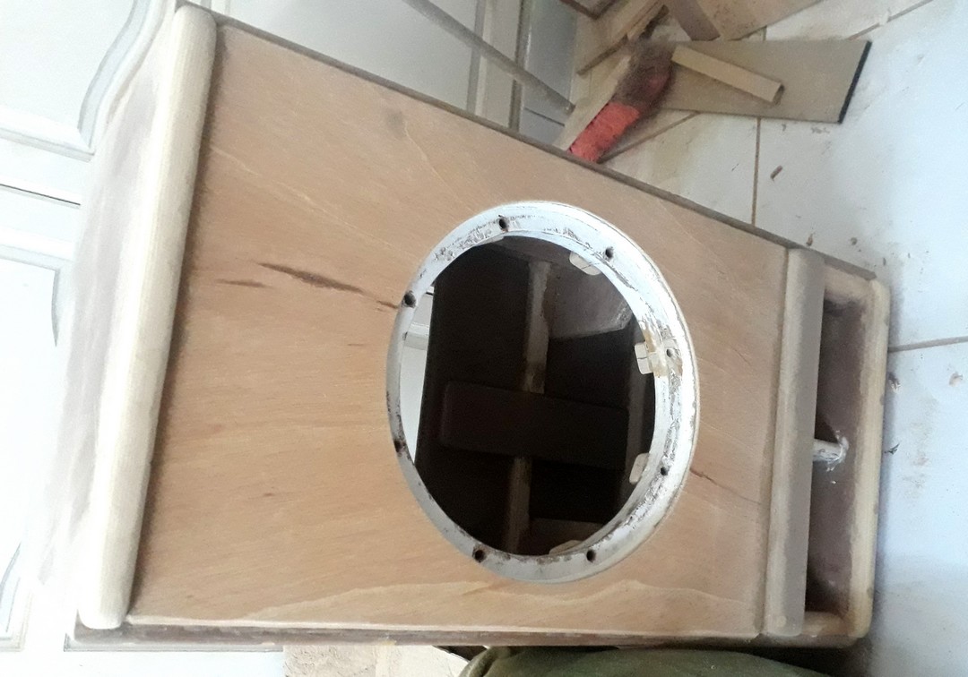

Concerning the port, it is build this way (attached picture) & it is actually 39x10cm (about 45HZ) remember it is originally designed for 12" faitals & I still can modify it to 4x Tube ports for lower tuning & lower air velocity, I'll attach simulation captures later.

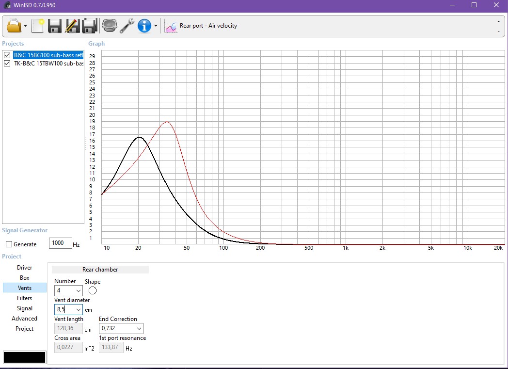

- Actually the box has a big port on it : 39x10CM that I can modify for much lower Tuning, which I'm planning to do with 4 Tubes & attached you can find simulations for the two Drivers/Cabinets air velocity comparison.
- I'm trying to find the best solution without using a high pass filtering , I think I have two choices :
- 15BG100 has almost no need for high pass since it gets a little overexcursion near 20HZ, & it hits higher at the lower frequencies, although it has less power handling than the 15TBW100 ... not a big concern since for two drivers my amp can deliver a max of 600 watts RMS per Driver.
- 15TBW100 is a better Driver overall, still , If I tuned it lower than its FS I mean 29HZ instead of 40HZ, I'll get almost the same response as the 15BG100, with same excursion & same air velocity (in theory).
what would be the effects of 29HZ tuning of the 15TBW100 ? on the graphics it shows it act almost like the 15BG100, if there is no constraints then I'll choose the 15 TBW100 with no hesitation. costwise, it is the cheaper option here.:$:
