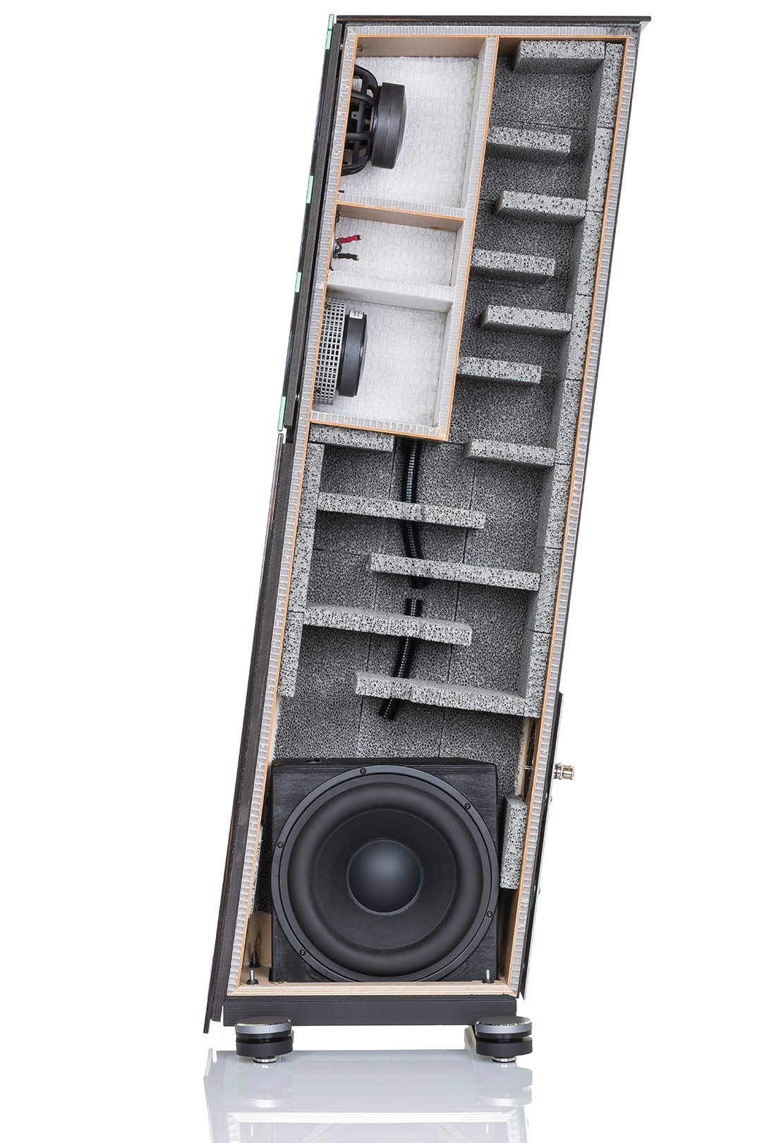

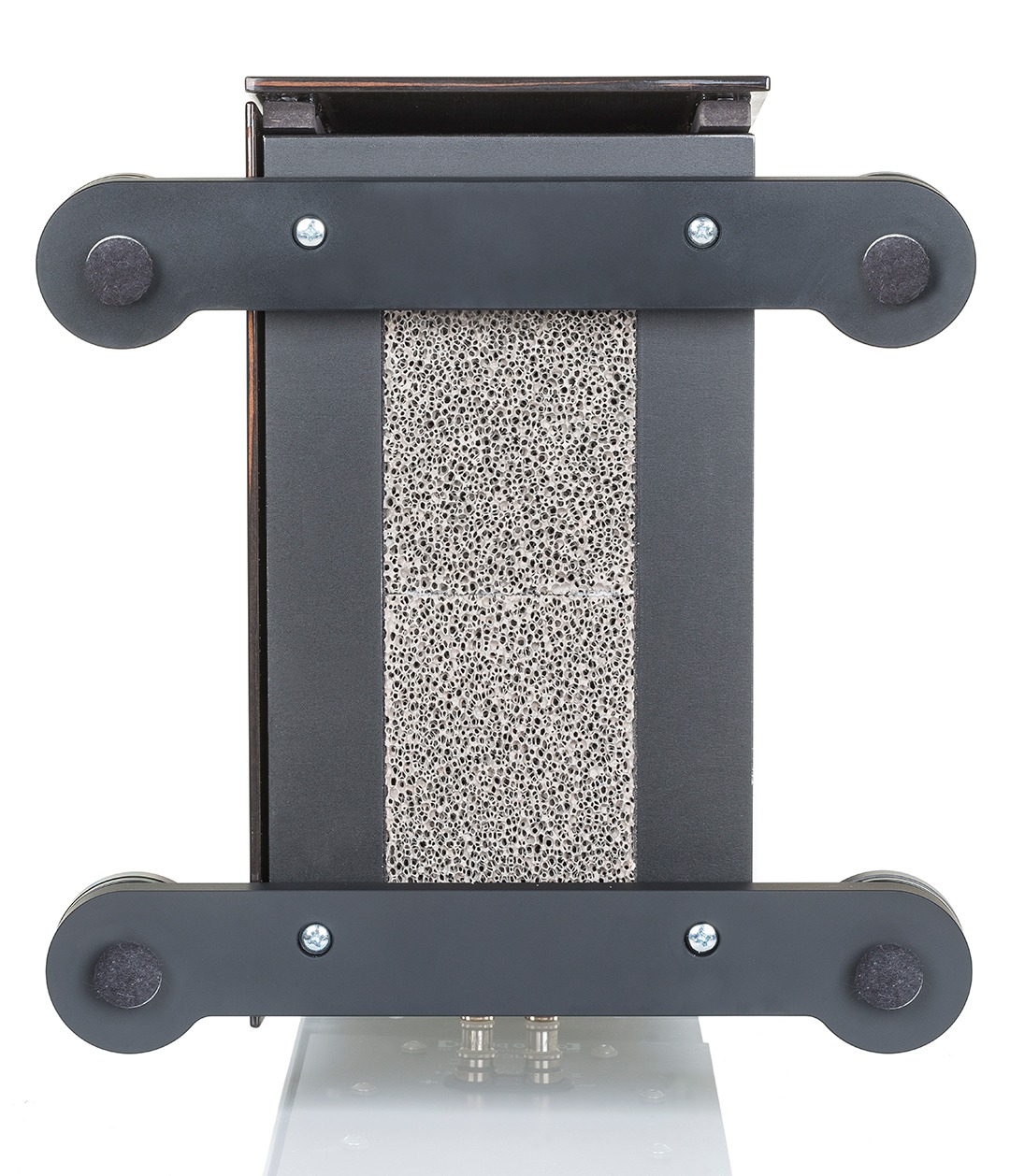

- To anyone reading who does not know what Variovent or Aperiodic is.
The Variovent is a term or product by Scan-Speak and belong to Aperiodic class of loudspeakers.
Aperiodic woofer systems – The aperiodic loudspeaker is a closed box system that contains a vent stuffed with damping material. The stuffing, usually foam or fiberglass, provides a pressure release for the system at low frequencies. The term aperiodic literally means an absence of resonances at any specific frequency or multiple thereof. Aperiodic damping is defined as “damping of such a high degree that the damped system, after disturbances, comes to rest without oscillation or hunting” (Turner 1988). In a standard acoustic suspension system, the trapped air in the box is quite reactive, or springy, at very low frequencies. The reactive nature of the air will cause excessive cone excursion at system resonance. Adding an aperiodic vent to the system releases internal pressure at resonances, resulting in better control of the cone motion at very low frequencies. The aperiodic offers some of the performance advantages of the transmission line in terms of excellent woofer control and a reduction in internal pressure at frequencies near system resonance, but with enclosures much more manageable in size. It is important to note that no sound emerges from an aperiodic vent, so this design does not resemble a vented loudspeaker in any way. The first patent on such a loudspeaker enclosure was issued in 1936 to Marvel W. Scheldorf, an engineer from RCA; he described his invention as an acoustic resistive device.
Thom Holmes - The Routledge Guide to Music Technology
Audio Concepts Inc. explain their APL: “Performs Like a well-Tuned Transmission Line but with Superior transient Performance and Control”
Further, Audio Physic uses ceramic foam as their acoustic resistance. (This foam is usually used in metal casting to remove slag, so not an audio product per say)

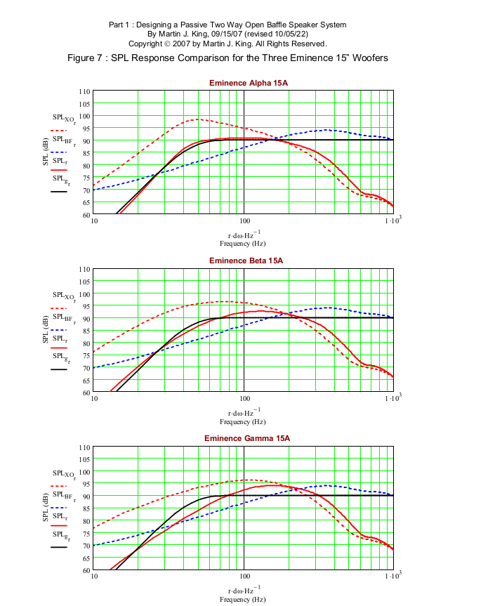

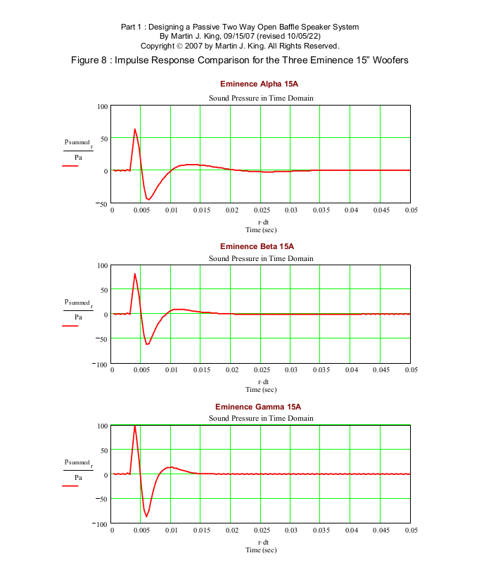

My HIGH Cms comment was specifically targeted at a midrange with a high-pass filter well above the driver's Fs. It wasn't specifically in regard to open-baffle (Free-Air) or any other loading design: in other words if possible you ALWAYS want a HIGH Cms for your midrange (all-else-equal, even though it NEVER is) IF you can get it (respective to other design limitations). Likewise you ALWAYS want a LOW Rms for your midrange (under the same sort of conditions). Basically it's something on a wish-list balanced against other driver attributes and the design itself (notably it's high-pass filtration relative to the driver's Fs/Fb).
A few extra things to note:
The electrical side of the driver (Qe) typically dominates with respect to losses & damping of the driver (primarily around resonance), unless the driver's motor is really weak. Further, resistance can be added to the driver (in series) which will weaken the motor's result and raise Qe and Qts.
By "dominates" I mean that as an overall value Qes typically "sets" the result for Qts - or basically Qms is far less relevant with respect to Qts with most drivers.
Qe/Qm & resulting Qt are all generic results, and I wouldn't put to much value in them, particularly not with respect to just a single driver in an overall design of multiple drivers.
