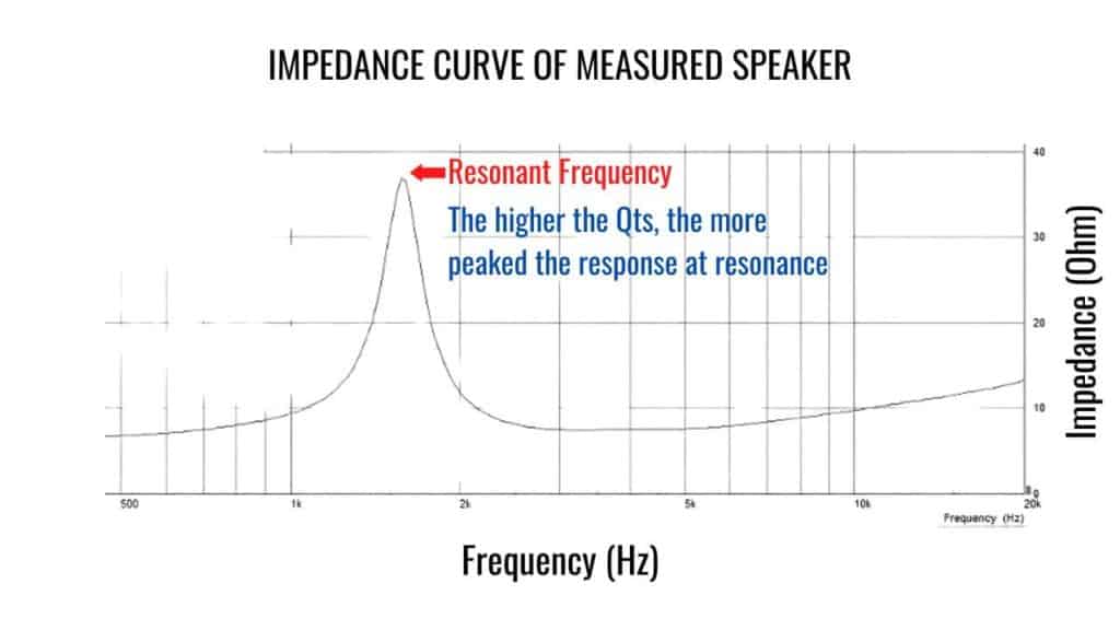

In the context of speaker impedance curves, the Total Q, (Qts) is a measure of the sharpness of the driver’s resonance peak. Total Q (Qts) depends on both the mechanical and electrical characteristics of the speaker. Total Q (Qts) is calculated from the electrical Q (Qes) and the mechanical Q (Qms).

Speaker Q tells us how well a speaker is damped. A high Q value will tell us that there is low system damping. Damping is the dissipation of energy in a system over time. In the context of speakers, it is the control of the resonance frequency of the speaker.
A high Q factor means that there is a lot of resonance (the speaker is not well damped or has low system damping) and a low Q factor means that there is little resonance (the speaker is well damped). If the Q of a speaker system is too high, then the sound will be harsh and fatiguing. If the Q of a speaker system is too low, then the sound will be muddy and lack detail.

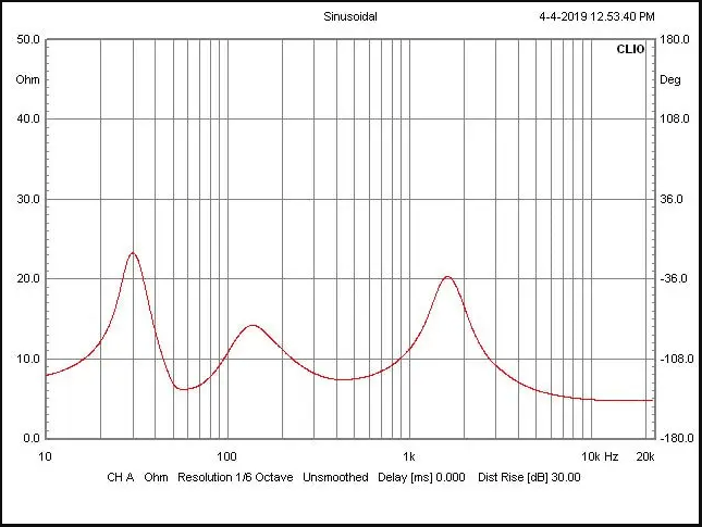

As an example, If we stop and look at the values for GR Research drivers, we can see, that spite being used in open air, the T/S values, specifically Qts and Qms, signify sealed enclosure. We do see a difference between the woofer and midrange were the midrange signify open air capability more than the woofer counterpart, which is a lowish Qts. Is this telling us something ? ...
When I look at GR Research NX-Otica and the impedance sweep, I can see that the XO between the midrange and woofer is 150Hz. This peak is 2 octaves above the Fs of 51.7Hz, and so tens of ohms is not an issue here.
Balance, its a balanced design as I see it. You don't want too high of an impedance at Fs, and further, it might tie into how we perceive sound (Fletcher-Munson- or Equal-loudness contour). With an open air design we don't suffer the box or bass-port effect on the driver, making it sluggish in the bottom end, which is evident in the time domain (Cumulative Spectral Decay). By getting away from the "boominess" or low frequency glare, the penalty is far less and the low end is perceived as cleaner and thus, we end up with a superior transient performance.

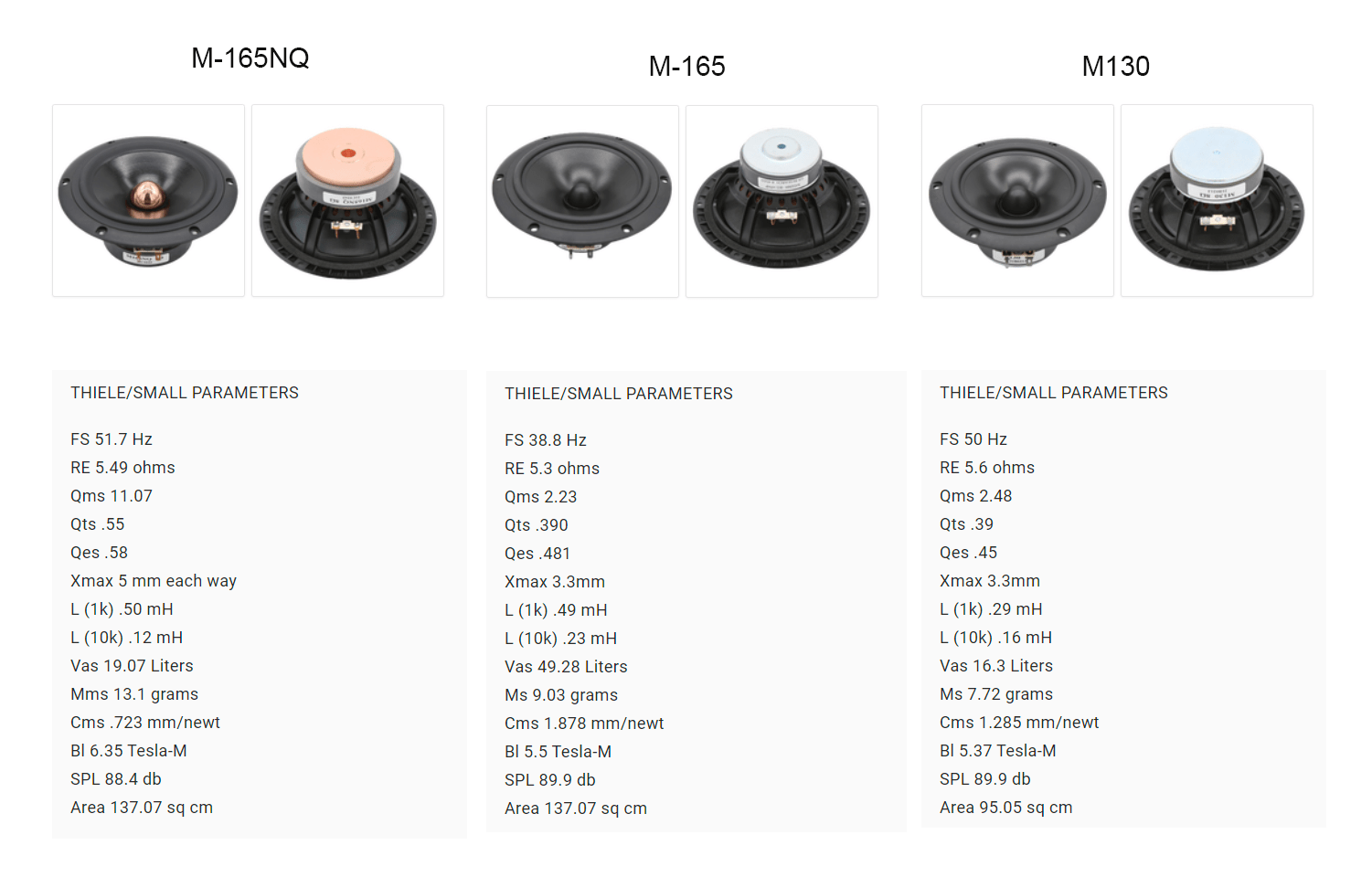

Troels Gravesen's JA-8008 HMQ 8" has a Qts of 0.6 and Qms of 10 with an Fs impedance of 240 ohm .. Cms is 0.66mm/N but not relevant.
Danny Richi's M-165 has a Qts of 0.39 and a Qms of 2.23 with an Fs impedance of roughly 23 ohm .. Cms is 1.877 mm/N but not relevant.
