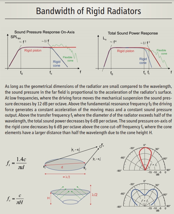

An ideal infinitely stiff cone will have a cancellation null on axis when the distance from the bell of the cone to the base of the cone is equal to approximately 1/2 wavelength... this is simplifying it somewhat, but basically this is when it starts. Off axis it is more complicated and it starts at a lower frequency. The deeper the cone profile, the lower the frequency when this starts.
For paper, pulp, and polymer cones, this may not matter much because the first mode resonance will probably be lower than the start of the cancellation null. If the cone is not moving in unison as a piston, there may be little cancellation null.

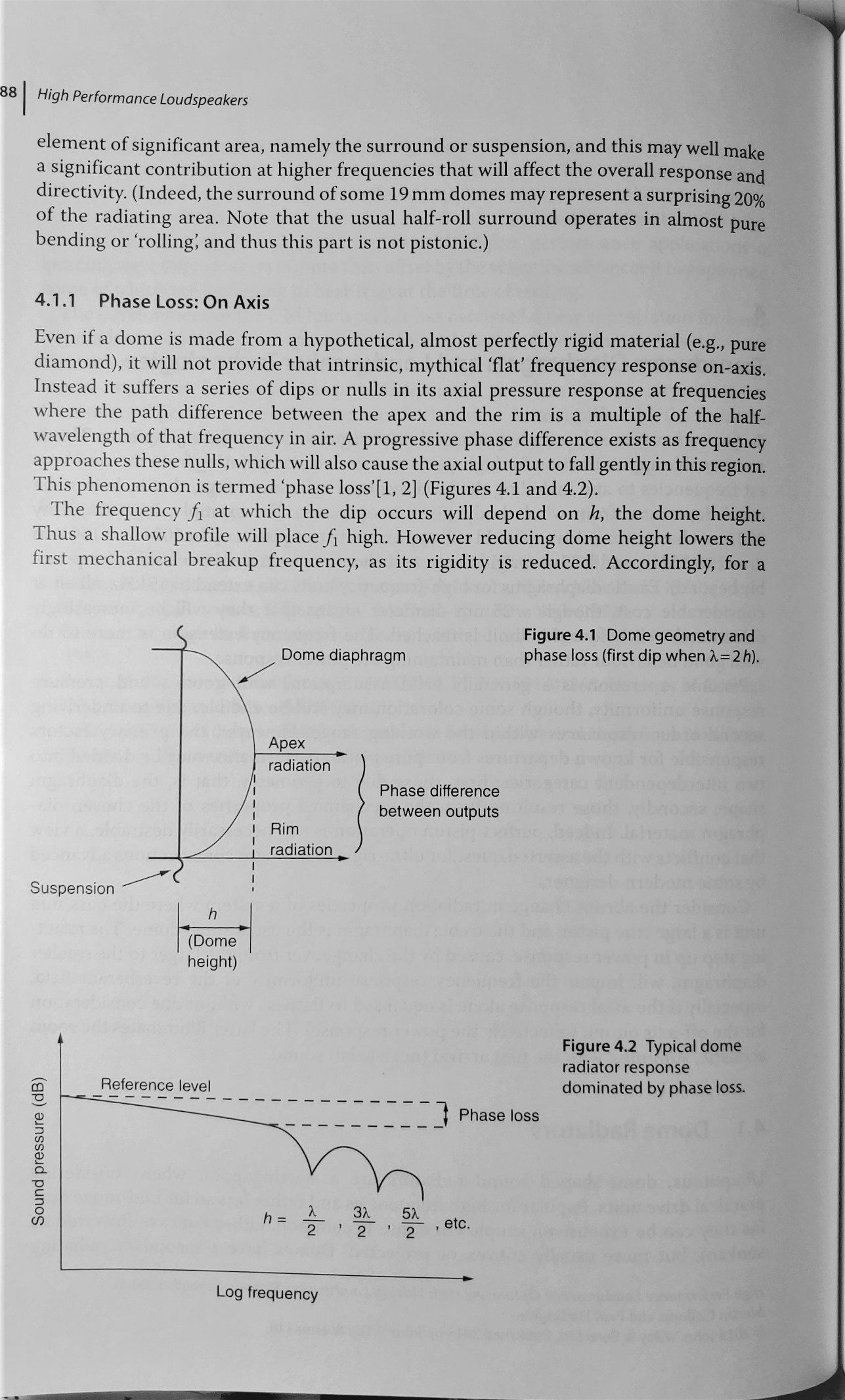

Do you have a link describing this?
I remember reading it somewhere, perhaps in a paper. The closest I could find is a section in this book which is describing hypothetical dome diaphragm behavior. The same principle would apply to cones.
"High Performance Loudspeakers" by Martin Colloms, 7th edition, 2018, John Wiley & Sons Ltd. Page 88.
For normal practical cones, this consideration is pretty esoteric: almost all cones will reach first resonance breakup before reaching the cancellation null. Even the SB17CAC35, which for a 6.5 inch driver has an amazingly high first mode of 7 kHz, the cancellation null is around 6.5 kHz (based on my estimate of cone depth).

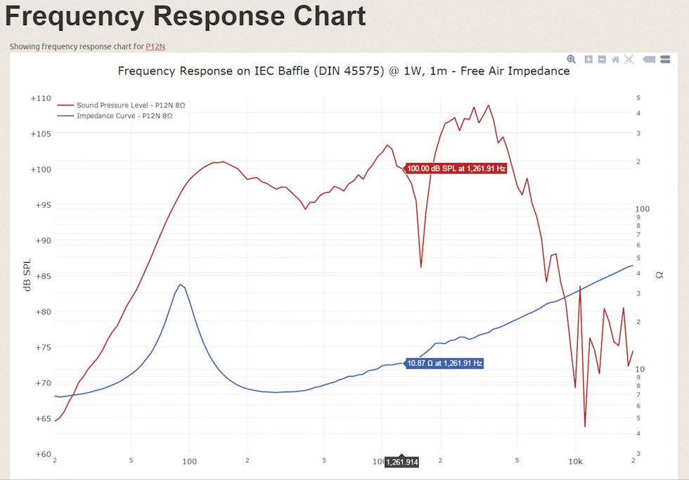

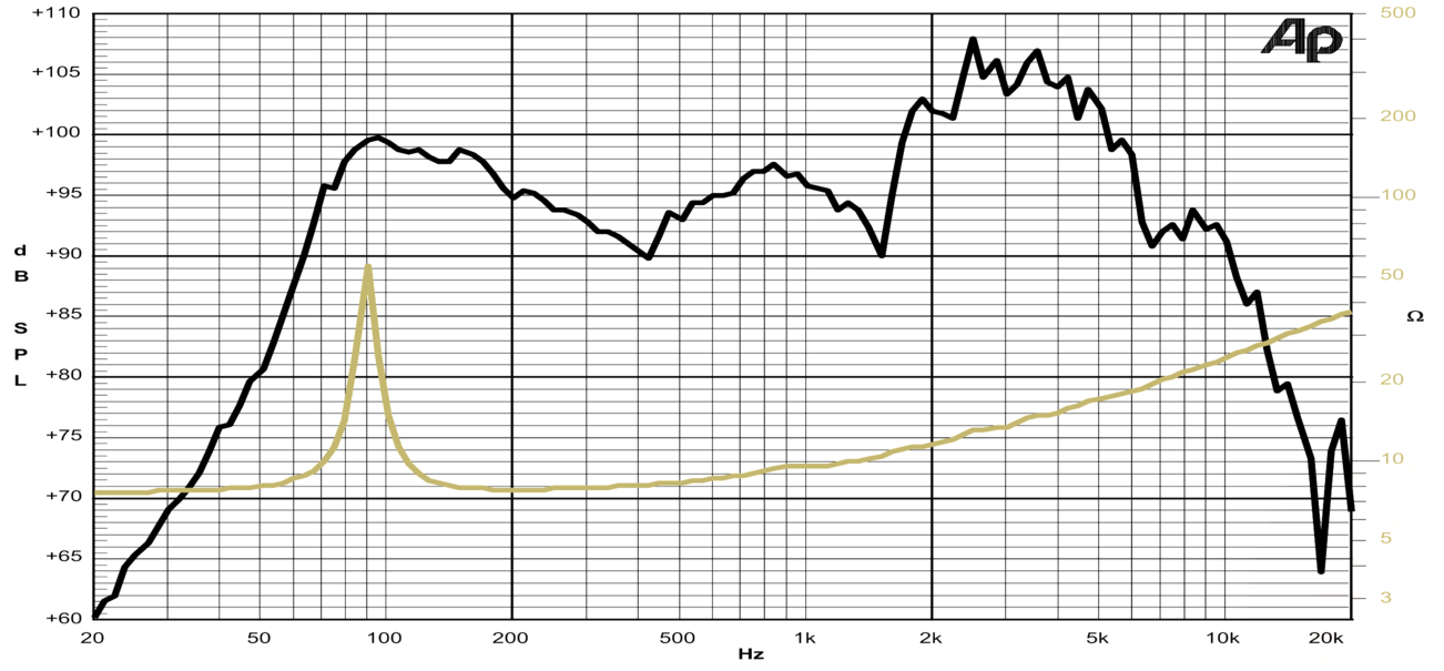

I can offer you something better: frequency response curves *showing* it 😀
Not often clearly seen in the Hi Fi World because speaker cones are either too thick, which dampens it, are crossed over below that critical frequency , or both, BUT an unavoidable fact in Guitar speakers, where cones are very thin *and* are used "full range" , meaning no crossovers or tweeters.
*All* 12" Guitar speakers, no matter which brand, type, "American" or "English", old or new, show the same distinctive 1200-1500 something Hz dip caused by flexible "wave", I am not talking acoustic "air" wave but the flexible whip type one reaching cone edge and being reflected back towards voice coil causing a deep notch.
Edge impregnation with a thick flexible paste which never hardens dampens the effect somewhat (it´s the difference between doped and undoped cones) but never kills it:
Celestion G12T75:

1950's style (Jensen P12N) undoped, underdamped/high Q (weakish Alnico magnet), paper thin cone, showing that dip in all its glory:
