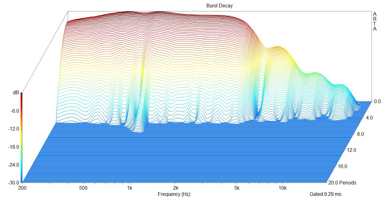

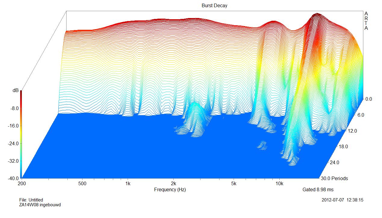

How about some pics from the cellar. I dusted them off carefully. Subject: the ZA14 an otherwise very nice metal cone which has a nasty breakup mode at 9kHz. Measurement: periodic pink noise on ARTA, close range mic. Plot: Burst decay, which essentially shows any resonance.
The first plot clearly shows the resonance at 9k. Not only in amplitude but also in time: like a bell, the cone produces sound quite long after the electric signal is gone. After 24 periods, which actually is 2ms, the decay level is down 32dB. Anyone care for a discussion about if one could hear the delayed sound?
Mind you, other effects (1,7k, standing wave in the cabinet, and a diffraction effect from the cone edge at around 4k) are visible too.
The second plot shows the effect of the applied filter. 3d order lowpass and a sinkhole on 9k. Back then I used a cap and a resistor parallel to the series coil.
The 'ringing' due to the coil and cap above 9k, combined with the resonance itself is down some 40dB. And since my ears aren't that sensitive, this is perfectly OK.
Conclusion: resonances in metal cones can be treated. But only way out the passband. I'd say your average lowpass frequency should be 1/3 of the resonance frequency to be perfectly sure.
