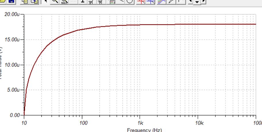

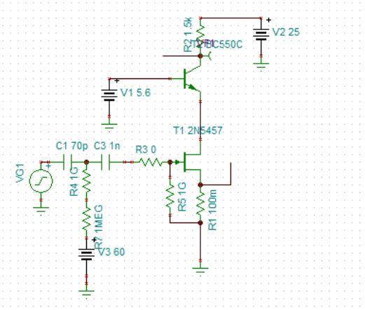

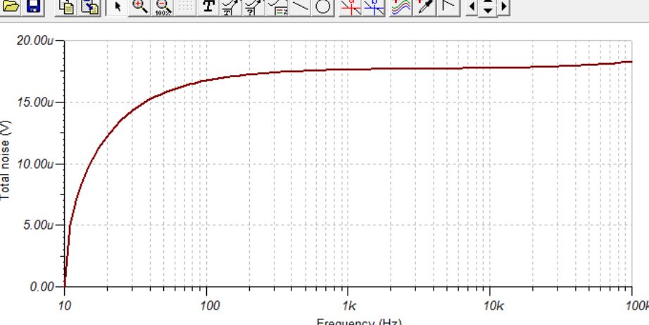

With my circuit that has 1Gohm to bias 60v the capsul and another 1G to ground the gate. I use common base bc550c for cascode.
I measure the total noise voltage for 10hz to 20khz bw.
The 2sk2394 with 18ma bias and the 2n5457 with 2.15ma both 12db gain, have similar noise.

Good point about the second 1 Gohm resistor.
Pity you took the integrated noise rather than the density. A lot of that noise is subsonic or at frequencies that are barely audible. The interesting part is the increase between 1 kHz and 10 kHz, which is hardly visible like this. Is it input or output noise?
At 20khz, it shows the rms value of the total noise at the output for 10hz to 20khz. The graph shows that most of the noise has occurred in the BW of 10hz to 100hz.
Fortunately, in my application for the pre-amp I can filter out (HPF) most everything below the fundamental frequency of the average human voice (say everything below 150Hz), which will help cut the total noise level down. I do all the AGC, equalisation/spectrum shaping, noise reduction etc in software (DSP).

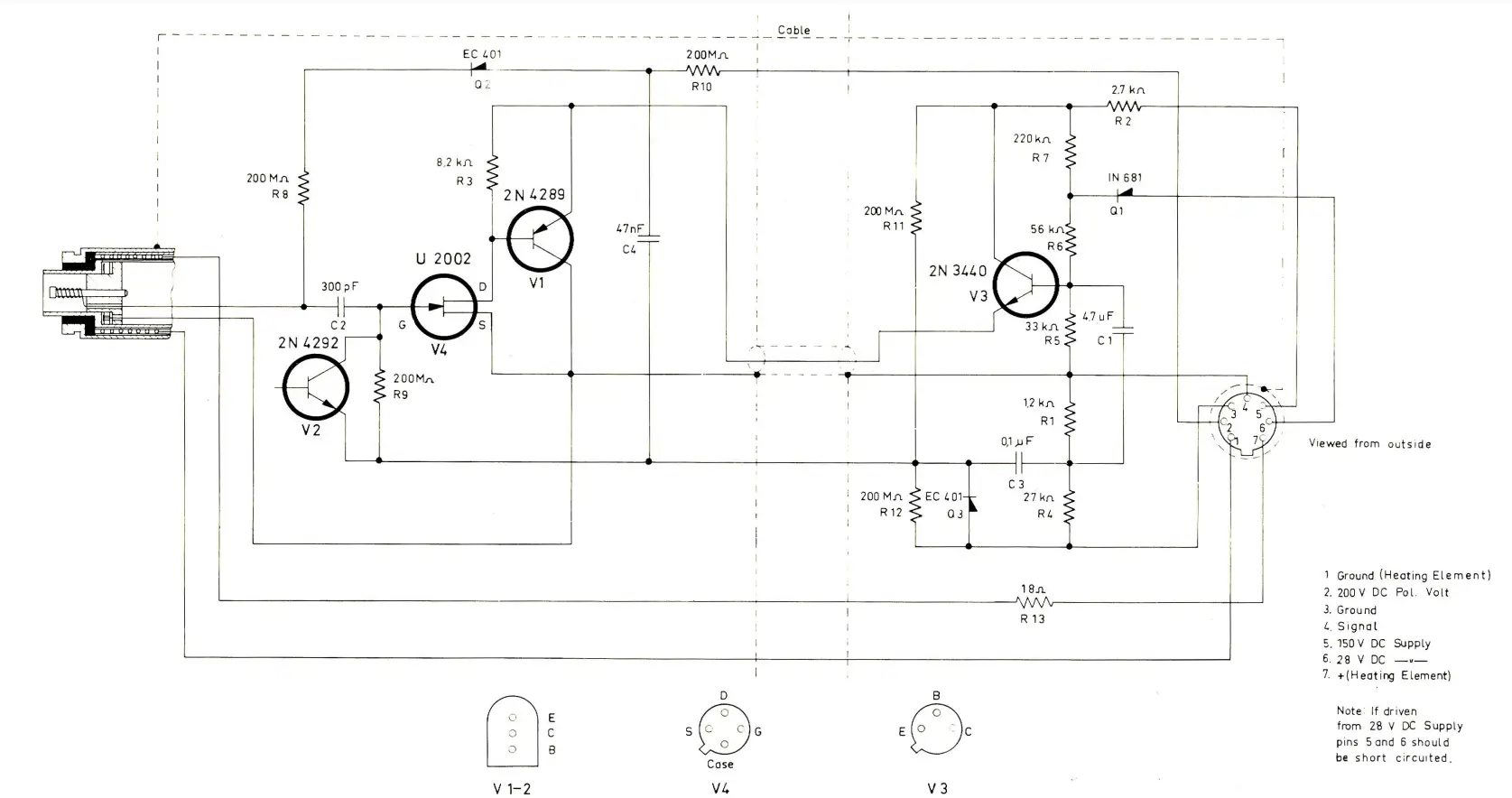

The typical high-performance mic amplifier bootstraps the JFET to reduce its effective input capacitance.
One typical specimen, Bruel & Kjaer vintage #2619 capsule amp, bootstrapping the JFET and all biasing paths:
I note that the bootstrap factor is slightly below unity to maintain stability. Interesting, the main JFET is partly biased by a NPN's leakage current and I think I've seen variants with JFET leakage biasing as well. Finally, the main JFET is the master in a CFP "precision" follower. A simple and effective circuit, and the head amps from Microtech Gefell from that era have very similar schematics, so this appears to be a proven concept.
The capsule and gate biasing is done by two relatively small resistors, only 200 Mohm each. Apparently they were more worried about leakage than about noise.
V2 could be a snap-back device for ESD protection. Apparently a 2N4292 is specified to have a VCEO of only 15 V.
