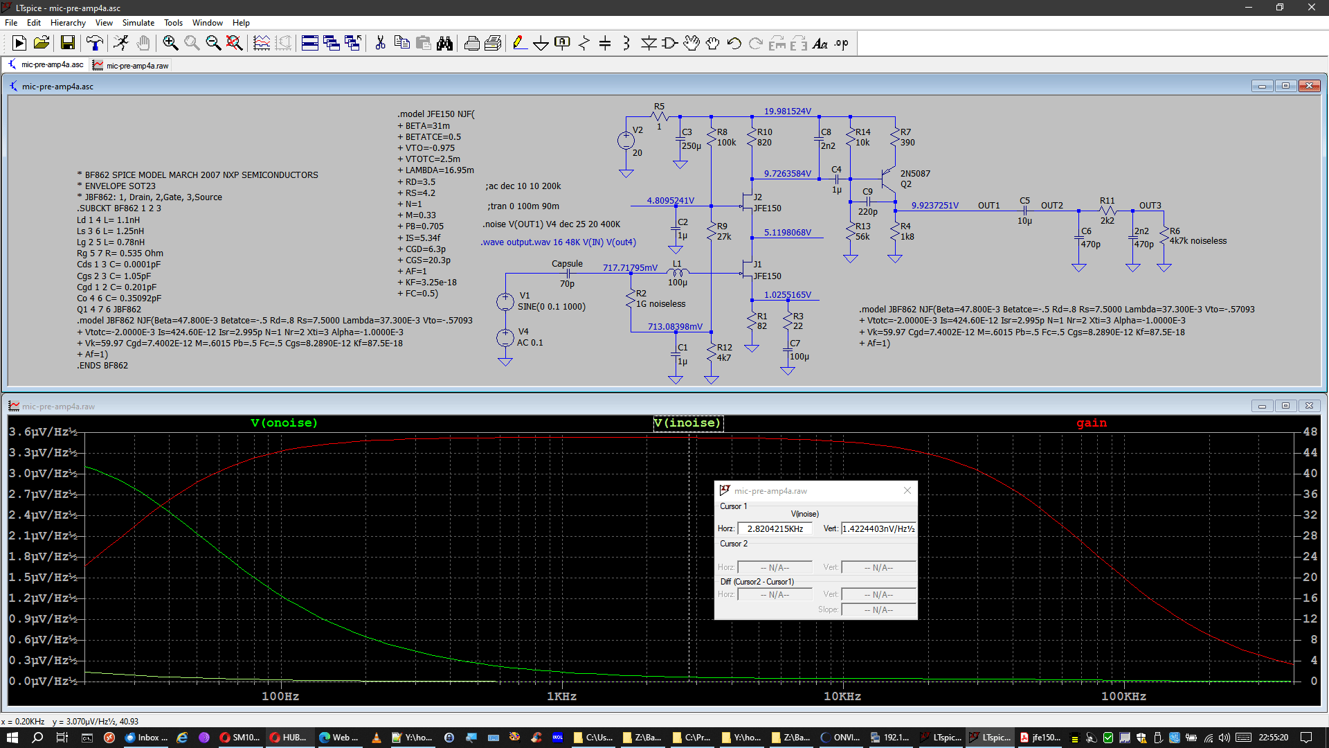

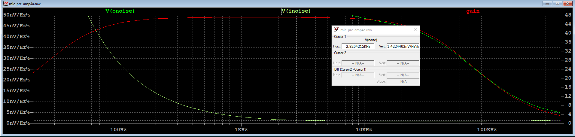

Just add the Vinoise trace to your plot. This will refer noise to the input and scaled for the gain.I suggest incorporating the gain into the analysis; namely, divide output noise by the gain (function of frequency) so that the you have noise density referred to the input (RTI). This aids assessment of design changes and comparison of active devices. Transistor data sheets will often show noise density vs. frequency, so RTI analysis lets you assess performance vs. manufacture's specs.
Yes - I have a small stock and would part with a few for a nominal fee and postage. SOT23 from Mouser.They have been out of production for a couple of years, since 2018 or so.
I don't know how suited it is to your application given the 1 G resistor and gate leakage currents. Probably a question for Marcel.
For the model, do a search on this site or google it. In general, noise modelling seems to be fairly accurate in LTspice, but as Mark has pointed out, many parameters are not that accurate and especially with JFETs
See figure 9 of https://www.nxp.com/docs/en/data-sheet/BF862.pdf for the typical gate leakage. As long as you keep the drain-gate voltage below 3 V to 4 V, it is typically just a few picoamperes at 25 degrees Celsius.
This should be good enough; as long as it is below about 52 pA, the shot noise of the gate leakage current should be less than the thermal noise current of the 1 Gohm resistor.
Mind you, there is no guarantee that the leakage of each and every BF862 is that low, so you could have a bad one. Production testing leakage currents in the picoampere range would have made the FET more expensive and it didn't matter anyway for the AM car radio front-ends it was meant for.
I haven't managed to get the BF862 version working yet, seems to be a problem with the BF862 model I'm currently trying to use, the input noise floor curve turns out to be virtually zero, but the cursor says 13nV. Somethings wrong somewhere.
But the JFE150 is so far the lowest noise floor at about 60% noise level of the 2N3819 version ..

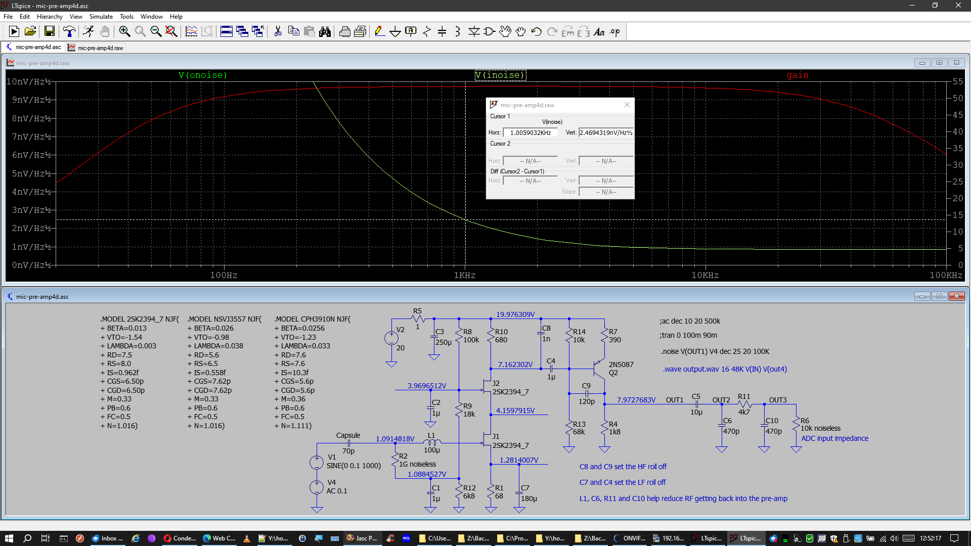

I've turned the buffer into a gain stage, but yes I was originally doing that. The series cap between the two stages now acts as the main controlled high pass filter setting (sets the LF response curve).Won't you couple output pnp directly to preceeding JFET? Saves superfluous bias network and coupling cap.
Will try it if I can find a model for it.2sk3557 may be also good. It says NF 1db.

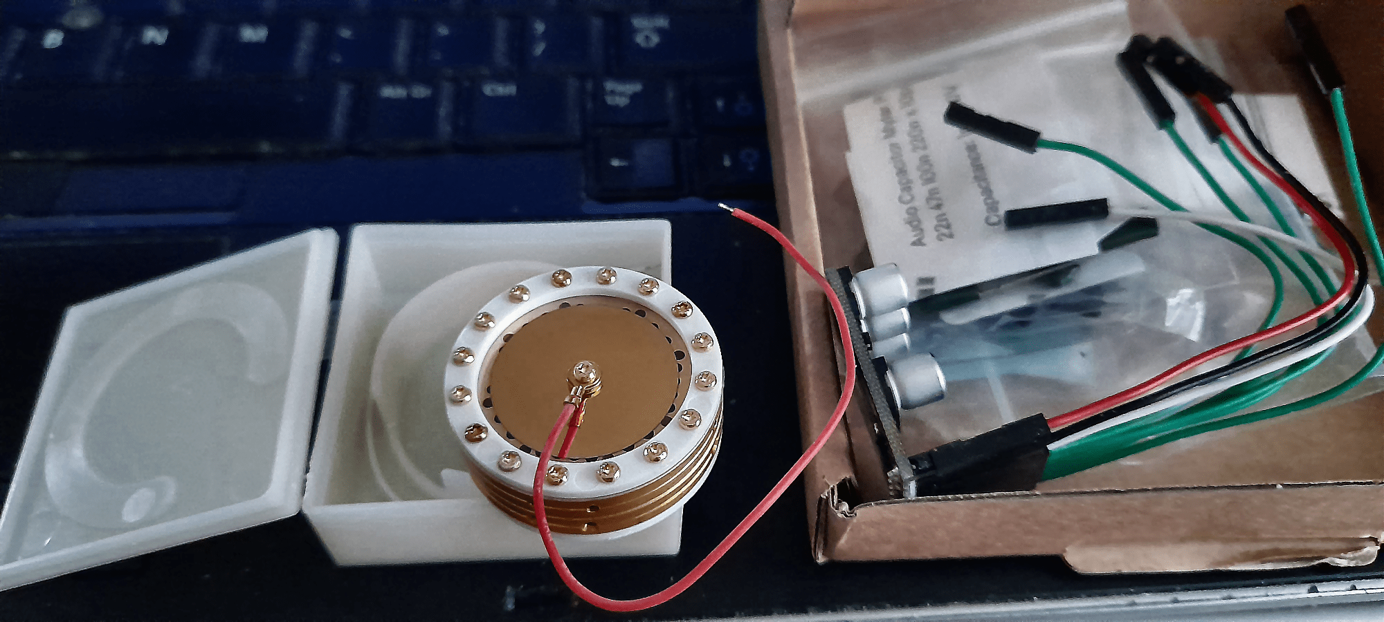

No not heard of that chip, though it's bipolar looking at the data sheet, condenser mics need to feed into a very high impedance low noise (jfet) otherwise you load the insert too much.

Here's the condenser mic, scared to pick it up even lol ..

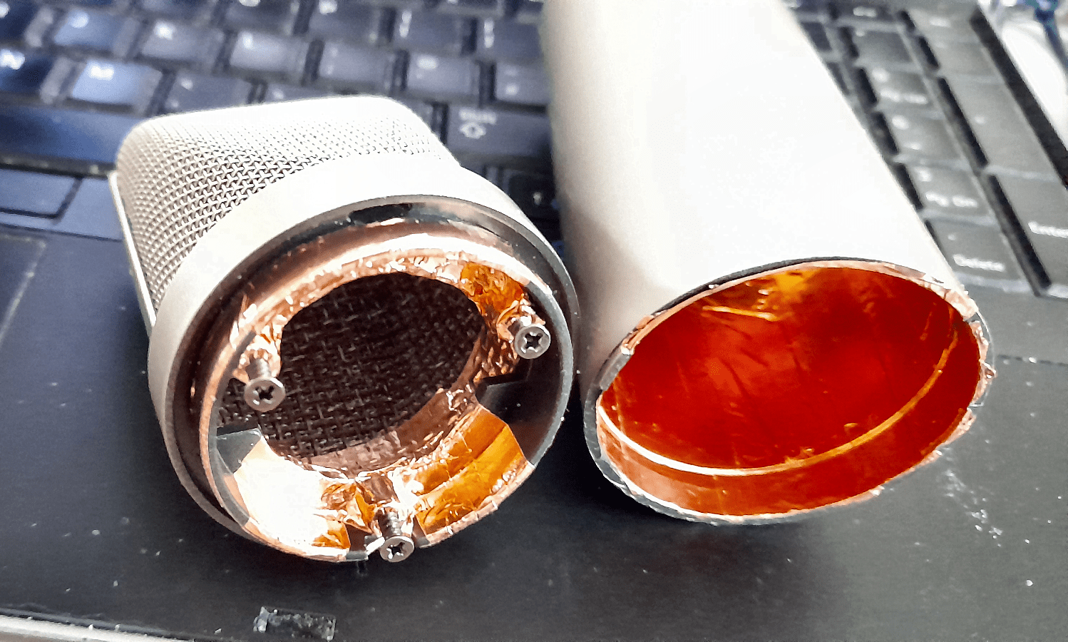

And the doner mic casing that's been copper lined for full screening ..

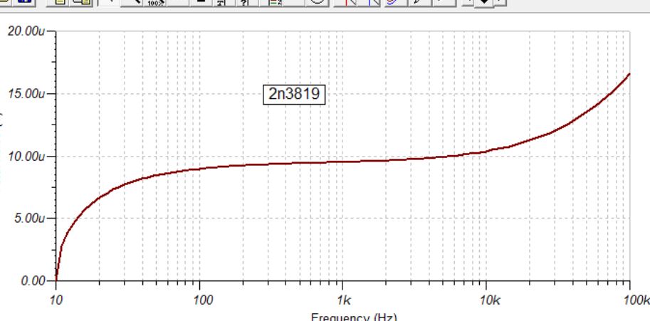

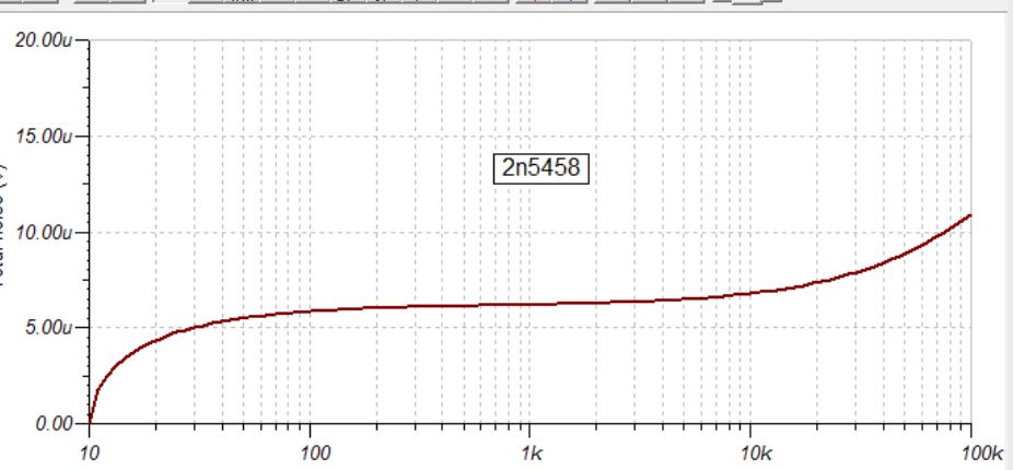

Was that done in TI's TINA @HAYK ?I tried with bf862, it has higher noise than the 2n3819 but the lowest of I tried is the 2n5458 nearly half the total noise.
I've not tried TINA as yet, though I downloaded, assume it's much like LTSpice ?
So far, the 2SK3557 gives the lowest noise floor (better than LS844 and LSK189), well, in LTSpice it does.
