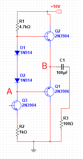

The literature usually just states that emitter followers have a voltage gain of 1 -- but I would like to know how to compute that with a bit better accuracy.
With a 1 kHz sine wave, on point A I measure 4.36 Vp-p, and 4.04 Vp-p on point B, so the voltage gain is 0,9266.
The current through the driver (Q1) is 920uA, and the DC bias is right on target at +5VDC.
I tried to simulate the whole circuit in Multisim, and it's giving me identical Vp-p values for A and B, and that is most certainly not correct.
The gain of 1 -- as far as I can tell -- is just a rough, 1st approximation. There has to be a more precise way to describe the actual voltage gain, which should be more or less independent of signal level -- provided, there is no clipping or cross-over distortion. I'm fairly certain there is some equation that correctly describes that, but I was unable to find it.
BTW, I made some minor changes to the Multisim circuit, and now it's correctly simulating the voltages -- 4.40 Vp-p @A and 4.00 Vp-p @B.

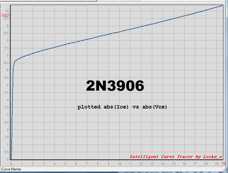

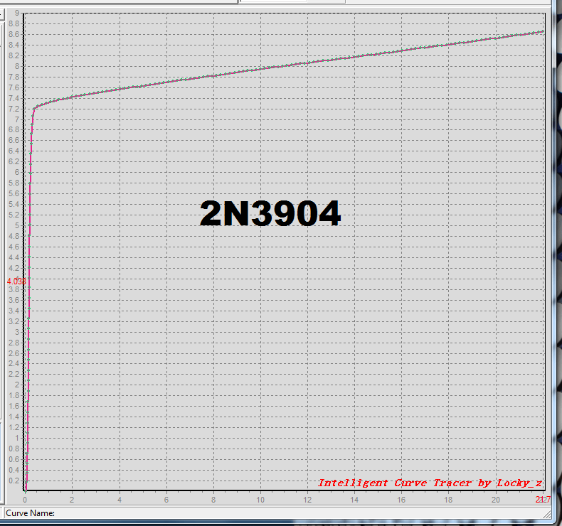

1. Assume the NPN and PNP devices are perfectly complements. Same |Vbe| , same |hFE| , same hybrid-pi model parameters. Be sure to include hybrid-pi parameter "ro" which models the Early effect in bipolar transistors. It's why real transistors have IV curves that slope upwards, unlike ideal transistors whose IV curves are flat and perfectly horizontal.
2. Follow the excellent advice in posts 7 and 8 above.
_

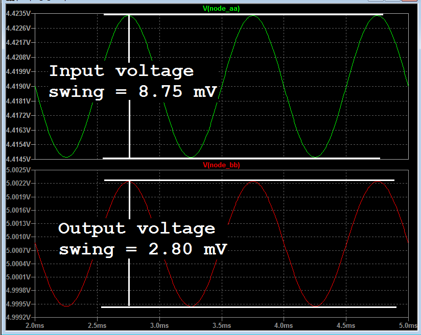

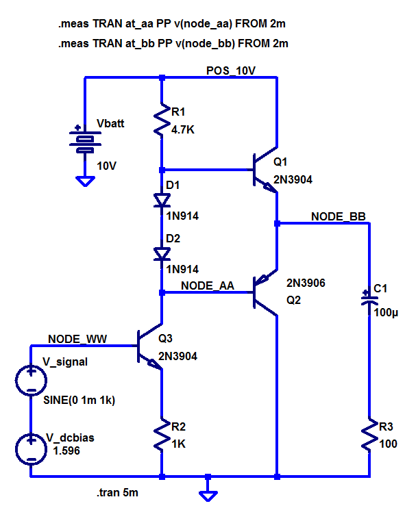

Here's what I got in a .TRANsient analysis using relatively small signal amplitudes (less than 10 millivolts). I think you'd also find .AC analysis to be useful.
Gain from node A to node B was way, way less than +1. It was +0.32 volts per volt. LTSPICE results attached below.
I used the ".MEASURE" feature of LTSPICE to have the simulator extract the peak-to-peak ("PP" in the measure command) amplitude at node A and also at node B, from 2 msec to 5 msec. Those amplitudes are shown in attachment 1.
