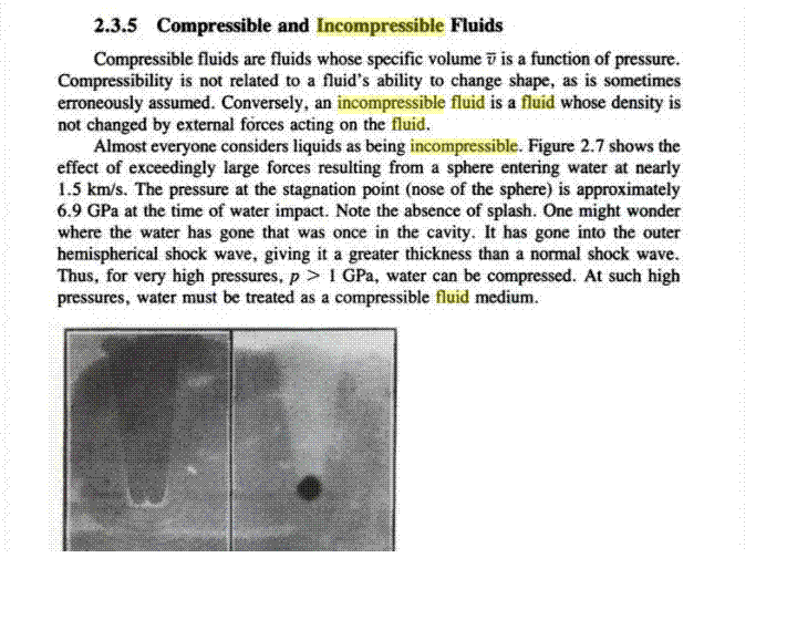

Here's a solid reference: Fluid Mechanics. Attached below is a page from the book.
It's important to understand the forces involved. At pressure greater than 1GPa water can be considered compressible.
1GigaPascal doesn't sound like much? That's equivalent to ~145,000 psi. Big enough number?

Did you miss the part where I quoted a reliable source that says that at pressure less than 1GPa water is treated as incompressible? Gee, it's 2 posts up.
Nothing is absolute. Read it over and over and over how I have said that water is compressible.
For about the 100th time: it takes more force than a sound wave can supply.
