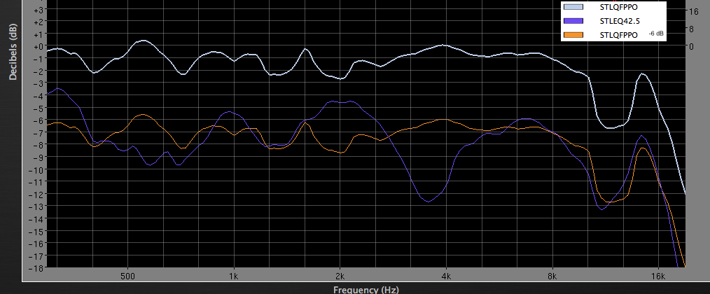

That dispersion is horrible! Why build that? The 15-20dB valley between 3 and 4kHz under angles is bad for even 80s speakers.The SynTripP without the secondary horn extension is only 26.5" (67.3 centimeters) wide, it maintains a -6dB 90° horizontal pattern to 400 Hz.

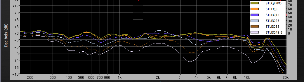

You are exaggerating that polar deviation by a considerable amount.The 15-20dB valley between 3 and 4kHz under angles is bad for even 80s speakers.
If the polar response was perfectly consistent, the response would be -6dB at 42.5 degrees off axis compared to the "FPPO" (0 degree) response.
The worst case at ~3.5kHz is ~-12dB, the pattern has narrowed.
Although even response is preferable, having an off-axis dip in the response where hearing should be most sensitive is not the worst.
Personally, I find the response being +4dB 25 degrees off axis (wider dispersion) is a greater defect.

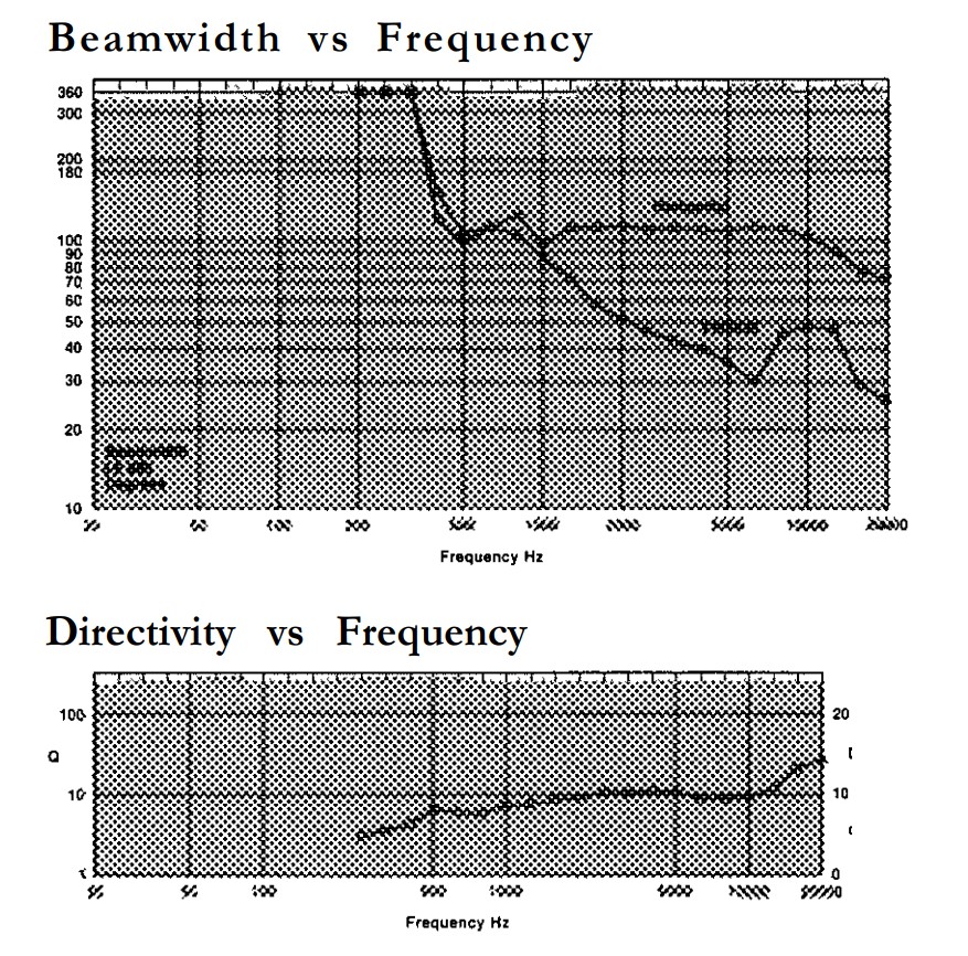

About the "beam".. Please look at this:
Look at how extremely even the beamwidth is and even where it isn't as controlled, hof softly it changes. That's magnitudes better above the measurements you've shown. So that's exactly the opposite of what the claim is. And yes, that's the jbl 2380.

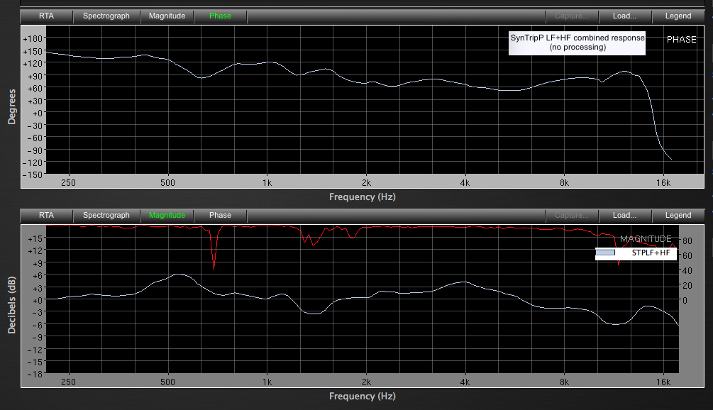

That doesn't look raw, that looks better than a driver alone and the fr suggests there are phase problems. I'd like to see the crossover plan.The phase shift of the SynTripP's low frequency and high frequency drivers combined with no DSP used at all (raw response) is under 90 degrees from 250Hz up.

The STPLF+HF magnitude and phase graph were of the raw 10" low frequency and 3" diaphragm HF drivers driven on the SynTripP horn with it secondary horn extension laying horizontal with no crossover, measured on axis, ground plane on October 30, 2014.That doesn't look raw, that looks better than a driver alone and the fr suggests there are phase problems. I'd like to see the crossover plan.
You can (barely..) see the DriveRack PA DSP settings used in the polar plots in post #9 of the thread:

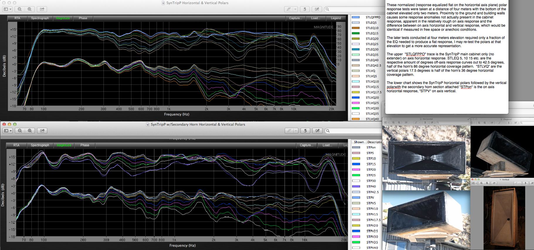

The polar charts did use the DSP mentioned, but others did not.
The montage you posted in #35 of three separate measurements of the LF and HF (no crossover, no DSP) raw response at four meters height is a different measurement from the upper one in post #30, the combined LF & HF raw response of the cabinet laying horizontal, measured on axis, ground plane on October 30, 2014.
Yes, exactly! Combining truncated measurements is everything BUT RAW! As in, the polar opposite! I was instantly extremely suspicious and I was right.
You can't snippet it together because the diffent measurements do not contain the phase differences to each other anymore! That's basic principle #1 for measuring phase! The same goes for the fr, that's not raw either. Both suggest practically perfect phase, no need for a delay and perfect conditions for a passive crossover - which is both dishonest and plain wrong!
