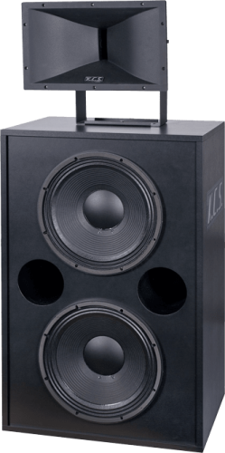

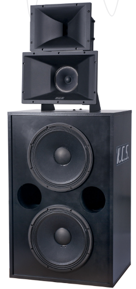

a friend of mine recently salvage some old pa speakers from a cinema.
He got two bass cabinets from spanish speakers cinema brand KCS : the c-215 model. It's your typical passive double ported 15" bass cab. Along with it came one subwoofer (a double 18"), and two amps.
The two bass speakers came without the compression + horn that is usually mounted to it (model is kcs s801 driver + s201 horn).
So we're looking about how we can get it all to work in order for us to have a small PA system.
Our objective is to organize small concerts / parties in the countryside. So a stereo system obviously. Music played is everything from indie rock to traditionnal music (think old instruments) during live shows, to electronic music of all genre during parties.
Mostly outside, some small indoors places as well, not attached to a fixed venue. We are not a professionnal operation, think non profit diy concerts parties, we'll book local acts and dj friends.
I'm here to get recommandations about which compression + horn might pair nicely with it for our use. There is'nt a lot of data on the cabinets sadly, the only figure i get is the crossover frequency is pretty low at about 500hz. Best would be to get some measurements done, which we will defintely do when we get around to it.
I'm struggling to identify compression drivers that go this low for pa use (the obvious solution would be to add another way between the bass and the compression, but lets not for the moment).
In addition we'll have to get some active filters, if anyone has a good recommendation for something that can be found secondhand. Otherwise we'll have to get some budget stuff like behringer to start, i'd prefer to put the money on some good drivers first.

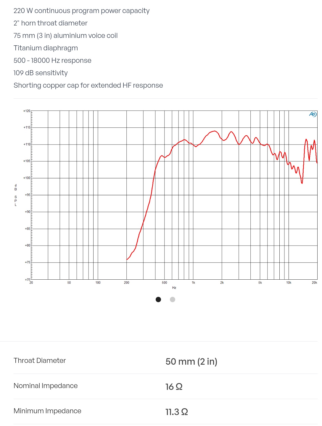

Lucky guy! Check out partexpress.com. Below is the 1st driver I came across that went down to 500hz. You will have to check them all to see which driver meets your needs frequency and cost wise.
https://www.parts-express.com/B-C-D...ssion-Driver-8-Ohm-4-Bolt-294-6072?quantity=1
"The 3" titanium diaphragm is optimized to deliver natural response from 500 to 18,000 Hz."

Is that one dual 15" and one dual 18" box? Or multiples of each?
You will need what is referred to as a large format compression driver and horn combo, they typically have a 2" throat diameter with a 3-4" driver diaphram.
Examples would include but is not limited to the JBL 2445, B&C DE750, Selenium D3300, D4400. These are classic drivers now, that means you can sometimes find them at reasonable prices.. sometimes not, there are many more and there are modern drivers that could be candidates too but expect to pay $$.
You will also need an active crossover.. preferrably a DSP, and separate amplifiers for each section of the system.

The easiest (wel documented) solution would be a B&C DCX464 in the acompagning ME464 horn. But it's a very expensive solution (and you will need dsp). It's a coaxial driver (2 compression drivers in one) that can cover the whole spectrum from 300Hz (altough 600Hz is safer to cross) to 20kHz, in one horn, and the ME464 is made specially for that driver and proven good. Crossing it at 500Hz with a higher order filter is no problem at all.
BMS and Celestion also makes drivers like that, and they are also very expensive. There are also other horns that can do that bandwith. But if you need to go that low you will need 2 bands of compression drivers, not 1, and those do it the best that i know of.
You can off course also use 2 seperate compression drivers and two horns, but that makes it more complex to build and it won't sound as good as a coax. Another option is to build a MEH top that fits it, but that is not easy to do (more for advanced diy speaker builders).

@BP1Fanatic thks, yes this b&c looks promising, in our budget, and doable with our limited skills (we ll get help for tuning the system regarding the dsp and all).
@conanski Thank you for your help, we got two dual 15" box, one 18" box. A second 18" would definitely be good, but it will have to do for now.
Yes the jbl would be nice if we can find it at a good price. I'm sure they sound fantastic, but i'm a bit cautious on getting vintage drivers for PA use, maybe i'm wrong. Yes of course we need active crossovers. I'm also inquiring about which model would suit our need. For amps we got two QSC USA 1310, would that be enough or do i need a third one (haven't really look at the power rating of each driver / amp yet)?

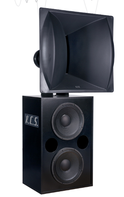

The original post already includes the specified system model and photoThis one..

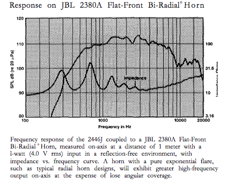

Very much resembles the classic JBL 2380A horn and common used driver usually 2446H
4 bolt 2" throat, titanium drivers expect loading to 500 Hz common crossover 800 Hz
For Current availability with loading to 500 Hz with 800 Hz crossover.

B&C ME75 Horn
Specific driver designed for the application
B&C DE750TN
Otherwise a suitable 2" 4 Bolt Titanium Driver
within noted frequency range.

Ok thanks for all your response. Yes getting the original KCS 801 horn +cd is definitely on the list of option (or getting other KCS related horn cd combo), but i need to find it in good condition and at a good price. I thought if the price difference between a vintage KCS matching horn + drivrer (which i know they get from a driver company) and a new driver + horn is not too great, i would go the new stuff.

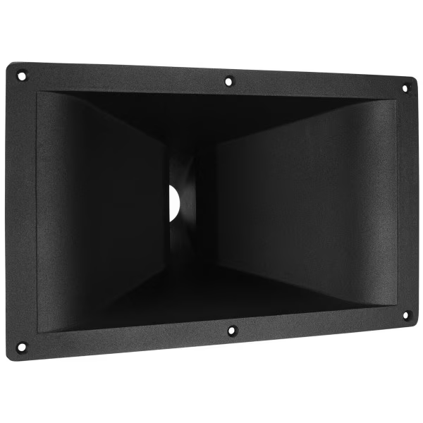

If the ME75 horn (also a variation of the JBL) is too expensive, there is also the P-Audio clone of that JBL horn, the PH-2380. I've used it a few times and it's quiet decent build. Lowest i crossed it was 600Hz with an old Selenium driver to replace a broken JBL horn on a cheap budget, and it does the job. I've used this horn also with a Faital HF-201 driver crossed at 800Hz (but that is to high for your purpose).
The ME75 is better build altough than he P-Audio, but the P-Audio is a lot cheaper and good enough for most purposes i think. It fits standard 2" drivers, both the Selenium and Faital work flawless with this horn.

Not enough difference to say which is "better" from a sound quality standpoint, but less voltage is required for the "J", 2.83v for one watt compared to 4v for the "H", so some money can be saved on the amplifier driving it.
If you are using a "constant directivity" horn like the JBL 2380 (or copies of the more than 40 year old design) ~+10dB is needed to flatten response above 7kHz:
The 8 ohm version allows +3dB more HF "boost" (actually -3dB less attenuation) to flatten response with passive crossovers.
I'd do a low level sine wave sweep test and buy the pair that sounds cleaner, noting the voltage required for the 8 ohm will be less for the same volume. If the driver buzzes, (easier to hear below 500Hz), either the diaphragms may be misaligned, defective, or the gap requires cleaning.
Also note the DC resistance should be 4.3 ohms (H), 8.5 ohms (J) ± 10% @ 25°C.
If not, the diaphragms may be aftermarket, which usually have crap response compared to the original, and often have not have been installed properly.
