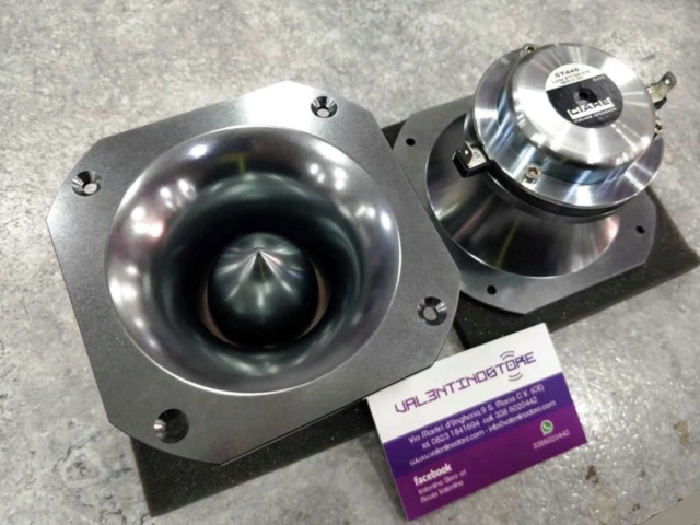

Here is my new project setup :
15" BEYMA 15LW30/N , 12" BEYMA 12LW30/N , 2" compression driver and super tweeter
Fc = 150 Hz , 900 Hz , 8000 Hz
I didn' t decide for the 2" compression driver model but the FaitalPRO HF200 looks very interesting.
Same for the super tweeters, those CIARE CT440 have very good spécifications : Product – Ciare
