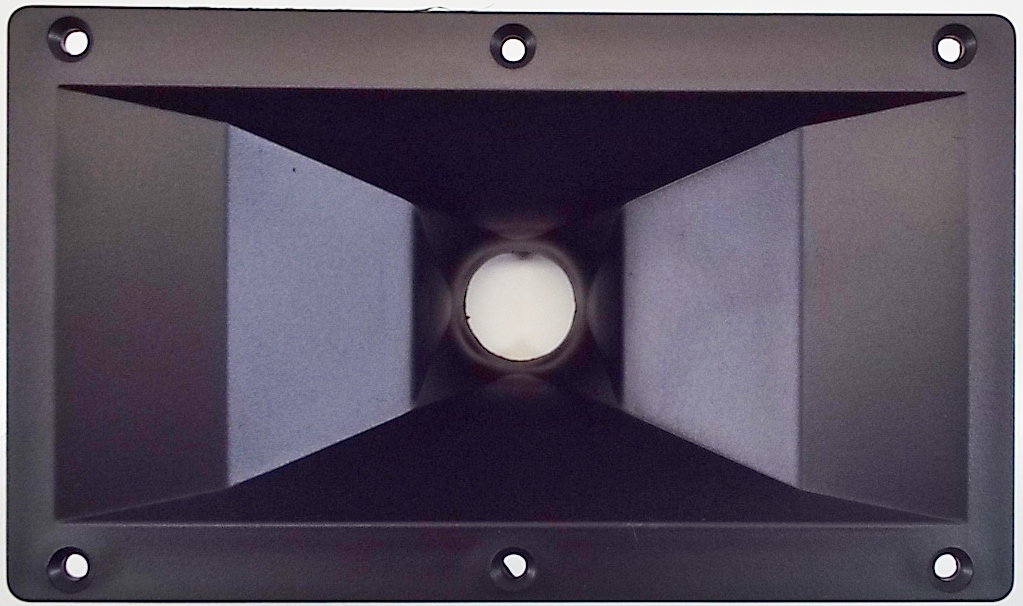

The waveguide/horn in the Audioexpress article is NOT in the APT 150S (as mentioned in the article). That's actually a screw-on only design.
Instead it's the SST1, and it's very similar to the HF94 but its off-axis response is a bit more "constant" (..more "straight-sided" waveguide). Not made of Aluminum though, but the SST1 is also considerably less expensive.
Note: you can stress a driver below most of the gain/loading freq. with any horn/waveguide, and it can be less stressful if you do that with the right 1.4" exit driver (as opposed to even a good 1" exit driver). Also 1.4" exit drivers typically have more "gain" lower in freq. regardless of the horn it's used with. This can allow a lower freq. advantage with the HF94, but the horn itself really doesn't adequately support lower freq.s - it's just to small.
