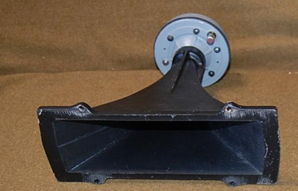

Moray,Tom what happens when you are using a horn which is compromised in mouth size and or in length, what then happens to pattern control at low frequency range of the horn? I have in mind here typical mid horns used in three ways and two ways. Lets say a Cornwall with a K700 crossing at around 650 Hz with a fifteen inch woofer below.
As Tom mentioned, all horns have a “pattern loss frequency”.
Wide, short horns like the K700 will go through a "pattern flip" at frequencies where the wavelength is long compared to the horn's height.
The output of the horn will progressively diffract more vertically at lower frequencies, at 650 Hz (21 inch, .53 meter wavelength) the dispersion may approach 360 degrees while at very high frequencies the horn walls would limit vertical dispersion to around 15-20 degrees.
If the horn is mounted to a large baffle it will keep the vertical dispersion to around 180 degrees.
The center to center distance between the horn and woofer will cause a narrowing of vertical dispersion in the crossover region through destructive interference patterns, the lobes are determined by the acoustical sum of both drivers, very crossover dependent.

Thanks Art: so for the mid horn in the CW its polar response will become wider in the vertical as frequency descends and will also become narrower at the same time in the horizontal plane? With system pattern being determined by the proximity between the mid horn and woofer operating as a combined system.
So looking back at my question to Tom then as a small horn attempts to play down to or just below cut off the polar response looses directivity is that correct? Thanks.
