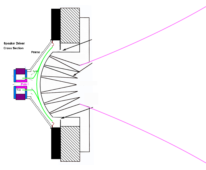

The limit on compression driver size is mainly its being an edge-driven dome, right? Why don't they turn it around and put a conventional motor behind the dome? Wouldn't that allow for gigantic compression drivers? Of course you'd have to have some way of having the dome shape on front but a nice strong coupling to the VC on the back, but that shouldn't be too big of deal. Would there be no merit to a driver like that?
Conventional dome shape diaphragm size is compromise between high frequency breakup and output potential, a 4 inch diaphragm diameter is pushing the limit of acceptable performance.
A number of driver manufacturers use annular ring diaphragms rather than domed diaphragms, making for larger diaphragm area with less distance across, this might be close to what your idea is.
Like this (relative scales and angles in this sketch are not determined by logic, just by the cross section images I'm mashing together).

I was not talking about trying to get good HF performance from a large diaphragm, I was talking BIG and low frequencies. I guess maybe the actual question is whether there would be any benefit to the sort of thing in my sketch rather than just having a cone crudely mated to a large horn throat, or through a slot/hole.
Ah -
In that case, my original comment applies then.
A front loaded horn with a cone at it's apex IS a compression driver.
You can take a front loaded horn like the labhorn, and every single element that exists in that basshorn also exists in front loaded horn with a compression driver at it's apex. And I think that's the reason you don't see a lot of compression drivers with diaphragms larger than 10cm. Once the dimensions are getting that large, the frequencies are long enough that you don't need a hyper-accurate phase plug. (Like the phase plug in that Tad that I posted a second ago.)
Once we're talking about wavelengths that are eight feet long being radiated by a cone that's half a foot long, the wavelengths are so long the phase plug no longer has to be perfect.
But it's a whole 'nother story when the wavelengths are an inch long and the radiator is four inches in diameter.

I guess you're reading the drawing wrong? My drawing is, it turned out, trying to show the same thing that the JBL CMCD drivers are. The green line is the cone+VC. Here it is next to the compression driver drawing it was sloppily made from:
