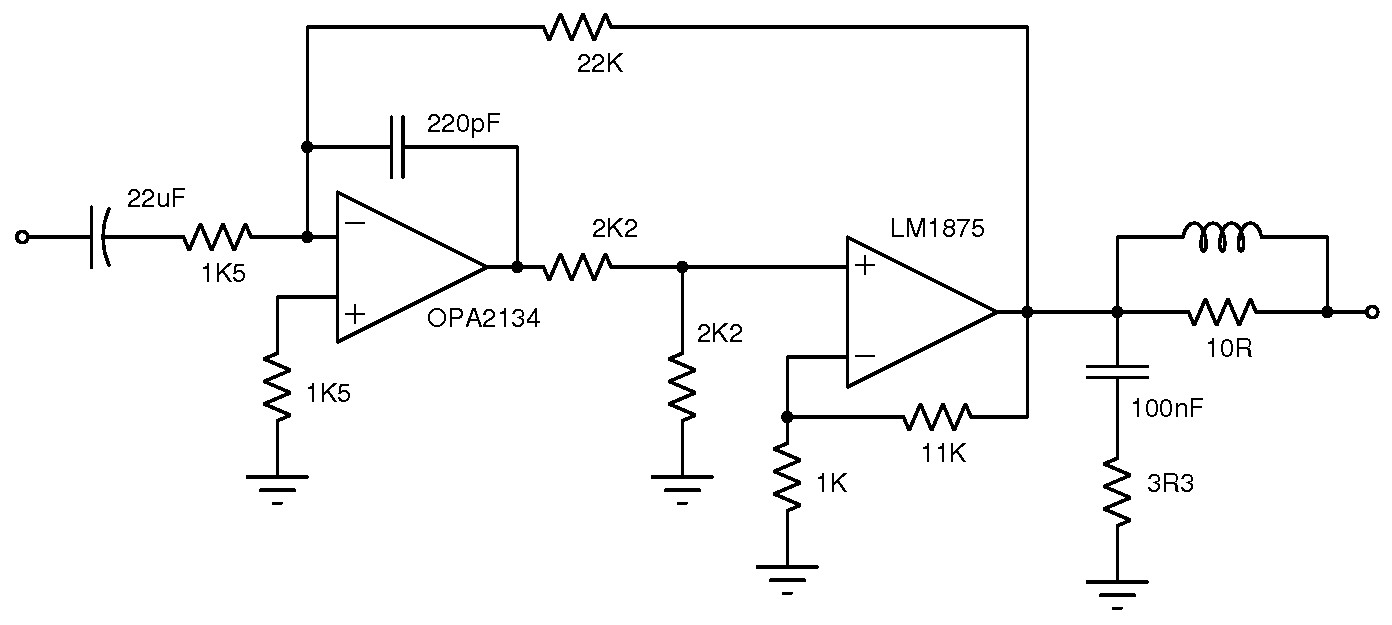

Do you have a schematic to share?
A sketch/drawing is fine.
Also, what power voltage did you use?
Thanks!
Sorry, right now I haven't time to draw up a schematics.
I can inform you about the non-trivial characteristics that should make it possible for you to repeat the experiment.
LM1875 amplifiers set to 12 times gain in a non-inverting DC-coupling. Nothing but purely resistive feedback. Zobel and Thiele elements at the output according to the datasheet.
A 6db resistive reduction at the input of the LM1875 part.
OPA2134 in inverting coupling. Feedback from the output of the LM1875 (before the Thiele elements). Purely resistive feedback set to around 18 times overall gain (input of OPA2134 to output of LM1875).
220pF from the OPA2134 outputs back to the inverting OPA2134 inputs.
Elna audio-grade capacitors at the very input set for a high-pass frequency of some 5Hz.
Tested with my variable, linear, symmetrical power supply (high capacity) between 16V and 28V (+/-). Volume levels on my Jamo 707's (8 Ohm) until my wife asked what the h... was going on? No signs of instability. In my subjective perception, very clean sound and a bass that can handle even the lowest frequencies of a church organ (pipe organ).
Among other personal draw-backs, I tend to design circuits with the soldering-iron in my hand. I decide for the detailed circuit as I go along. This is why I do not have a schematics to show you. My initial skills date back from before personal computers would calculate the loop stability. So, the loop stability was decided by empiric means. Even the best planning cannot replace plain luck!

Finally managed to make a schematics. 98% certain on the component values. Not in my labs.
