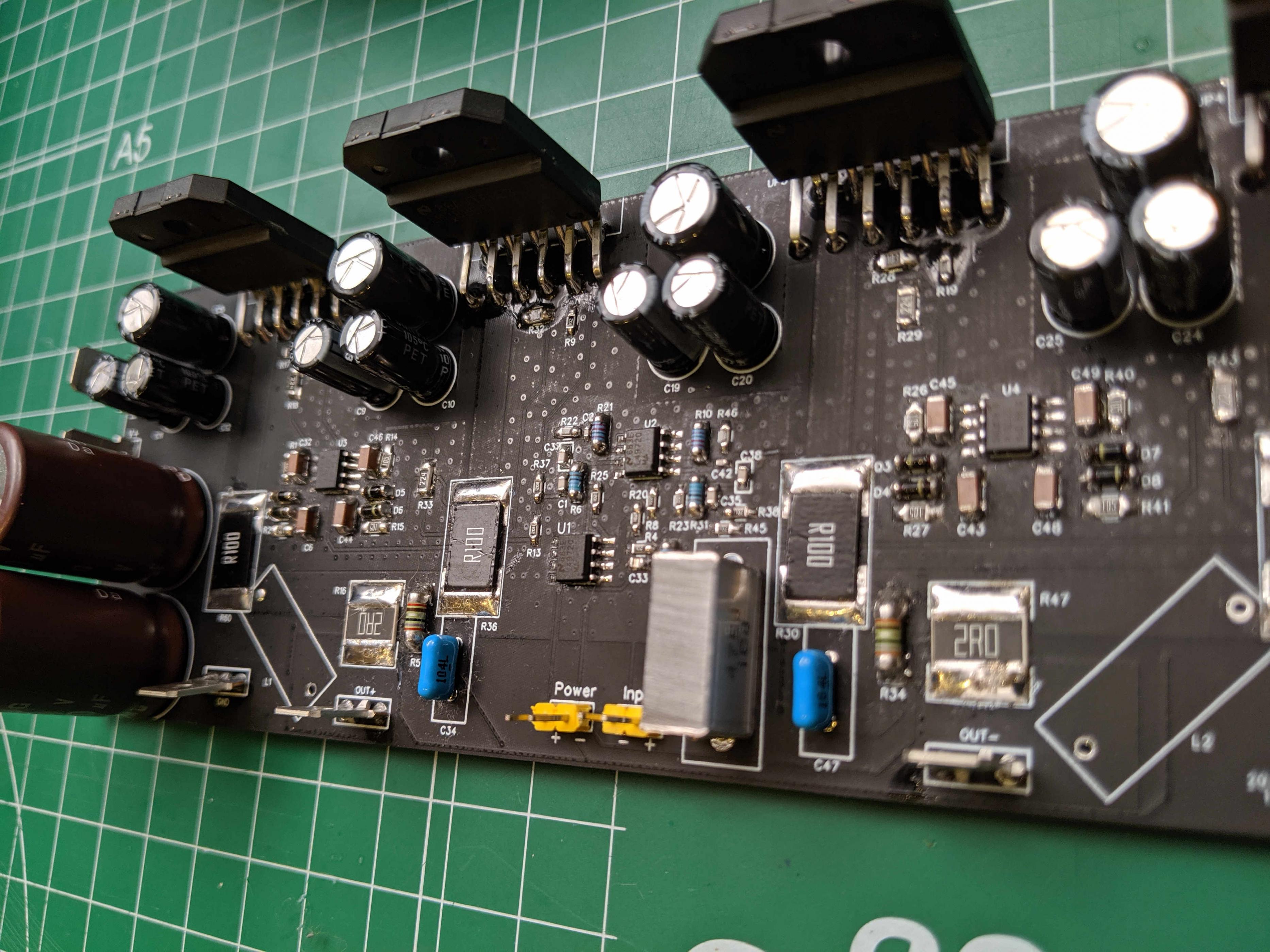

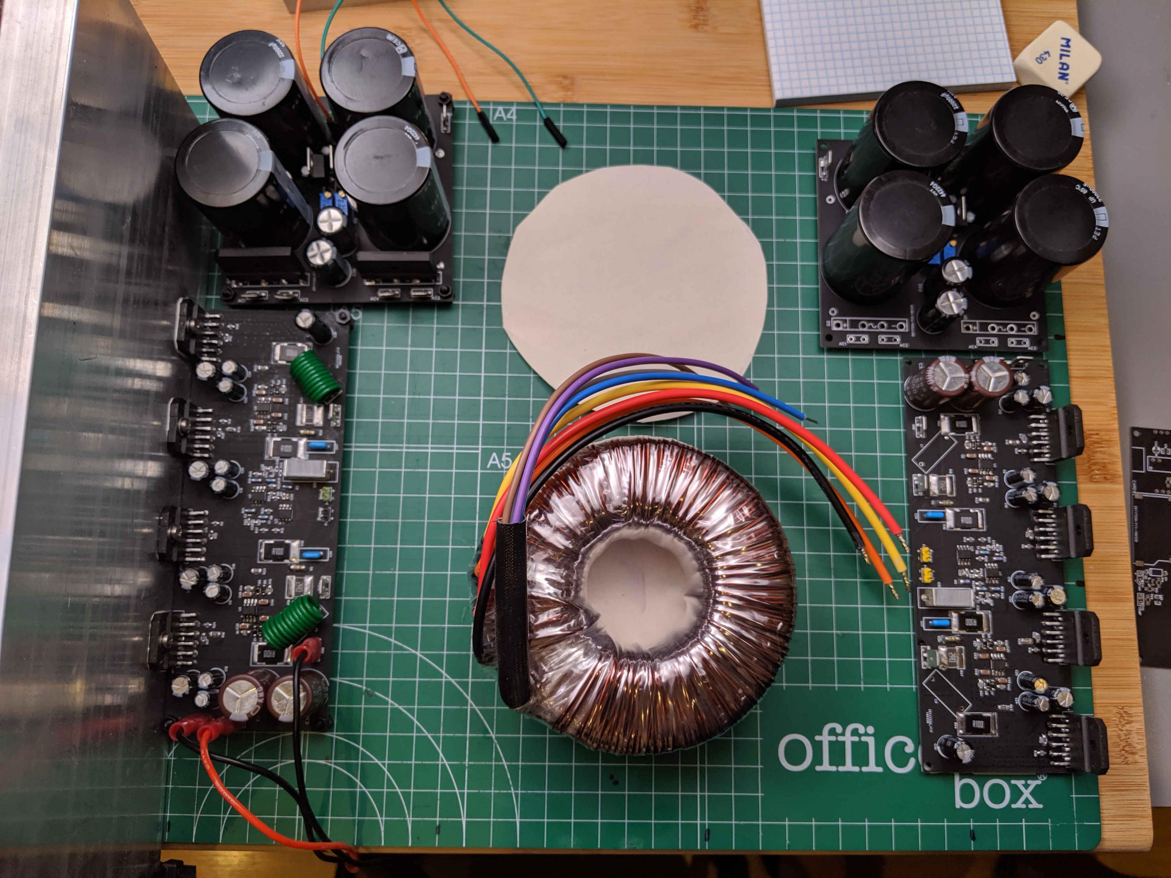

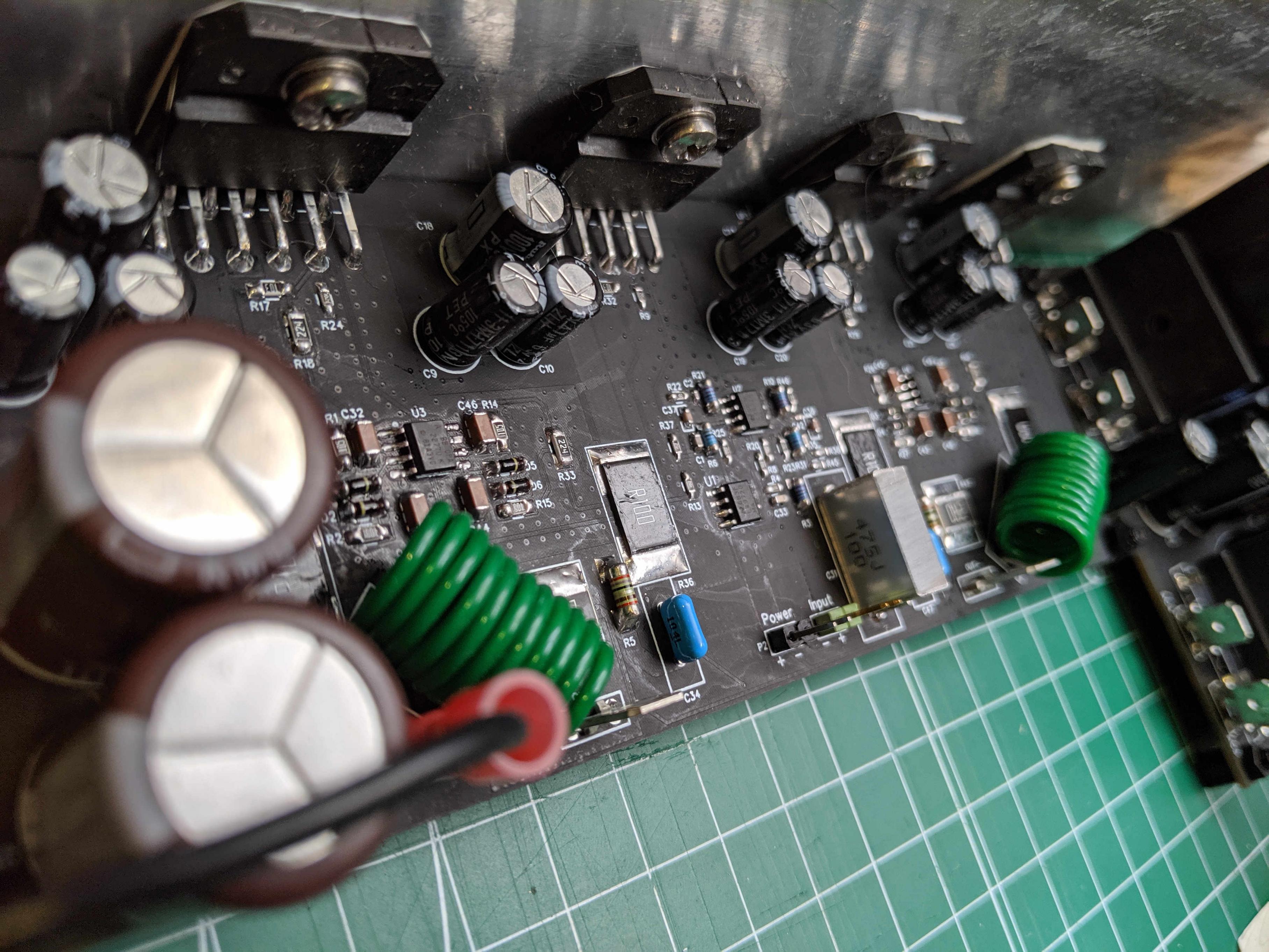

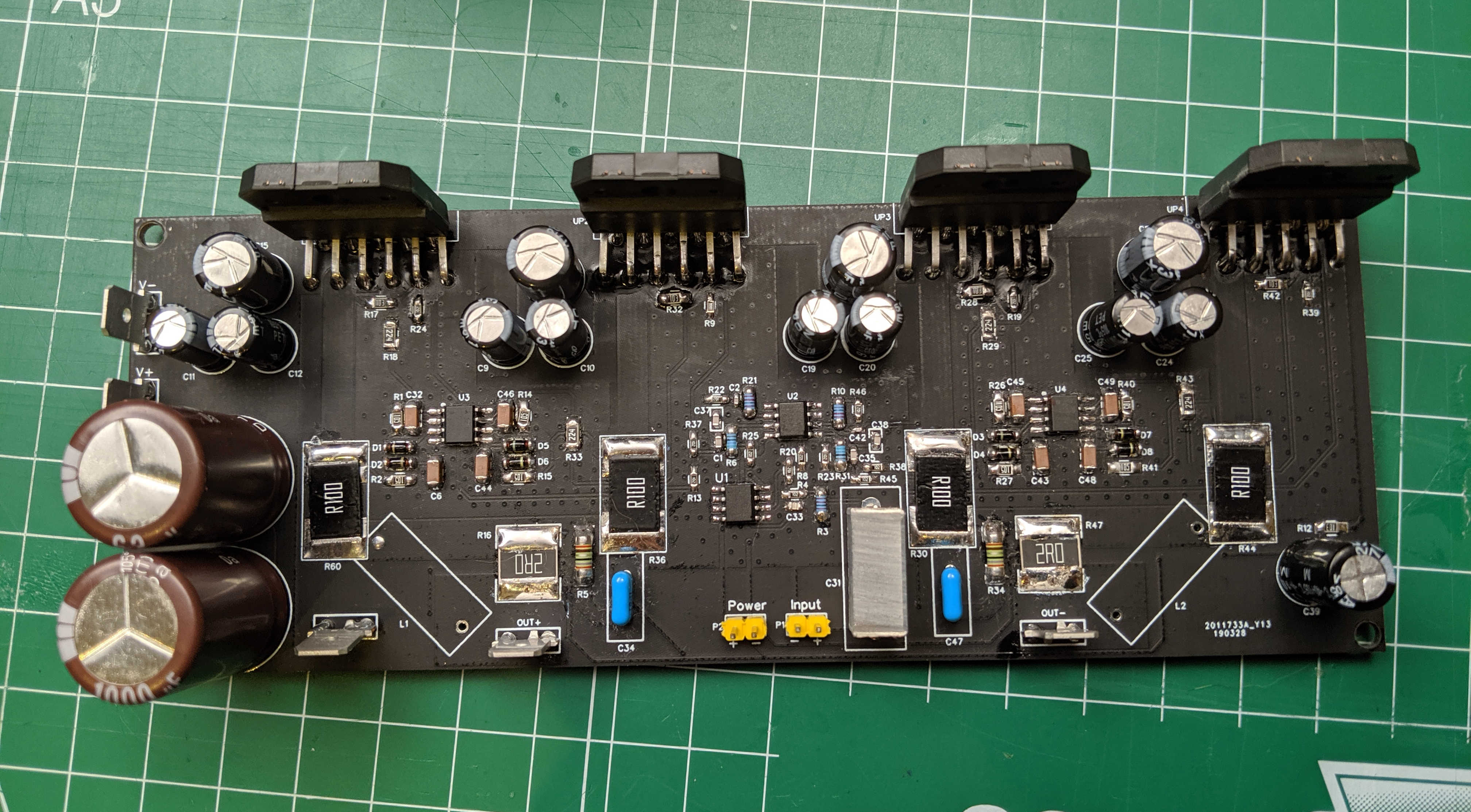

Yes, here are some photos:
One channel tested and tortured, the other WIP - missing the bridge rectifier and the output coils.

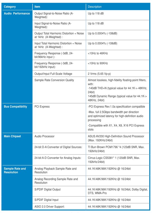

Can anyone recommend a good sound card to do some measurements?
Depends how much you want to spend. Focusrite Scarlett are indeed very nice and reasonably priced. Focusrite Clarett are even better. My Audient iD4 is good up to about -95dB THD. If you have much higher budget gear from RME, Motu or Universal Audio offers exceptional performance, approaching -115dB THD+N.

No particular reason TBH. In fact I'm running the amp with a modified PSU with one rectifier per channel instead of 2 and everything is fine.
I will modify the schematic to reflect this. Also I moved the bridge rectifier out of the PSU board since I prefer to bolt it to the case to help cool it.
The amp is complete now but I don't have the speakers yet.. I did some tests with a 4Ohm resistor load for the left channel and one crappy 20W marantz speaker for the right channel... I had to be very careful not to blow the speaker 🙂
It looks great and it took the better part of the weekend to wire and test everything... I hate working with mains voltage 😱
