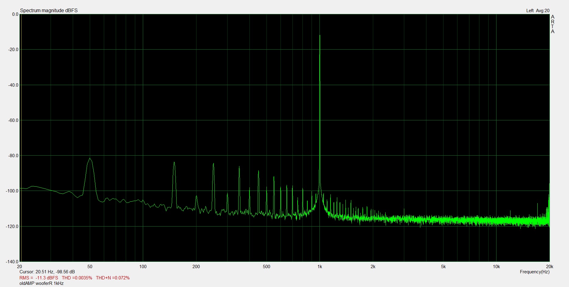

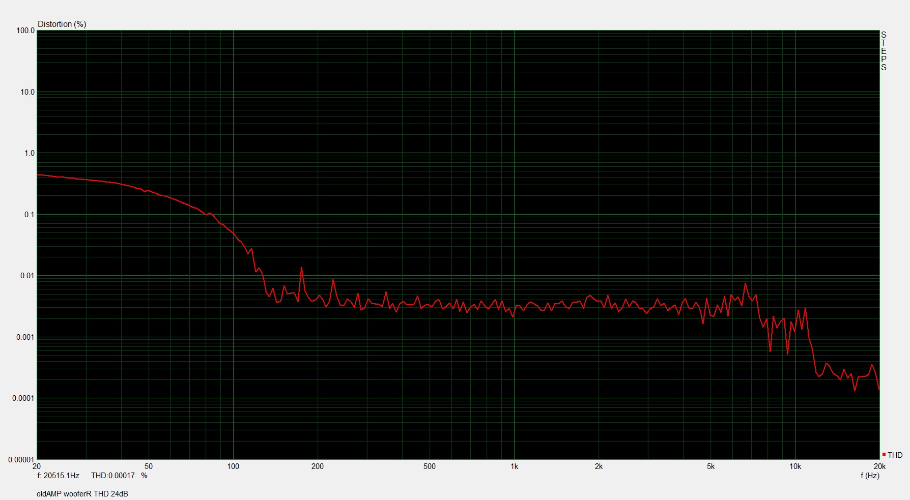

Fine... just a question: did you make THD measurements with the simulator (TINA)? I'm asking this because if you are applying a lot of compensation, the distortion of the amp is getting worse... and at the end you have no benefit with composite arrangement.
If you have a good sound card, you could try to measure with ARTA...
A few posts back, or in another thread Tom gave some insights in the THD measured in TINA. I don't think we should get too hung up about THD in spice. It should be low off course. Make your sample longer and often THD will go down as well... .

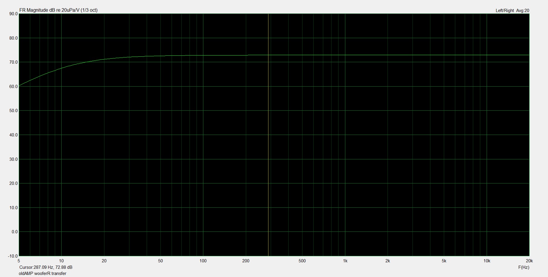

The high precision signal source we used is not sweepable, so I do not have a good plot of distortion vs frequency. But we saw distortion products around -120 dB in a 19+20 kHz IMD test with both frequencies at 15.8 V RMS. I suspect most of it came from the signal source used in the test. This thing has ~50 dB more NFB at 20 kHz than the datasheet LM3886 chipamp. For the next version, we are aiming at even better performance, but I am not sure we will be able to measure it. The simulated unweighted noise across the audio band is equivalent to the thermal noise of a 1.5k resistor followed by a noiseless 10x amplifier.
There is huge performance potential in the composite amplifier concept. A measurement with a regular sound card will probably not show much more than the distortion and noise in the sound card itself.
