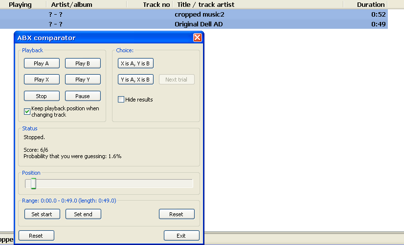

I am sorry to say that, but your chain is not transparent enough. One of the files has much higher noise audible. My result is 6/6, I was lazy to listen more ...
The tracks have different length (Dell AD is shorter), so the ABX may be cheated. Anyway, I have listened only first seconds, and one of the file is noisier so it is quite easy to discern them, with transparent D/A and good headphone amplifier and good headphones.
Once again sorry, but so it goes.

Hi Karl,
would you mind me asking a question, the "cropped music 2.wav" is the same file as my "music2.wav"? I am asking for the reason they have different size in kB. Maybe I only did not understand your post correctly, please let me know.
Thanks, Pavel
P.S.: my ABX result in the next post.

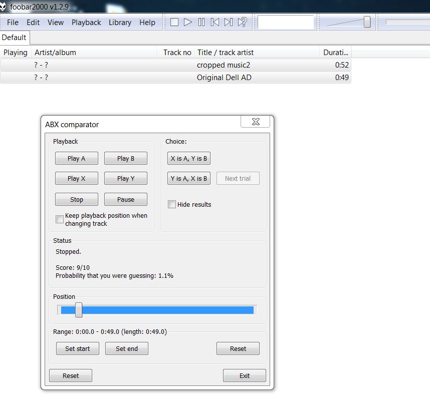

Great ABX result... I might try again on that... its a bit quieter wind and weather wise today 🙂
Tried again at slightly higher volume.
Once you mentioned noise 🙂 I turned the volume up a little. Yes I hear it.
So the hardware is detectable on that basis.
How did the "fidelity" of the track come across to you ? Do you think it is good enough or at least useful to show the sonic differences in circuitry when the AD chain would be common to both samples ? For example one buffer circuit vs another.

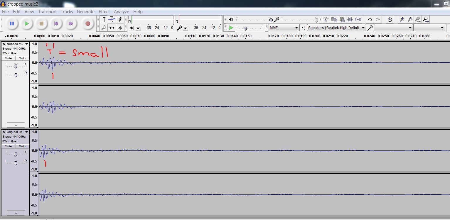

Thanks Pavel. One thing I have noticed is that aligning files in Audacity is not always easy and I seriously wonder if something like "noise" on the AD file accounts for a difference. Sometimes the first part of any identifiable audio on a track can look visibly "different". I have noticed that many times such that I sometimes take a screen shot showing the "cut" point. When I import the comparison file (that's been through the AD) it can appear slightly different at low amplitudes. Noise affecting sample point ?
OK 🙂 Lets try them in Audacity again and see the scale. I find with Audacity that when you drag the cursor to mark a section out and the time counter on the bottom changes to show the start and finish points, such that if you then manually input an end time to equal the time showing on the counter that the cursor jumps forward or back slightly. Maybe because manually dragging gives totally variable position but sometimes it doesn't align with sample points that are usable.
How close in practice do tracks need to be for a reliable ABX result ? Foobar (as I use it) does a sort of "soft mute" as you change from A to B, its not an unnoticed switch as such.

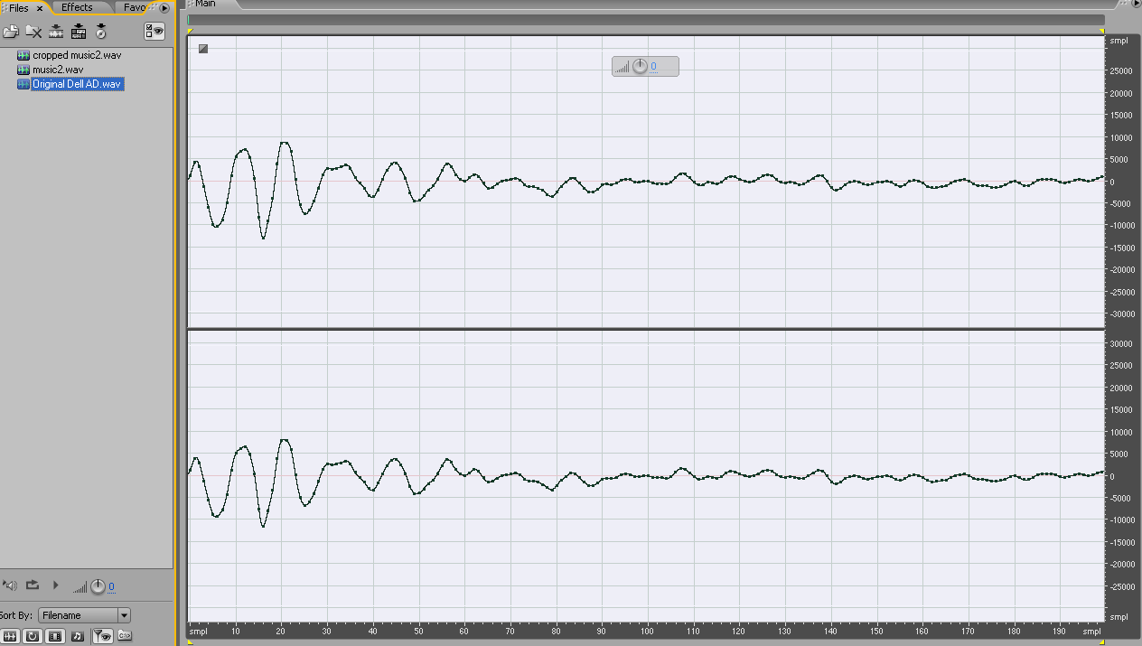

In Audacity, if one is willing to spend a little bit of effort one get get 'perfect' alignment on some aspect, I've done this on other occasions, when I was looking at what DiffMaker couldn't handle, 😀. Quite often I used a process of upsampling to a high enough rate on both samples, until I could achieve precise alignment on a certain bit.
When the playback and record are using different clocks then more usually needs to be done - and of course alignment is usually only possible over a relatively short period because of drift - DiffMaker is hopeless at handling this.

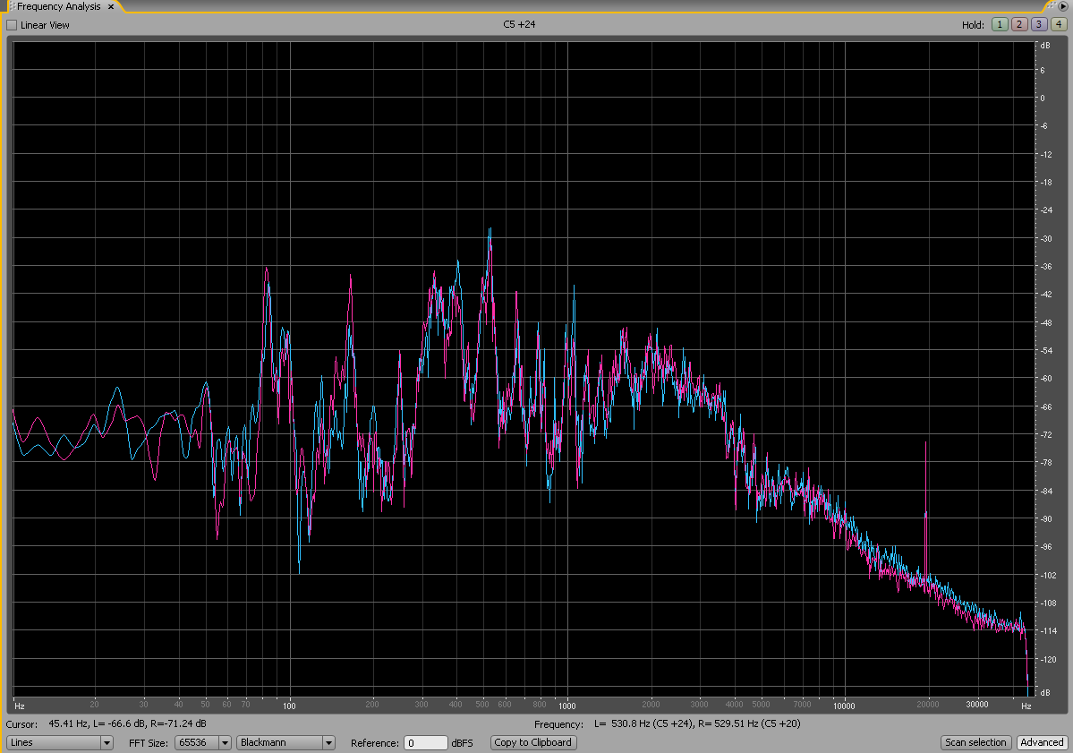

FYI, I have found similar HF spectral line, that you experienced in "Supertramp", in a brand new 96kHz/24bit data that are being sold by a renown recording company ....
The line is close to 19.700 Hz and it is probably an effect of studio "green" lights.
That is strange isn't it, particularly these days when its a studios "day job" to turn out impeccable recordings. They need some audiophiles on the team 😀
The two files that Karl has posted are misaligned in 27 samples, zoom and cut is all one has to do.

It's easy enough in Audacity to zoom to the point of being able to precisely select a single sample. To get the tracks to align I normally zoom in on a part of the track where there is high level, high frequency material, where it's easy to see how many samples are in the misalignment. Then just chop off that number of samples from the beginning of the appropriate track.
🙂 I find it not quite that easy tbh... often because the two files look "different" and Audacity changes the "cut point" when it actually executes the action.

It gets worse. To align start I cropped 26 samples from start of "cropped music2". Moving along in files it doesn't take long for offset to reappear. Original Dell starts leading. Lead continues to grow, the further along into tracks observation is made. By end of Original Dell, it leads by roughly 71-72 samples. This is due to either samples being dropped, or the D/A and A/D converters running different clocks.
