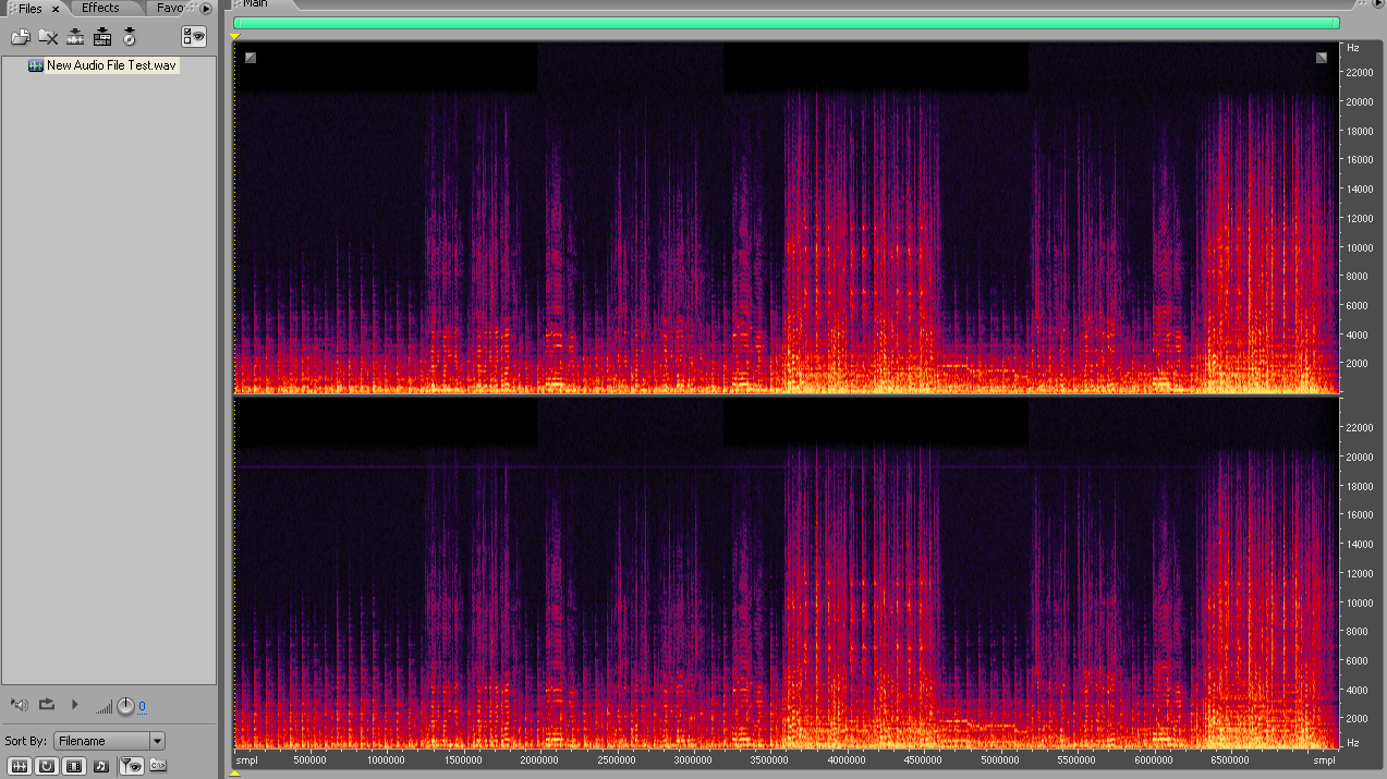

There seems to be an artifact in the audio at 19239 Hz
Thanks for taking a look. OK :) This is what davidsrsb is referring too.
Anything else apparent ?

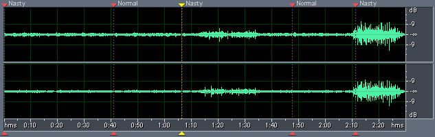

Glad that was helpful.
A little more specific:
In the above, cue points have been added labeled "Nasty" and "Normal"
Track starts out nasty. At 2nd cue point sound is relatively normal. Then goes nasty, normal, nasty to the end.
"Normal" sound is characterized by better low end, less garble smear, and less metallic. Metallic in nasty regions is more than just unmasking by having less low end.
Not at all subtle.

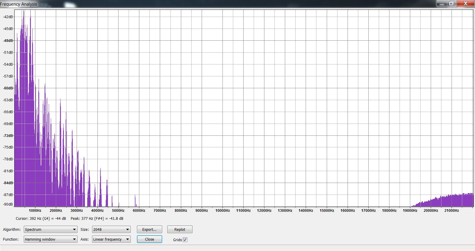

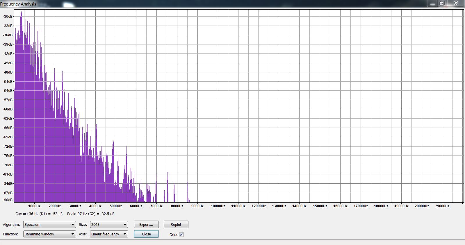

I've run some checks and ripped the test track just now as a check and control on a different PC to try and see what was going on. The 19.2kHz is a puzzle BUT it seems to be present on the original CD.
Here are three spectrums of three different CD's. The third is the one in this test. I can't explain what that artifact is in this case, but it genuinely seems to be present on the original CD. All three CD's were ripped under identical conditions using "Exact Audio Copy" and imported into Audacity to view the spectrum. I have coincidently seen that same effect on my Acer laptop when using it to record via its A/D convertor and that anomaly pointed out to me some weeks ago. That was proved at the time beyond doubt to be an artefact of the Acer. There is no such issue with the Dell used to do the three rips above.
Why there should be a similar line on this particular CD I can not answer.
The good news is that I feel the thread and test is still very valid.
Your comments on the file in post #1 are still needed :)
Not at all subtle.
This is a hugely interesting result :)
Can I just be sure what are meaning. Track starts nasty... OK. How long does that "nasty" last ? You have marked a point around 40 seconds in. Is it OK up to that point or does it start nasty and gradually get better ?
Sorry... I'm just not 100% clear what you meant there :)

One thing I'd point out Mooley, is that your track is apparently 48kHz, which clearly isn't native to the CD it is on. Maybe this is why you're getting a spike at high frequencies, if some processing somewhere is going on.
