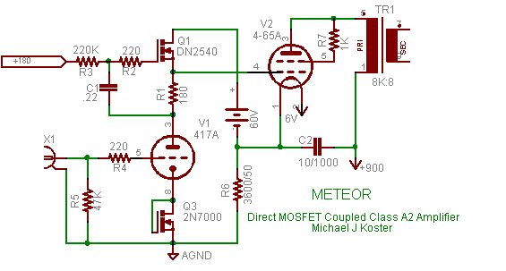

To keep grid current out of the cathode circuit requires that the gyrator supply current be returned to the cathode of the output tube. Here is a SE circuit to illustrate but you could do the same for each side of the P-P driver.
Smoking-amp's suggestion to use a cap returned to the output cathode instead of a whole isolated supply might be perfectly fine if the cap has a chance to recharge between grid current peaks. That's a clever solution that might work well for grid current that only flows during part of the cycle. If you have say a 50mA sine shaped peak that is say 20% duty cycle then you only need to supply on average about 7 or 8 mA over the driver idle current to keep the cap from discharging.
If you do use isolated supplies they can be dead simple because the gyrator filters out the noise and ripple. Mine use a tiny toroid, a bridge rectifier, and a single cap.
I'm planning to convert my 300B P-P class A monoblocks to from choke direct coupled drivers to gyrator direct coupled + A2 using this circuit. I might try the cap approach just to see how it works.
Michael
PS even though the extra grid current is returned to the output cathode, when you drive a tube into class A2 there is somewhat more asymmetry to the load line. IOW, there is more output swing when driving the grid (+) than when driving the grid (-). Your tail CCS will not allow this and force symmetry. There will be somewhat less output power than without the CCS tail and the harmonic signature will be different. But I guess that's what you're going for. It will be interesting to hear about your resullts.

Michael's approach looks excellent. Can use a cheap floating power supply, Gyrator keeps out the noise, and the floating connection to the cathode keeps current out of the "tail".
RE:
"For the CCS to not have to supply the added DC on peaks wouldn't the gyrator have be supplied from "below" the CCS tail through the gyrator. It seems like otherwise the CCS would have to supply the additional current for large crescendos that last over many cycles."
The non-floating pwr supply gyrator version smoothes out the current draw thru the tail to near DC (and being class A mode, it will have to draw enough steady current to cover the peaks pulled from the cap) so the tail CCS just needs up rating to cover it. The gyrator does have a time constant, which will interact with long crescendos, so the floating PS gyrator, like Michael's, is the best way (the long time constant then only affects the voltage on the driver drains then).
