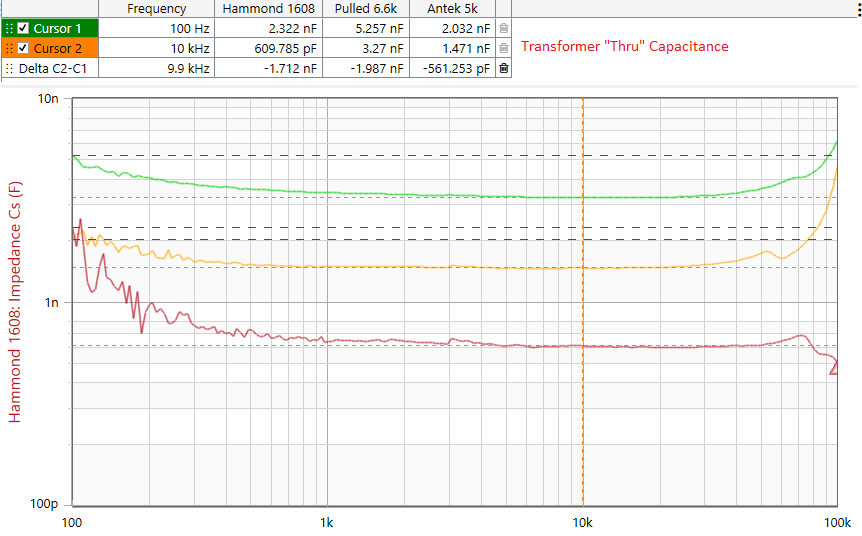

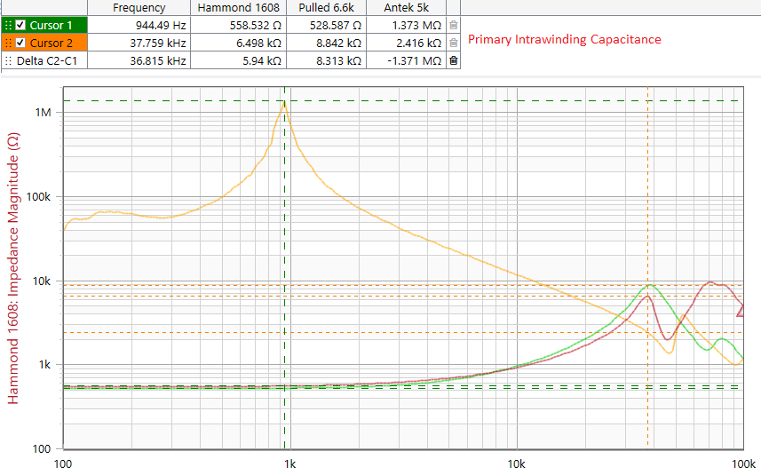

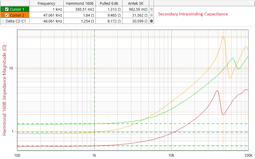

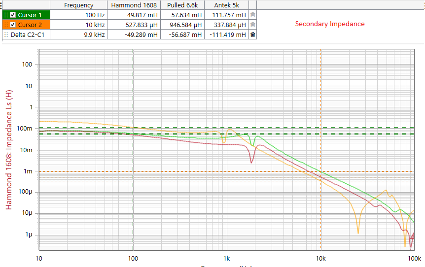

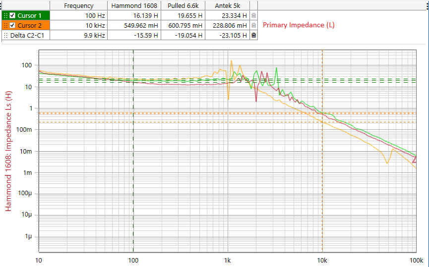

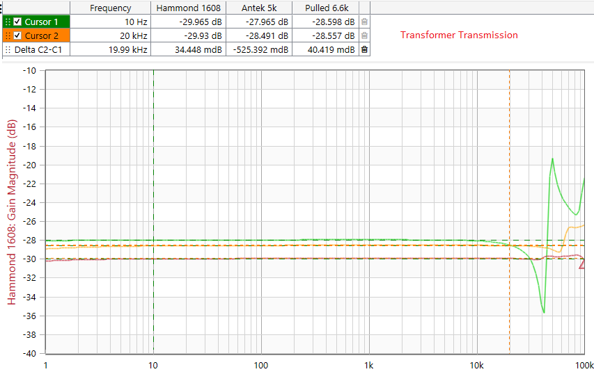

Some transformer measurements. The impedance peaks in the intrawinding measurements are used to calculate the interwinding capacitance.

Just a very quick look at those graphs tells me:
I think some peak frequencies are indeed due to the winding distributed capacitance and / or the interwinding capacitances, versus the primary inductance.
Mid frequency peaks.
I think some peak frequencies are due to the Leakage Inductance, and the capacitances.
High frequency peaks.
Just my opinion from a 5 minute look.

The shape is very good; the thd stay under 0,1 % from 40 Hz to 25 kHz.
On the other test there is a frequency response at same level; at high we can see a trouble around 65 kHz but I consider it reasonable, this is due the parasitic components only.
And this is the trafo only.
I am preparing the test with I bias to know what will happen.
