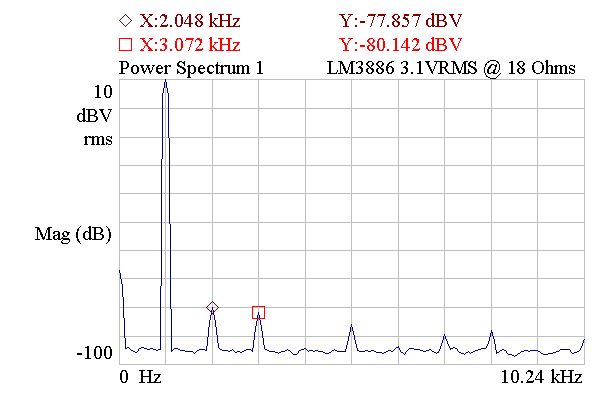

The question remaining unanswered is, what happens when the amp gain is lowered below the recommended 21X (26.4dB) ? Is the amp stable?

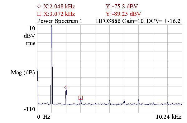

I cut the gain in half on one channel using 20k/2k2 feedback R's for 10X (20dB), and made measurements. No sign of instability on square wave edges. See noise/distortion graphs below showing the amp at 21x and at 10x, same conditions except raising the rails to 16.2V (note different vertical scales...).
At 10X, noise floor (predictably) drops by 5dB across the board. H2 is up by 2dB, but H3 drops by 9dB. Higher harmonics are all down. So yes, I'd say it is worthwhile doing. I'll listen later, and try dropping it a bit more tomorrow.

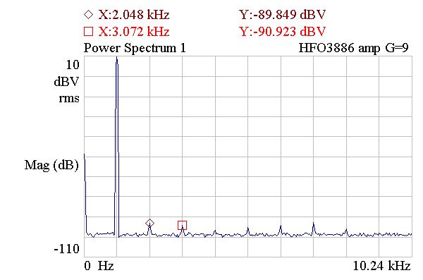

Today I looked into lowering the gain further. In doing so, one consideration is the impedance matching at the amp inputs. With a 10k pot, the + input will see a source ranging from near-zero to 2.5k at the pot's -6dB point. So I think 2.5k is the maximum we would want to use as the feedback shunt R. That results in a gain of 9.
I changed one channel and remeasured. Transient response is still clean, and the amp is still stable. The distortion improved significantly; both H2 and H3 sitting right around -100dBr! I think most of this is due to the impedance matching and not the 1dB drop in gain. Either way, these are excellent results. Should sound great. And it gives a very high bar for the JLH project to reach!

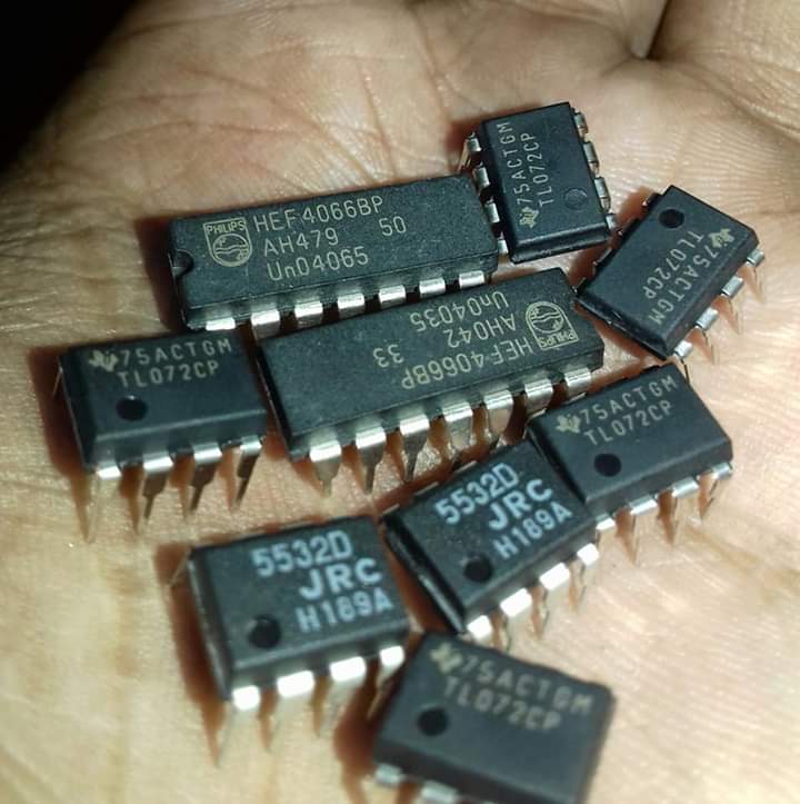

Lm3886 costs Rs250 each(US $3.5) here in kolkata (India). Genuine tl074, tl072, ne5532, 7815/7915, lm317/337 costs Rs10-20 Each (US $0.25). So most of the time i buy from local component dealers(offline). RS components provides excellent service but you have to buy most components in bulk quantities.
