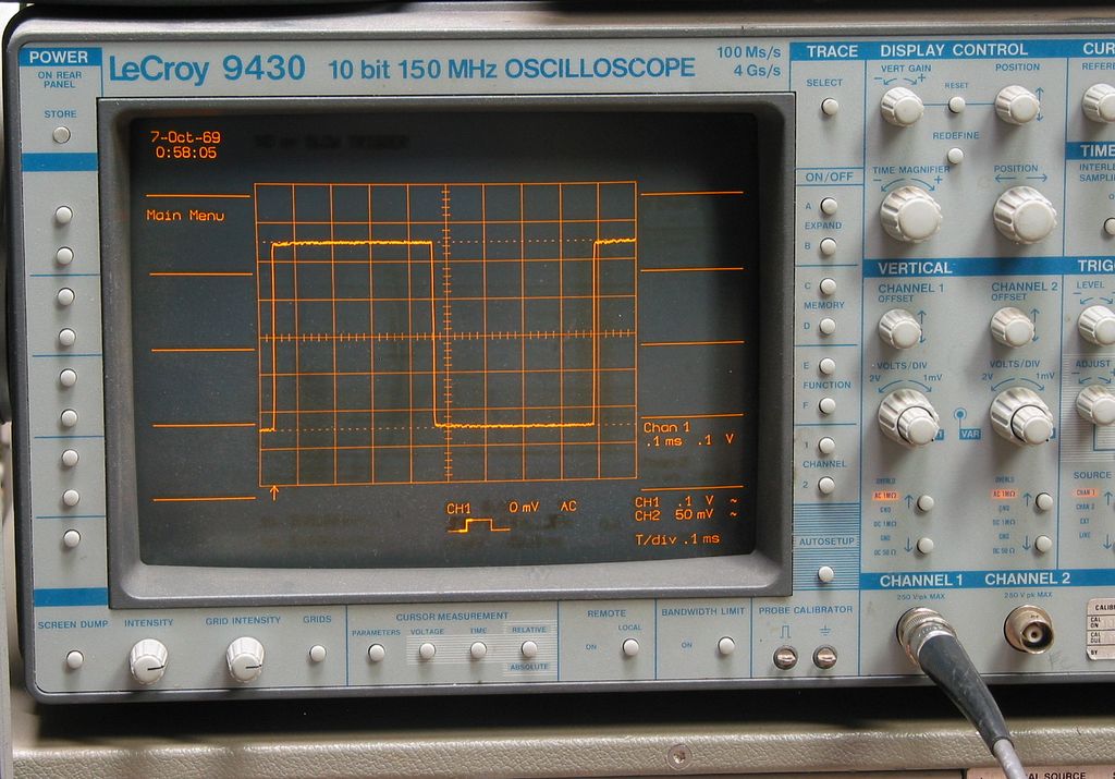

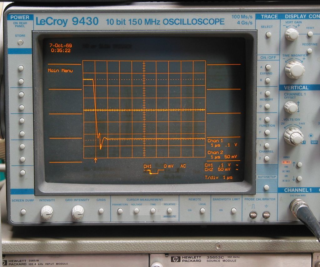

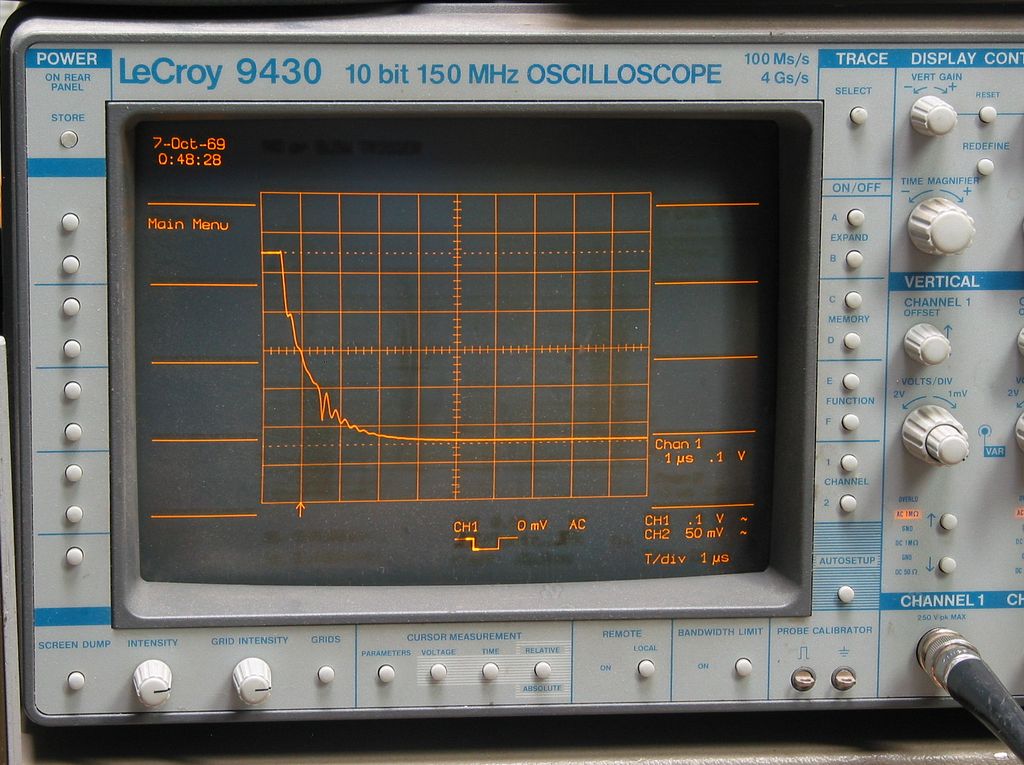

Had a convo on another forum about the "wrinkles" in the LM1875 open-loop gain/phase plot, and decided to look at the 1kHz square wave response. Rising edge is fairly well behaved; falling edge is not. See 1st photo attached. Settling from the falling edge induces two resonances above 1MHz. So I added capacitance across the 6k65 feedback R to compensate. 56pf (425kHz) reduced the overshoot, but left both resonances clearly visible. 100pF (240kHz) cleaned them up better (2nd pic). 3rd pic shows the resulting well-behaved 1kHz sq wave.
Set it up to listen, and for the first time I heard what I could honestly call an enjoyable musical presentation coming from this amp. The edgyness had been significantly reduced! No perfect by any means, but significantly better.

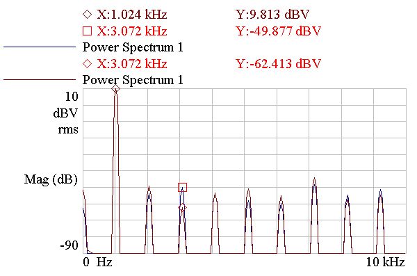

Took it back to the bench and measured the distortion spectra. 3rd harmonic distortion had been lowered by over 12dB just from adding the feedback capacitor! The 4th pic shows the before/after of adding the cap. I don't think I have ever seen anything as dramatic as this. Or as clear a demonstration of the a-musicality of 3rd harmonic distortion.

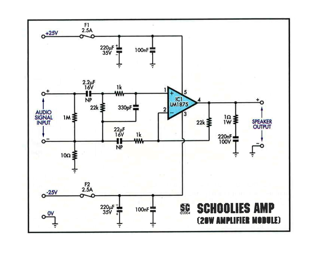

G'day Mate,
Just my 2 cents but the LM1875 is generally considered to be unstable below a gain of 10x.
Av = ( R1 + R2 ) / R2
(6.65+1.21)/1.21 = 6.45x gain.
I suspect if you change to something like 10-12k and 1k for the feedback resistors you might get better results.
This is the standard implementation that is something like a benchmark for LM1875 amps.
Sadface,
That is why I first tested it at 10x (9k / 1k), and got the same results. See distortion spectra in post #19. For this, 6.65 / 1.21 + 1 = 6.5 = 16dB.

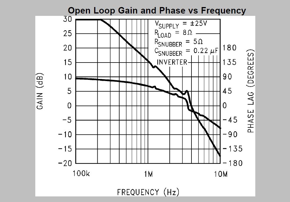

BTW, here is the 1875 (as an inverter) open-loop gain and phase vs freq. plot. At gain of 10X it has about 45º of phase margin. That's probably why they spec it as minimum gain. It's still about 40º at 6.5X.
I have to correct my error, I was reading the gain axis as mag ratio, not dB. At 20dB gain (10x), the phase margin is over 70º. At 10dB (3.15X), phase margin is about 45º.

The plot in post #24 starts at 100 kHz, totally above the hearing range of humans.
So for audio purposes it is irrelevant.
Try using the amp with an analog input source, could be the DAC is giving the wrong spectral output, newer digital sources have all sorts of equaliser presets available, and some you have to set every time you start playback.
My copy of the LM1875 March 1995 issued datasheet by NS, downloaded from DatasheetLib.com, has that exactly same diagram on page 3 of the 8 pages, and the x axis (frequency) starts at 100k, 1M in the middle, and 10M at the end.
Same plot exactly on page 5 of the 7 page datasheet by Unisonic Technologies of Taiwan.
Strange...and please explain the 1M in the middle.
If you say it starts at 1.00 kHz, what is the 1M value for?
You will agree that 1 Mhz signals are above the hearing range of humans.

Even I cannot explain why they put such a plot in what is essentially an audio chip data sheet.

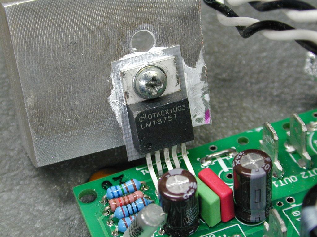

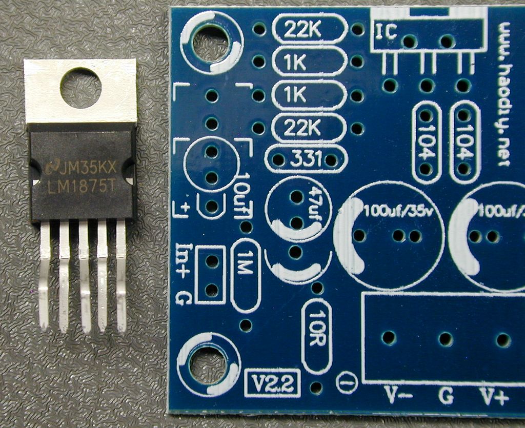

Can you post a picture of the chip?
Attached, see 1st pic. It looks genuine to me.

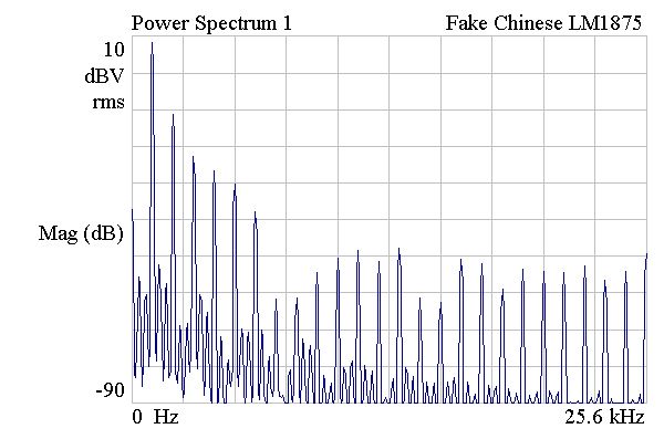

It so happens that two 1875 kits I ordered from China a few weeks ago arrived yesterday, see 2nd pic. This is definitely a fake 1875. I've never seen a TO220 package from TI that looks like this. ST Micro uses it in ALL of theirs, though. I'm guessng this is a 2030(A). I may throw one together and test it just for comparison's sake. I don't see any distortion spectra plots for 2030's anywhere online.

Thsi is what a fake LM1875T looks like
Curiosity got the better of me. I put the just-received obviously-fake LM1875 into my working board and tested it. I have no idea what this thing is, but I doubt it is even a 2030. Distortion was so high that I had to lower the drive level a bit to stop it from overloading the analyzer input. (No, it wasn't oscillating). But even then, absolute cr@p! 2nd harmonic only 20dB down from the fundamental!
Many folks have said "It makes no financial sense to fake such a cheap chip". Well, apparently it does to someone... This thing makes the authentic chip, which I don't particularly like, look pretty good 🙂
