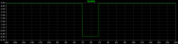

Of course, the DC detect circuit will trip at lower levels too, but a little bit slower: 250ms with 10V / 1.5s with 2.5V. I specified for 50V DC because when the amplifier crash, most likely it will output one of the power rails.
The thresholds are almost symmetrical: +1,7V and -2V.
I tried with a schottky instead of D4 and both tresholds are now 1,7V.

OK - 1.7V in both directions - good 😎

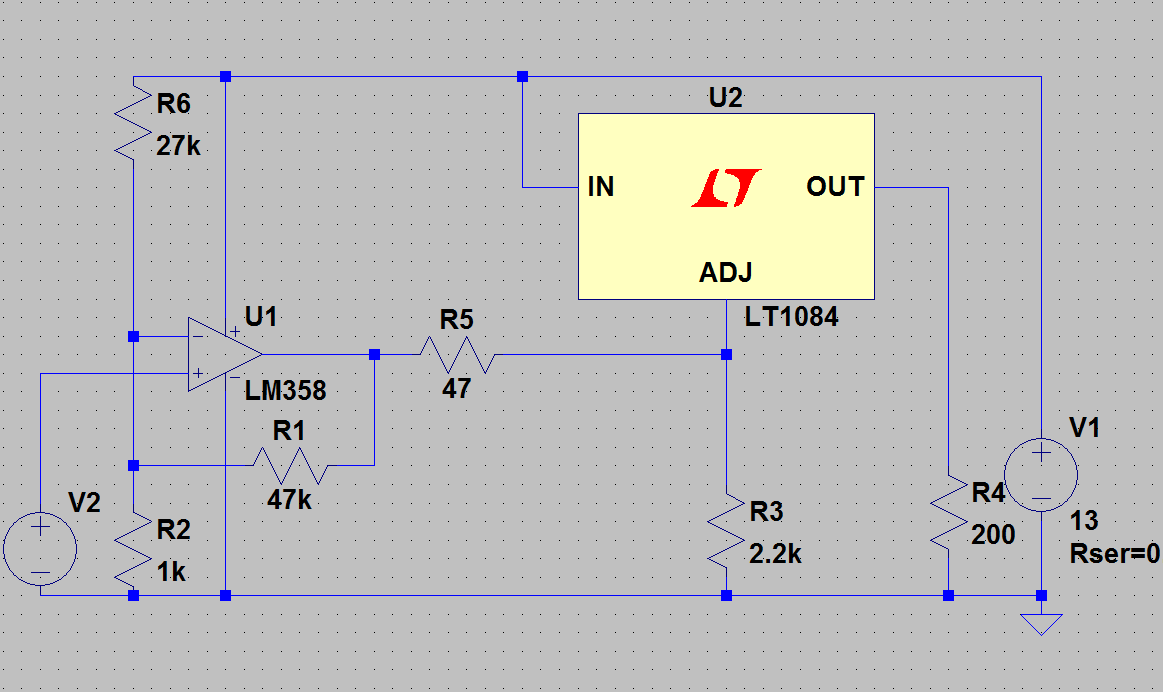

I use the very simple solution from Crest Audio for the variable fan cooling. It's simple, but easy to scale, and reliable.
V2 is the LM35 temperature sensor, and R4 is the fan.
Sajti

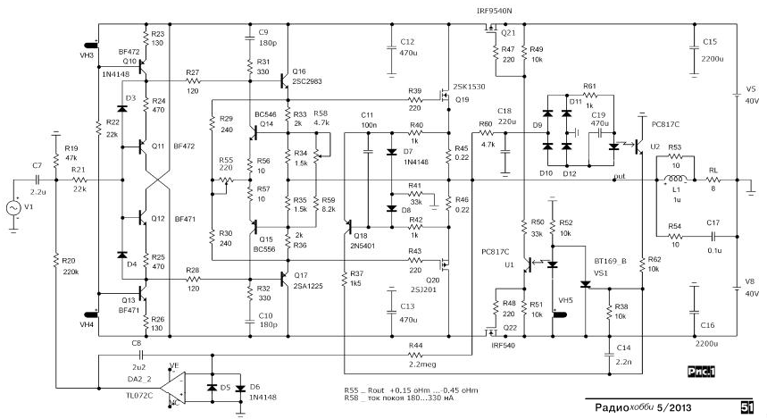

There are many schemes to protect amplifiers from both overload (output current limiters) and short circuits. With illiterate design, such circuits are often a source of distortion. The most effective are trigger protections that turn off the UN (voltage amplifier).
But such circuits do not protect the acoustic systems in case of failure of one of the arms of the output stage. For this purpose, circuits using relays are usually used, which, if chosen incorrectly, can also be a source of additional distortion.
For the attention of radio amateurs, a solution without a relay is offered. Field-effect transistors are used as keys in the power buses, and thyristors are used as triggers for fixing the state of the keys.
