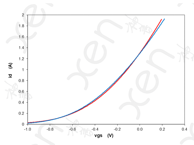

Finally I got one sample of each and curve traced them.
Here is the result.
The NMOS has a Vgs pf 5.5V at 1.3A, and a Yfs of 3S.
The PMOS has a Vgs of 5.2V at 1.3A, and a Yfs of 2.7S.
In the graph below, the Vgs is manually aligned to 0V at 1.3A for ease of comparison.
As this is only one single sample, it is difficult to tell whether the difference is statistical or systematic.
But there is a reasonable chance that even better NP match can be found in a larger batch.
Patrick

This is how well they match if a 0.03R resistor is added to the source of the NMOS.
Of course this is well within the variations of Yfs in a large batch.
That means the chances are that you can find N-P match also in Yfs without this R_source trick.
Patrick

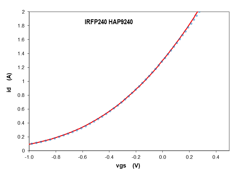

This one I think a lot of people are looking for -- IRFP240 vs Harris 9240.
Almost perfect curve match (you still need to match Vgs).
Red line is NMOS.
You can still get Harris from Rochester, while stock lasts :
Rochester Electronics (en-US)
: Part IRFP9240
MoQ 84 pieces.
More measurements to come. Watch this space.
Patrick

The IRFP240 is from a recent batch at Mouser.
And the exact values are as follows (at 1.3A bias) :
IRFP240 Vgs 4.73V Yfs 2.33S
HA9240 Vgs 4.48V Yfs 2.36S
About 15% less Yfs than the FQA pair in post #1.
Patrick

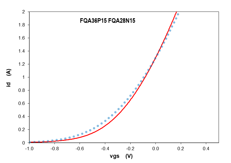

Next on the queue -- FQA36P15 / FQA28N15, as used in Accuphase power amps.
That is after they were forced to switch ti Fairchild.
Degen is 0.04R on NMOS when applicable.
Yfs at 1.3A = 3.37S & 3.79S (raw).
Patrick

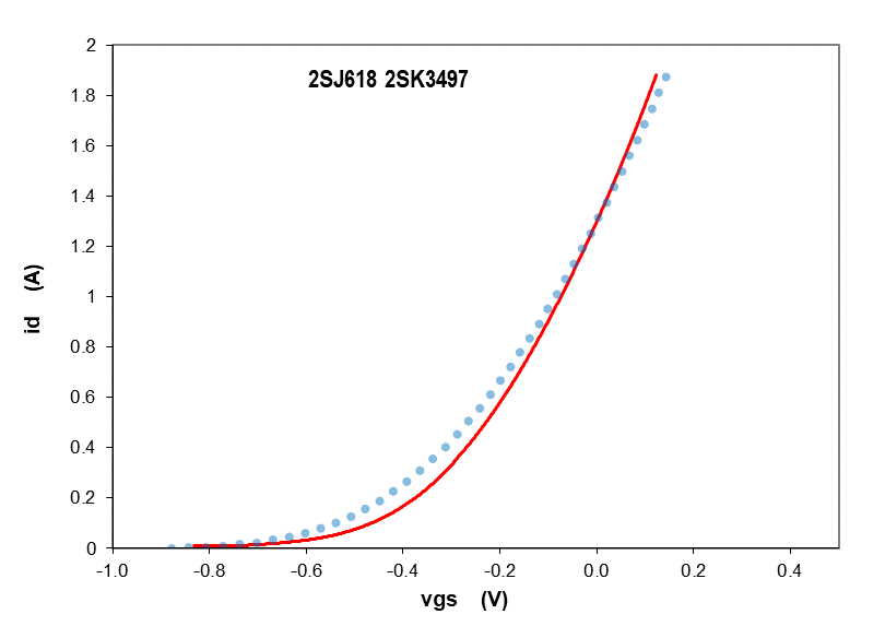

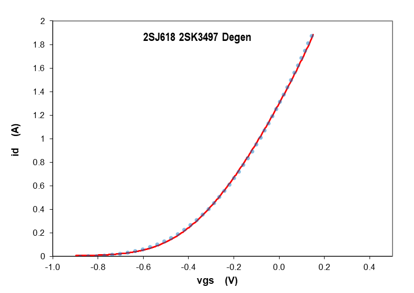

Last but not least, 2SJ618 / 2SK3497 as used in Accuphase power amps before switching to Fairchild.
Simply because the Toshibas became obsolete.
Degen is 0.05R on NMOS when applicable.
Yfs at 1.3A = 3.75S & 4.43S (raw).
Highest of all. Also much lower Vgs at ~2.4V.
Patrick

No degen on PMOS? Isn't input capacitance on FQA36P15 almost double of that FQA28N15?
