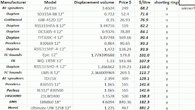

Wow great links, i was going to start a new thread in search for that kind a files so i can import that into excel and do some data manipulation in order to achieve my goal.
My goal for now is in finding most cost effective subwoofer solution, i was entering some data from parts express and similar sites, and get something like this:
It is just a snapshot of my idea and i know is far away from perfect, and more data=more options, but if you narrow your design to the desired box volume, woofer size and left with fewer drivers, this can turn the dial on the scale. Especially considering unability to measure drivers true performance on your own without buying them (i.e. distorsion measurments) so this is rough estimate of driver behaviour connected with price (2*Xmax (or Vc height minus magnetic gap height), times Sd/price) assuming basic linear motor behaviour.
I know that it gets more complicated with shorting rings, mag field linearity manipulaton via mag. circuit geometry design (FEMM), suspension linearity, box type.... but as general idea is it useful?
I will pursue making large excel file to achieve this.
Comments please!
